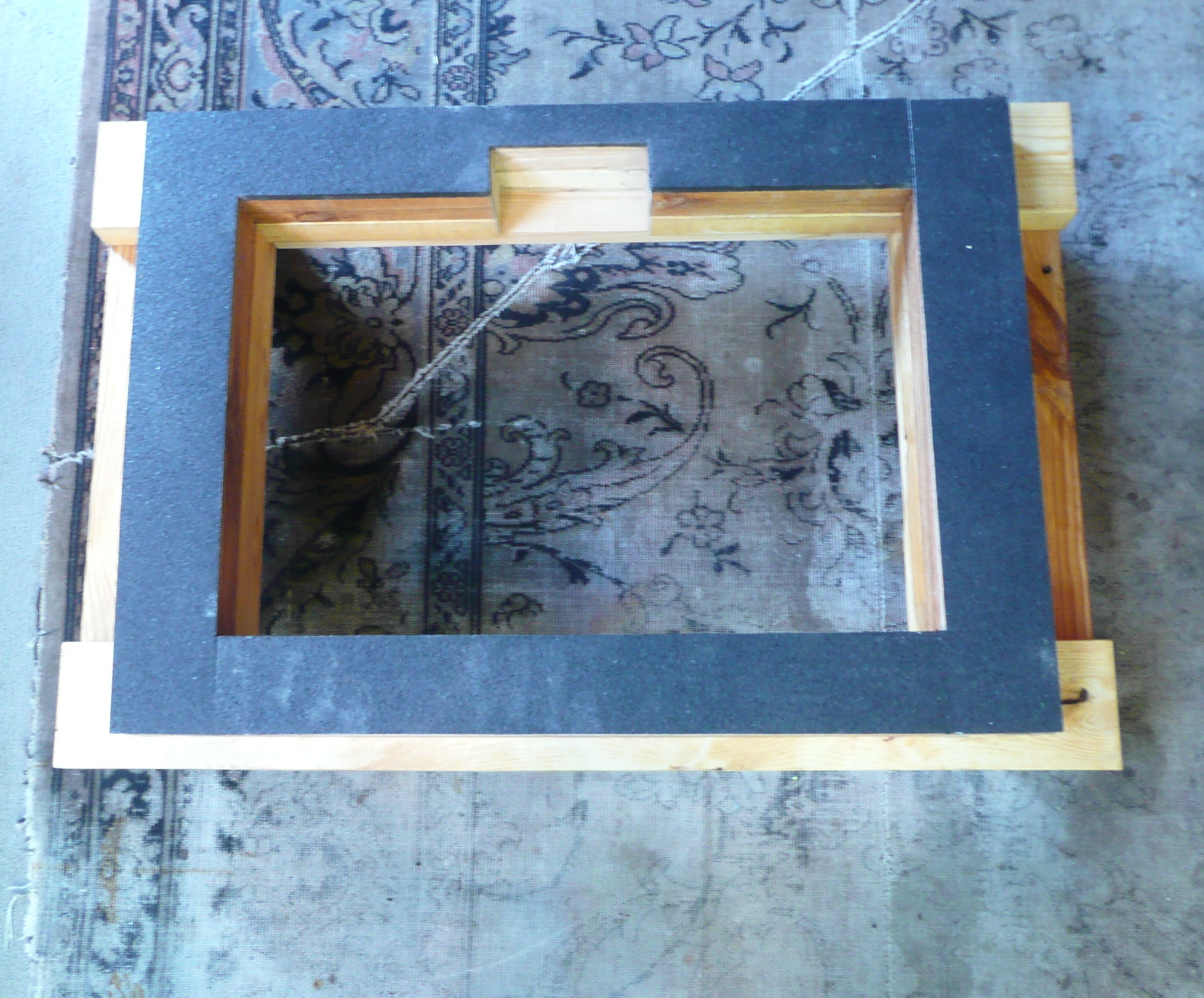

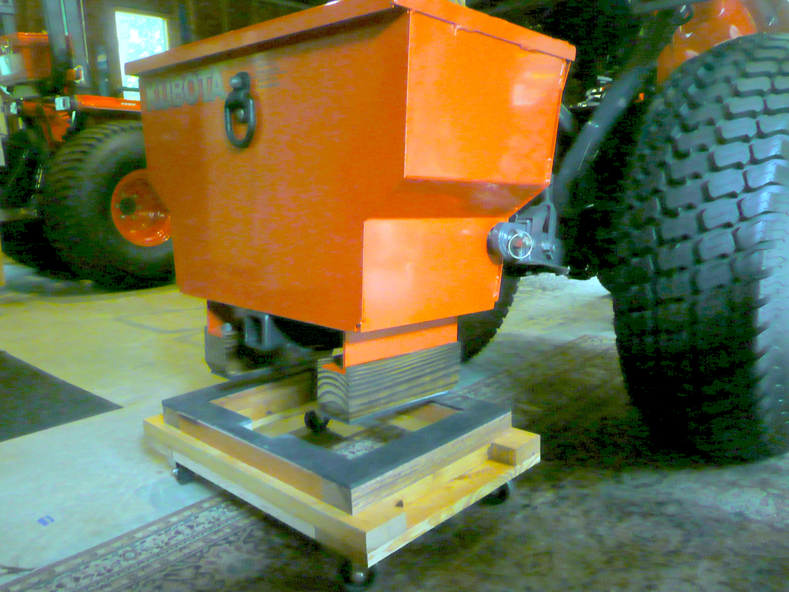

I did the measurements again this morning and found that with the ballast box sitting on the ground, the pins are
approximately 2 1/2" below the lower links in the full down position.
I'm making some PT feet to bolt onto the welded angle iron base, to elevate it. Should work fine.
Thanks for the follow up.
Nice job with your plywood and pvc tubes.
   / Ballast box question

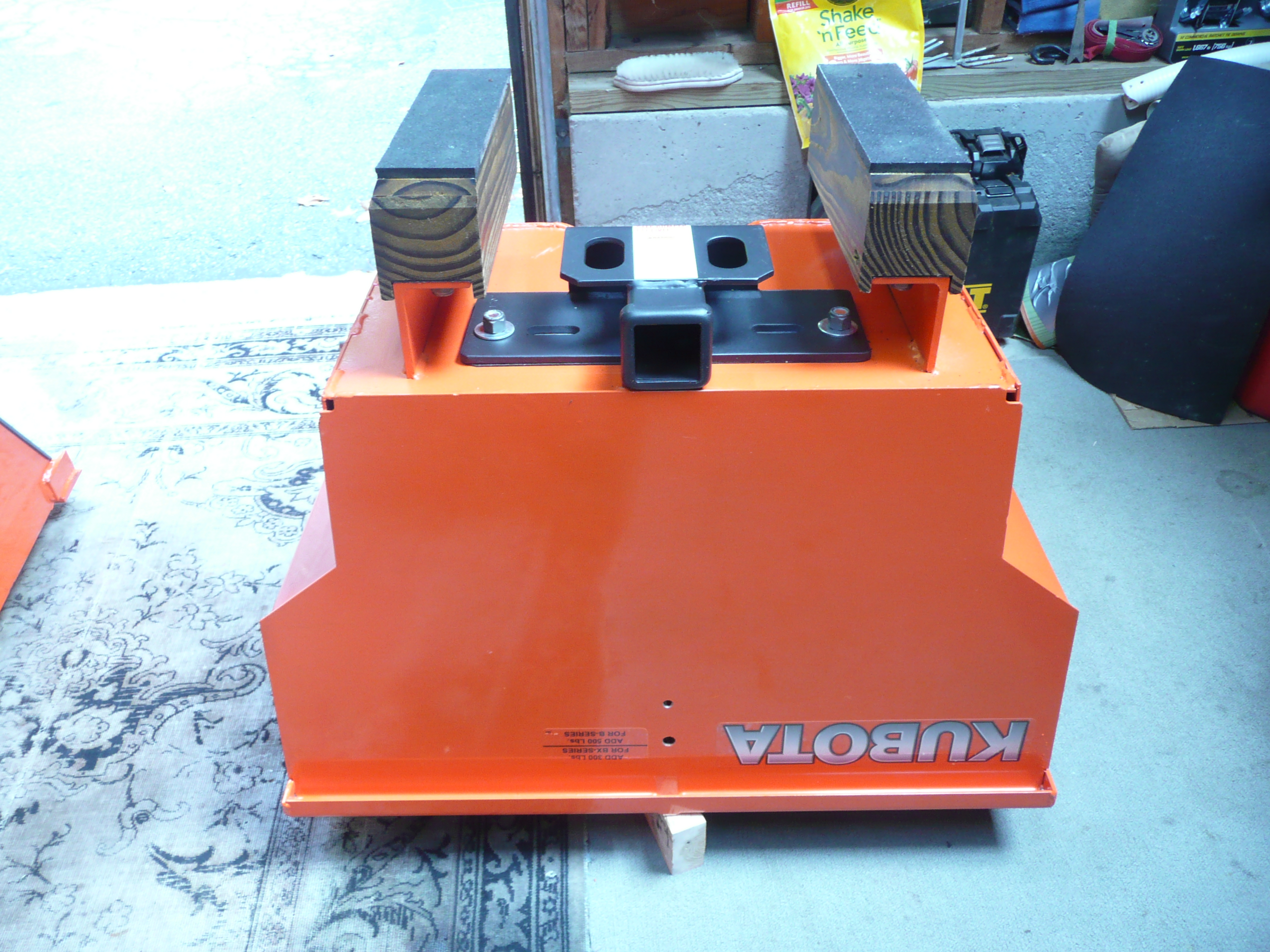

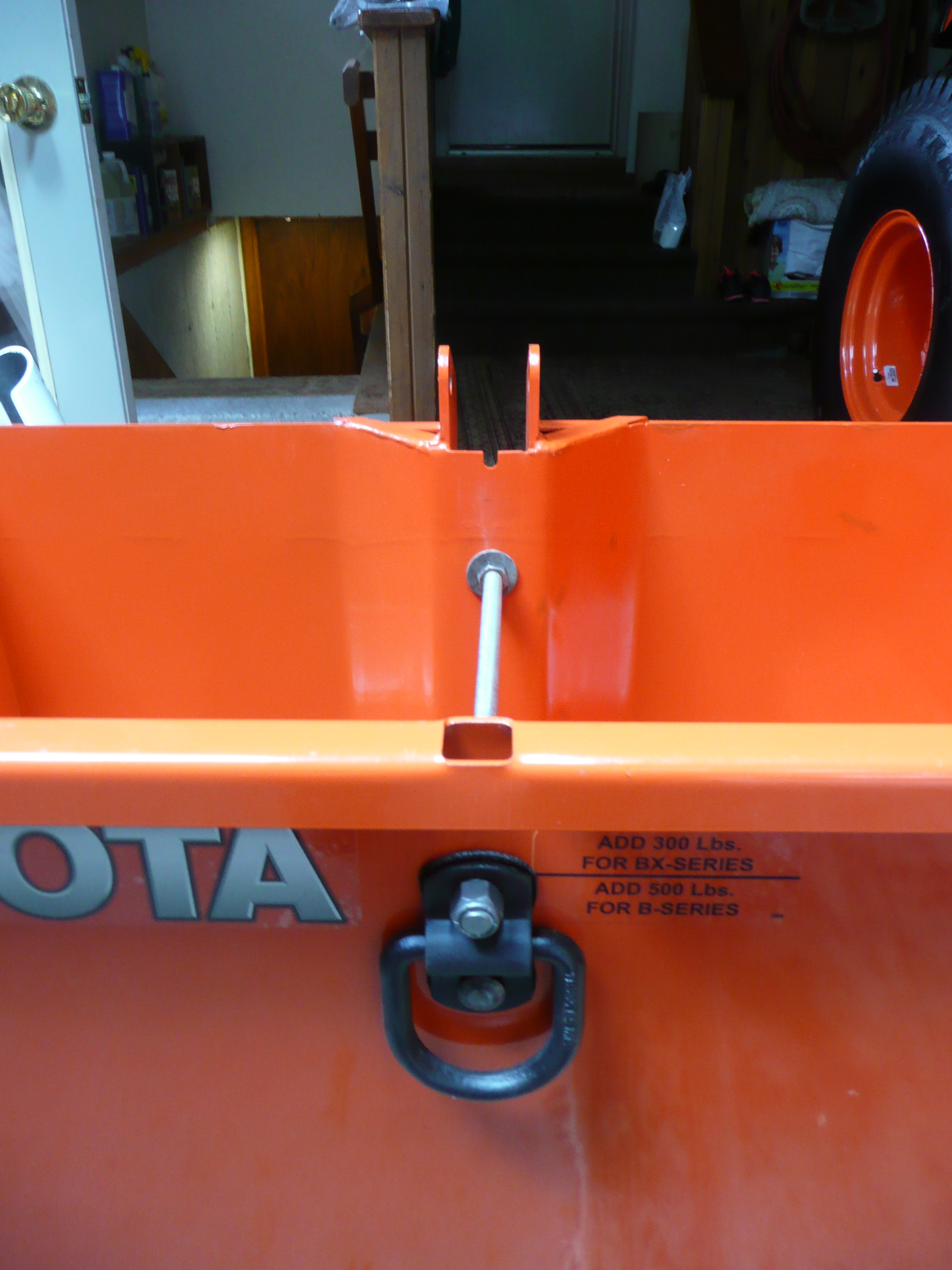

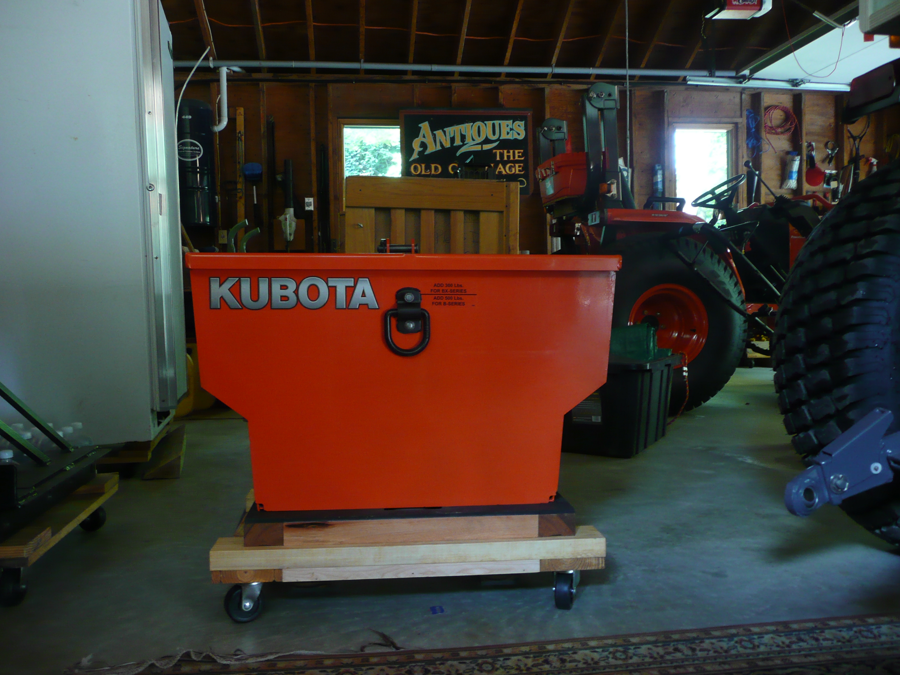

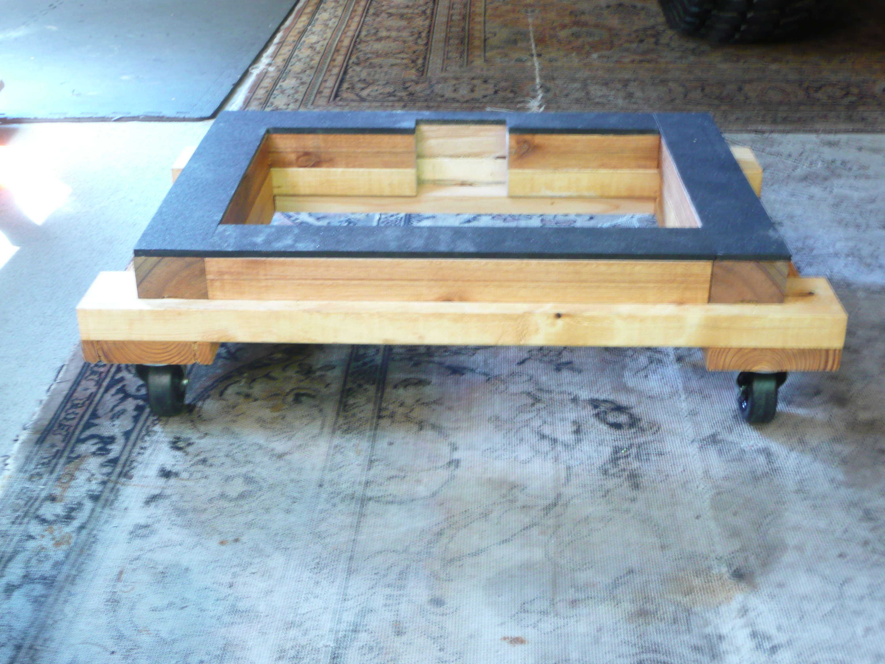

#27
Got to test out the ballast box feet and dolly yesterday, and all went well.
The PT pieces allow the ballast box to be removed without a pallet, and the
dolly fits great for an easy roll away. The champhers on the sides of the feet helped
to put the dolly in the correct position when the box was lowered.

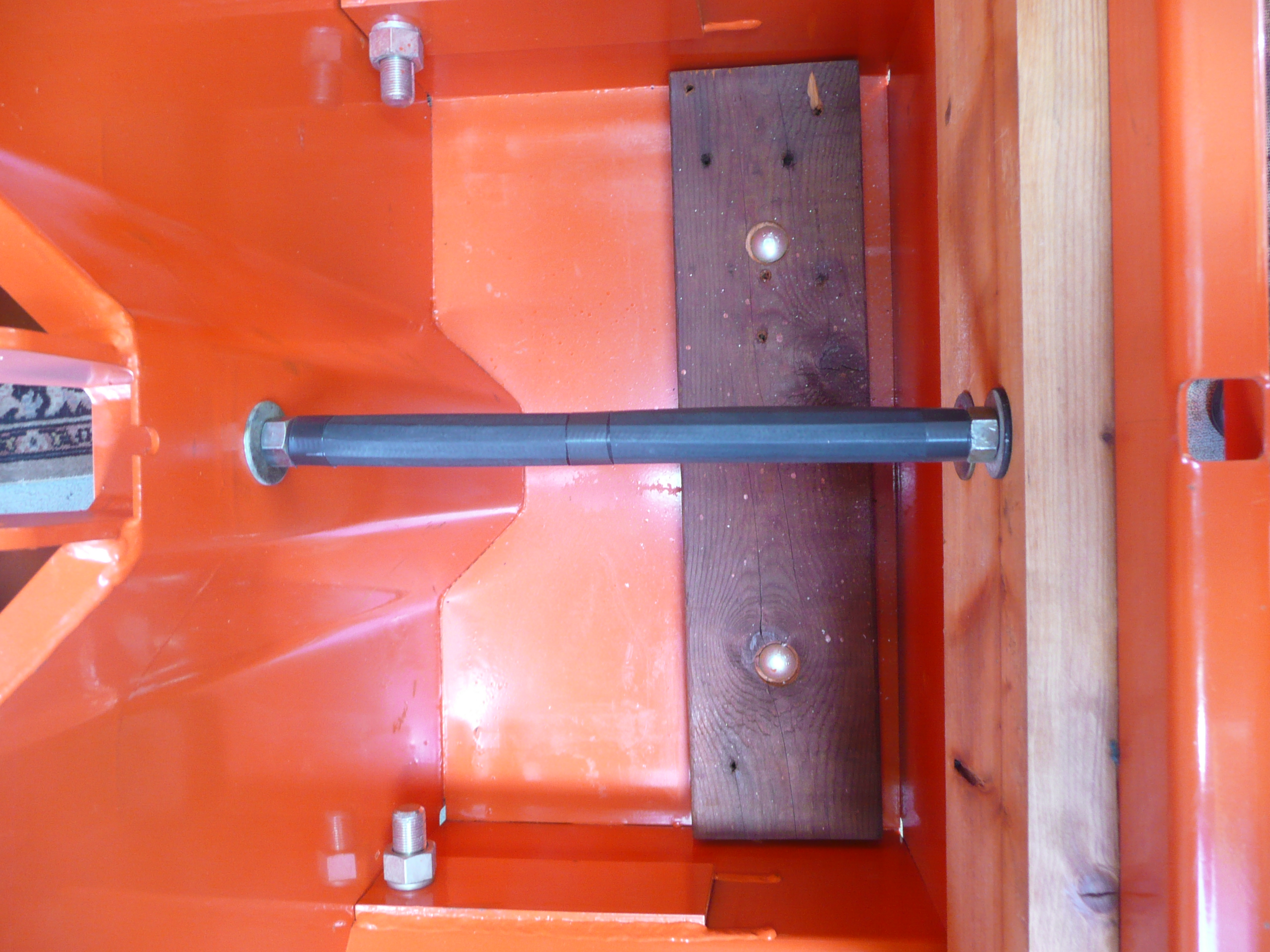

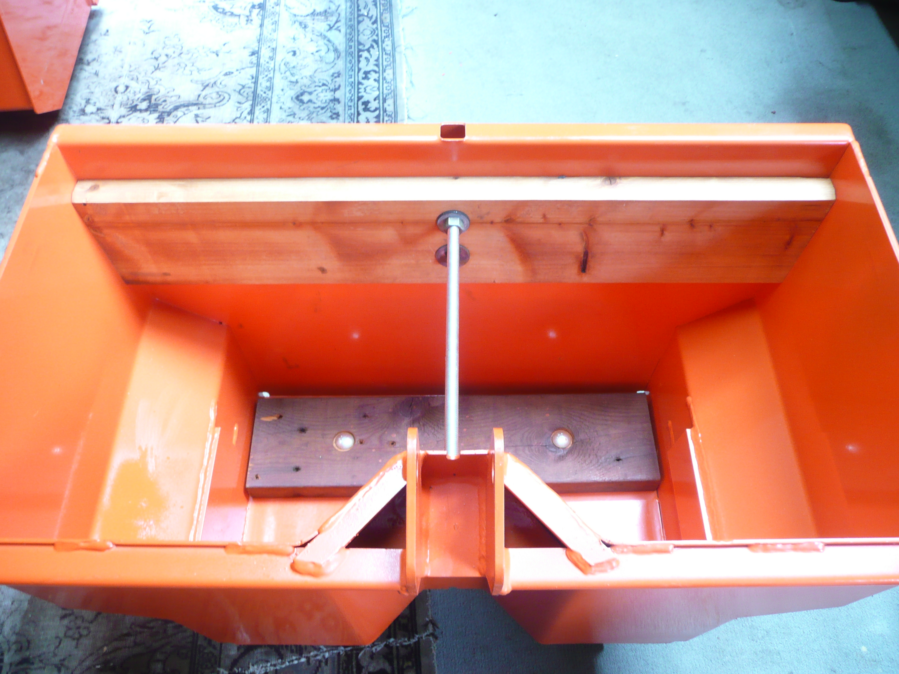

Used 1/2 threaded rod to help add support to the D-ring. the threaded rod is encased
in a section of rubber hose.
Filled with a mix of sand and 1/2" stone. The box, filled to the top, held the 500lbs
as advised by Kubota for the B Series model.
Thinking about making a hitch insert to use as a skid plate when using the D-ring?
P1100333.JPGP1100334.JPGP1100335.JPGP1100336.JPGP1100337.JPGP1100340.JPGP1100341.JPGP1100343.JPG
   / Ballast box question #28
Thanks for posting the photos, nice job! I hadn't thought about adding a D ring but that is a good idea that I think I'll use/modify. Mike
