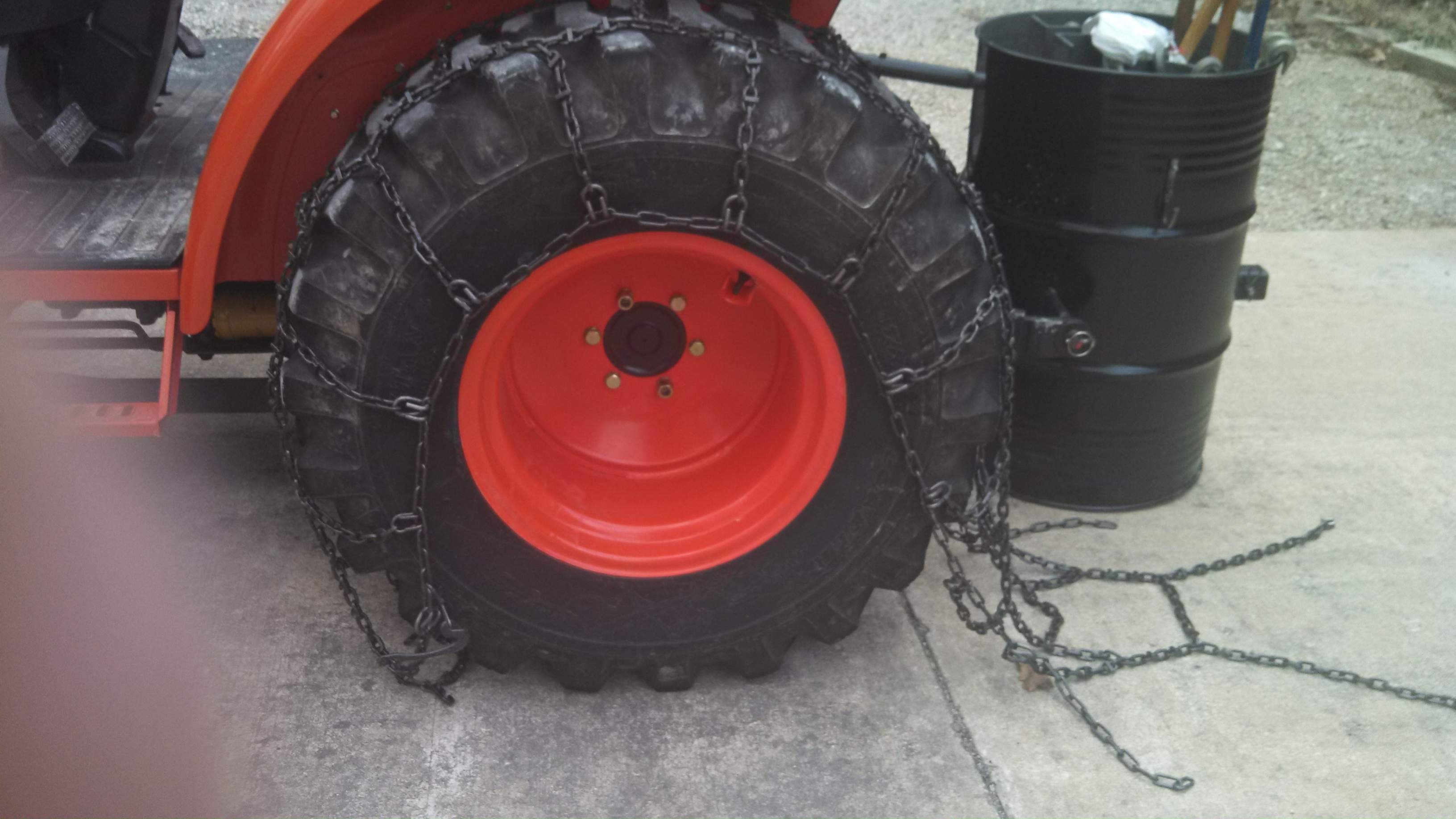

I did it. Works great, but it's not ideal for a couple of reasons - 1. the hitch if pretty far behind the tires, so backing trailers is a little different - but easily enough learned. Also really heavy tongue weights in addition to the ballast weight might make your front end light. 2. I can't see over my ballast (or through it) so hooking up is slightly problematic.
These are super minor so I don't regret doing it at all. Easy and useful.
One thing to consider - if you should tip your ballast box over - do you have a way to grab on to it and right it so that you can hook up again? I managed to do this the other day and it was another small PITA that I might have thought out better during construction.
First order of business...don't tip over the ballast box:)
Installing a D-ring on both sides may help? Can also be used for lifting and skidding, as well.

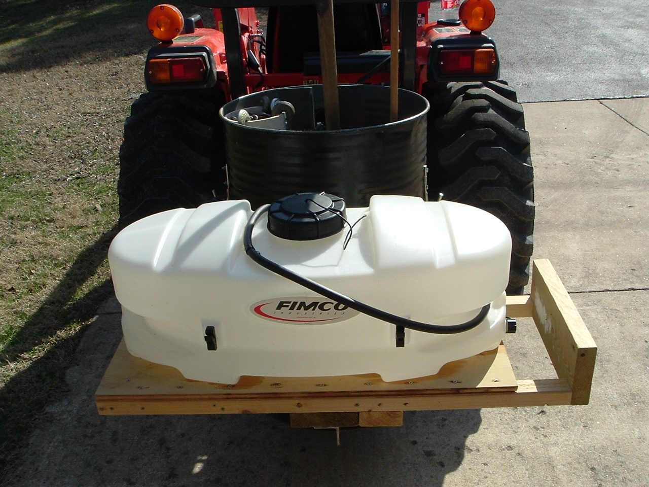

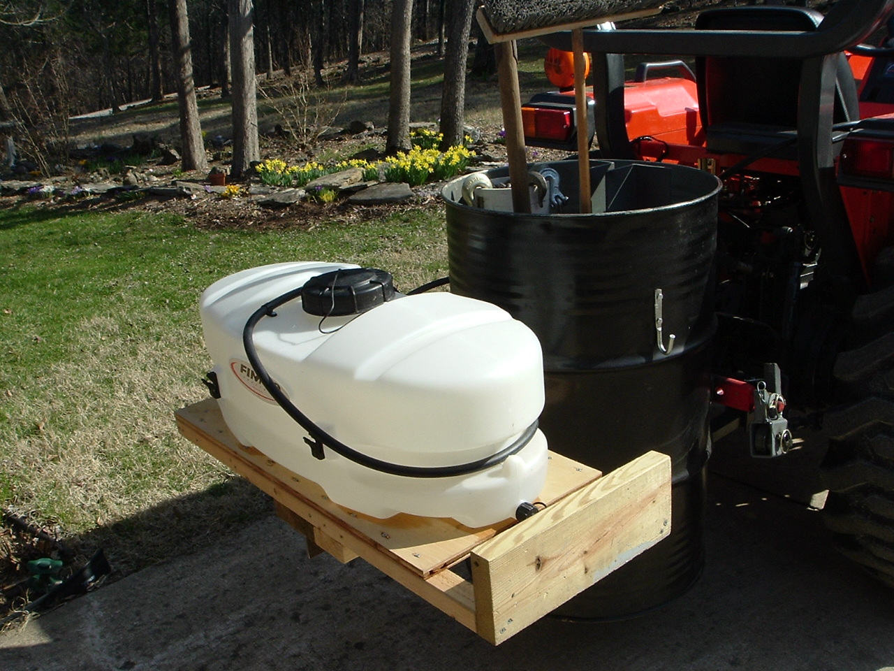

I put a hitch receiver on mine. I have used it several times to carry a sprayer.
   / Ballast box question
#34
Nice idea! I'm going to explore this, thanks.
kOua...would like to see how you made this platform extend out from the receiver. Thanks.
