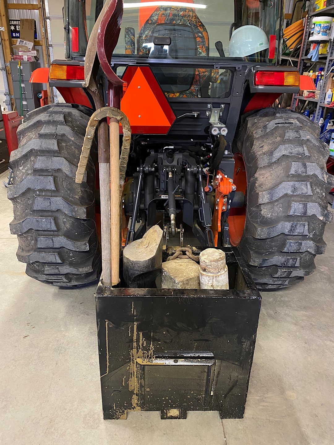

Mine has a sliding door on the back - I'm guessing so you can remove gravel or something? So far I've just stacked in some concrete blocks which seem to give enough stability. There are some variables to answers to your question such as the particular box you select and what you fill it with.

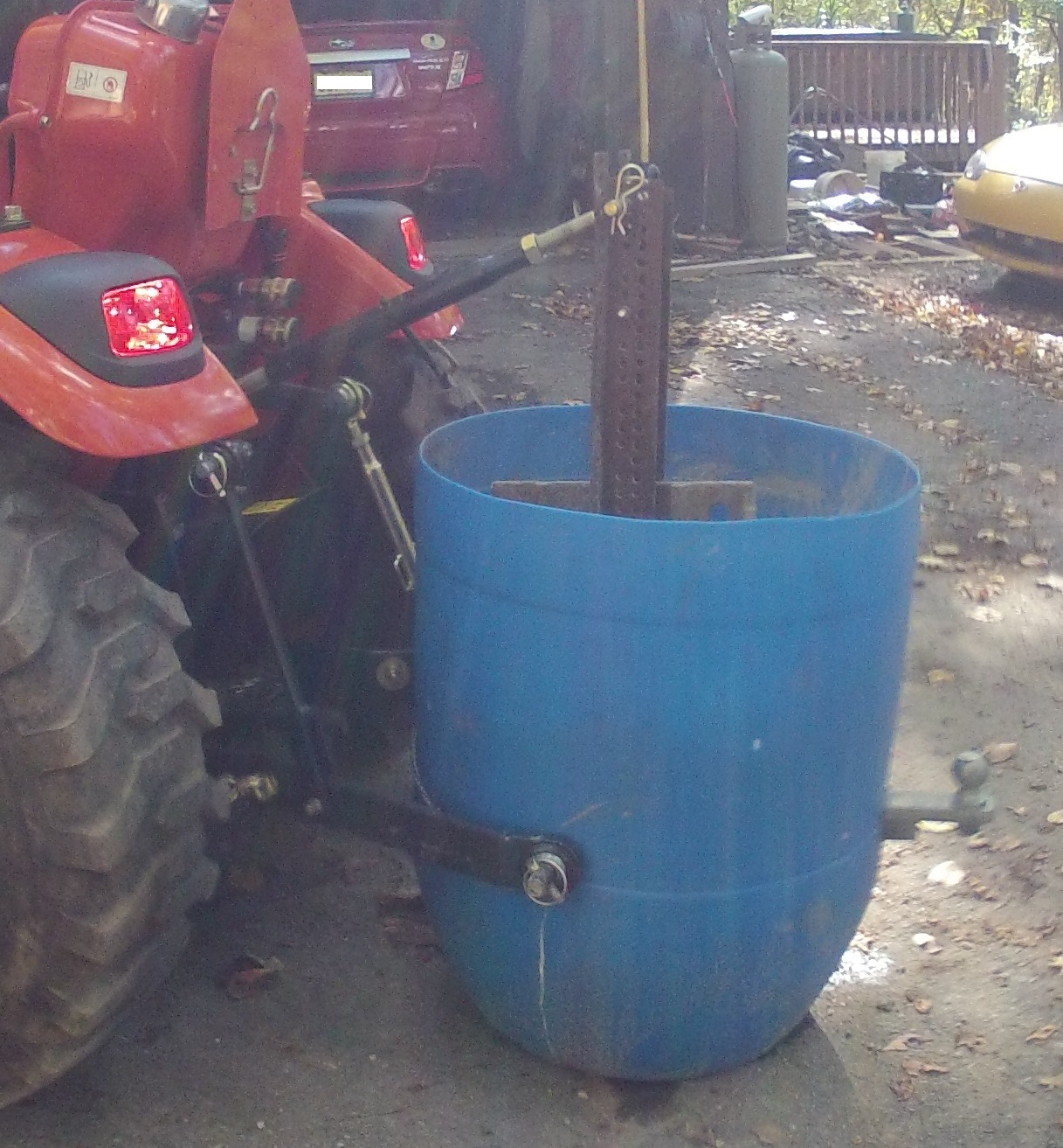

I made mine out of a 55 gal plastic barrel and filled it with stones and some concrete (3-4 bags).

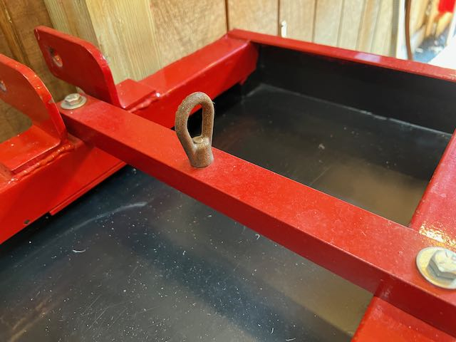

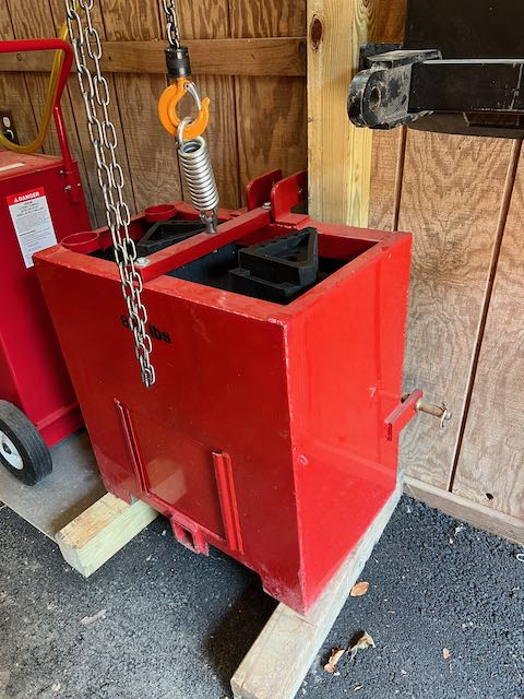

I think I bought the same box you did. I put a couple pieces of 3" steel plate and some old chains and such into it, and poured concrete into the whole thing. The last concrete pour was the self-leveling stuff (which is really great!) after I'd carefully leveled the box. Then I poured a bit of FlexSeal liquid rubber on top and brushed it up the sides inside. I got the box total right up to 800 lbs this way, which is its rated max. I also have a bar across the top with an eye nut for lifting it. I have an I beam trolley and chain hoist above it, and I store it off to the side or trolley it in to mount it. I have an extension spring for lifting it so the hoist doesn't act weird when I trolley it around.

Wow sounds great. Take a pic please.

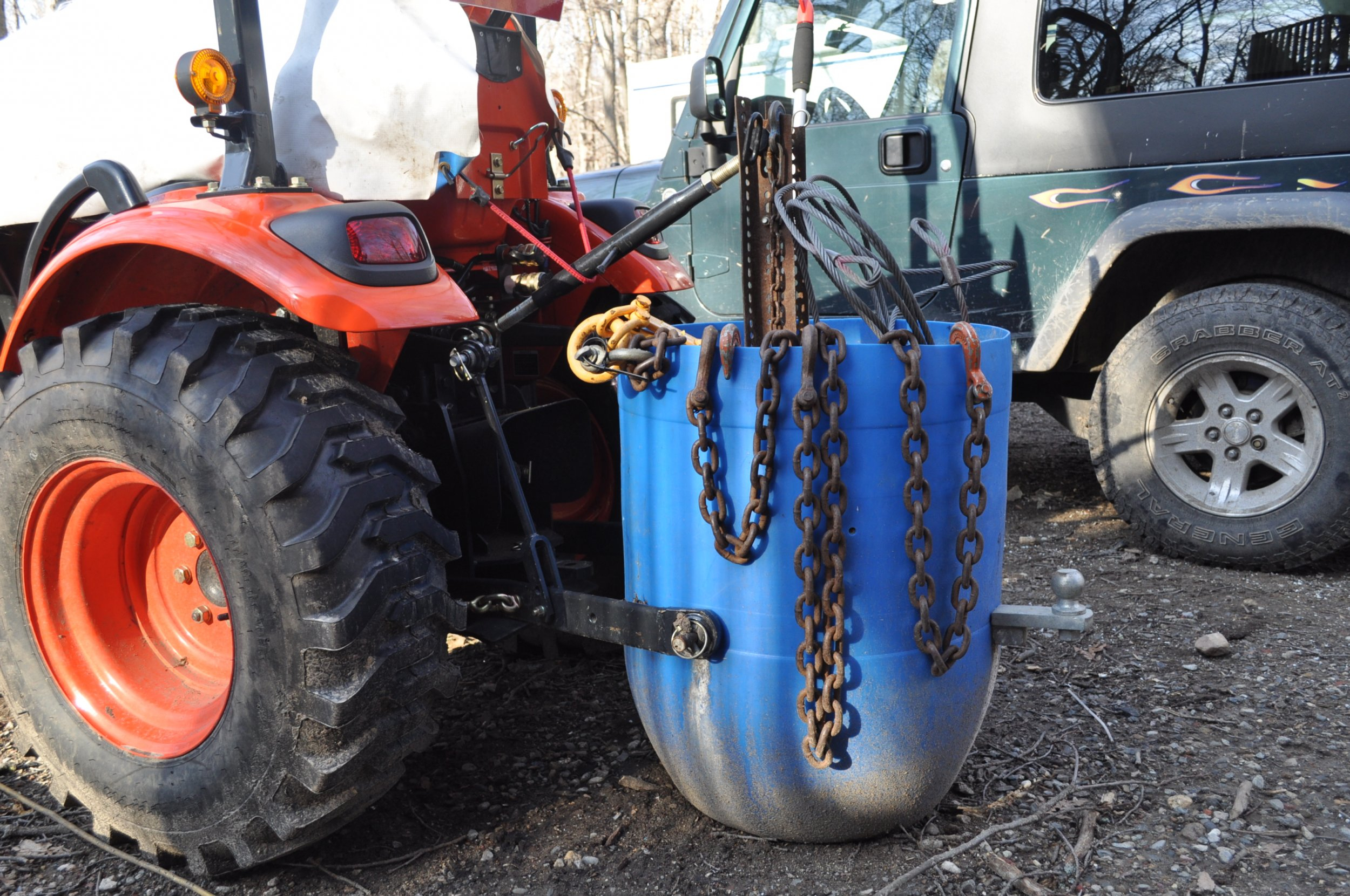

I built mine out of a 60 gallon air compressor tank. Used it maybe twice in 8 years. I just use whatever impliment I have on these days. Much more convenient & I rarely need the smaller footprint.

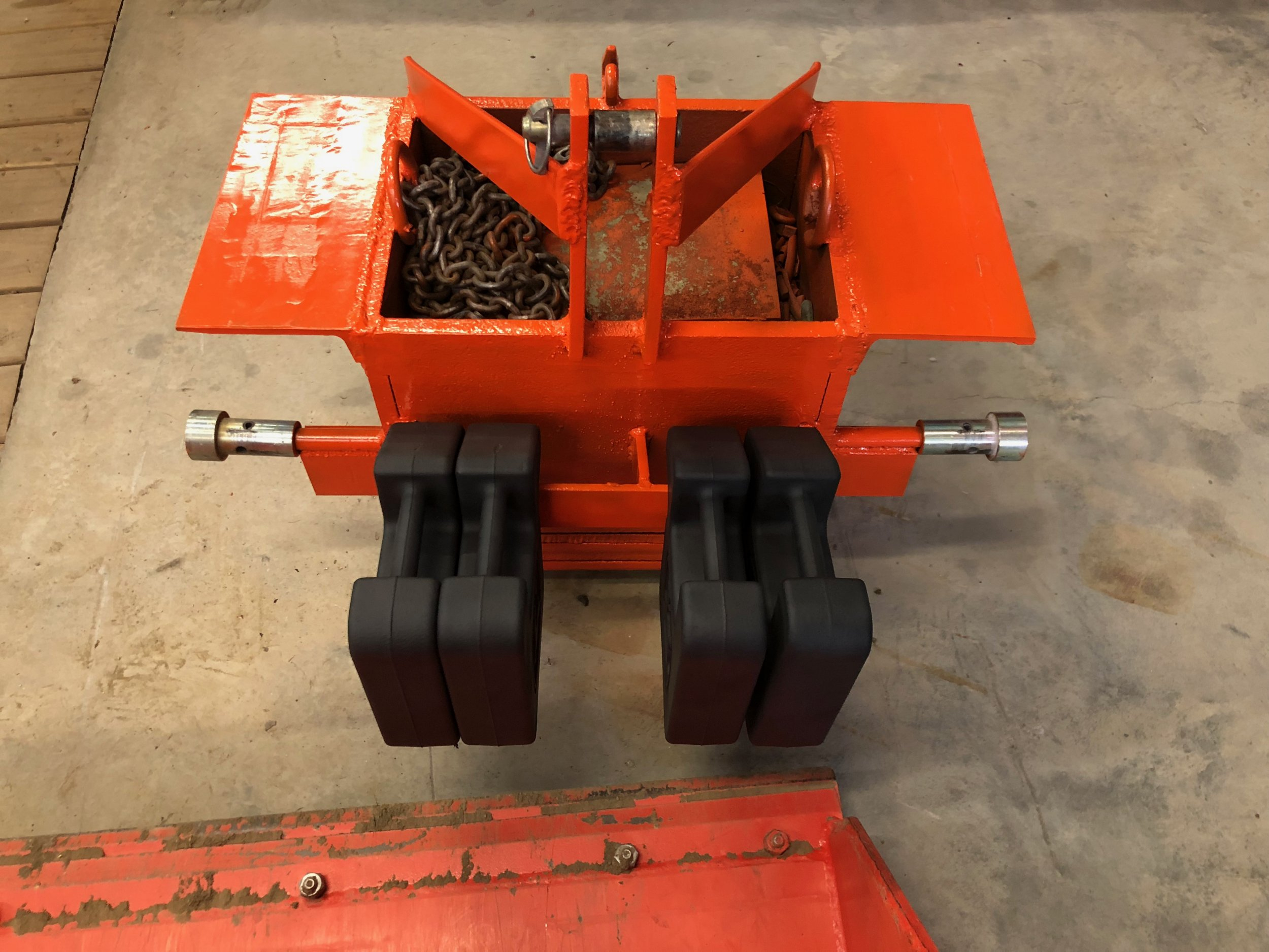

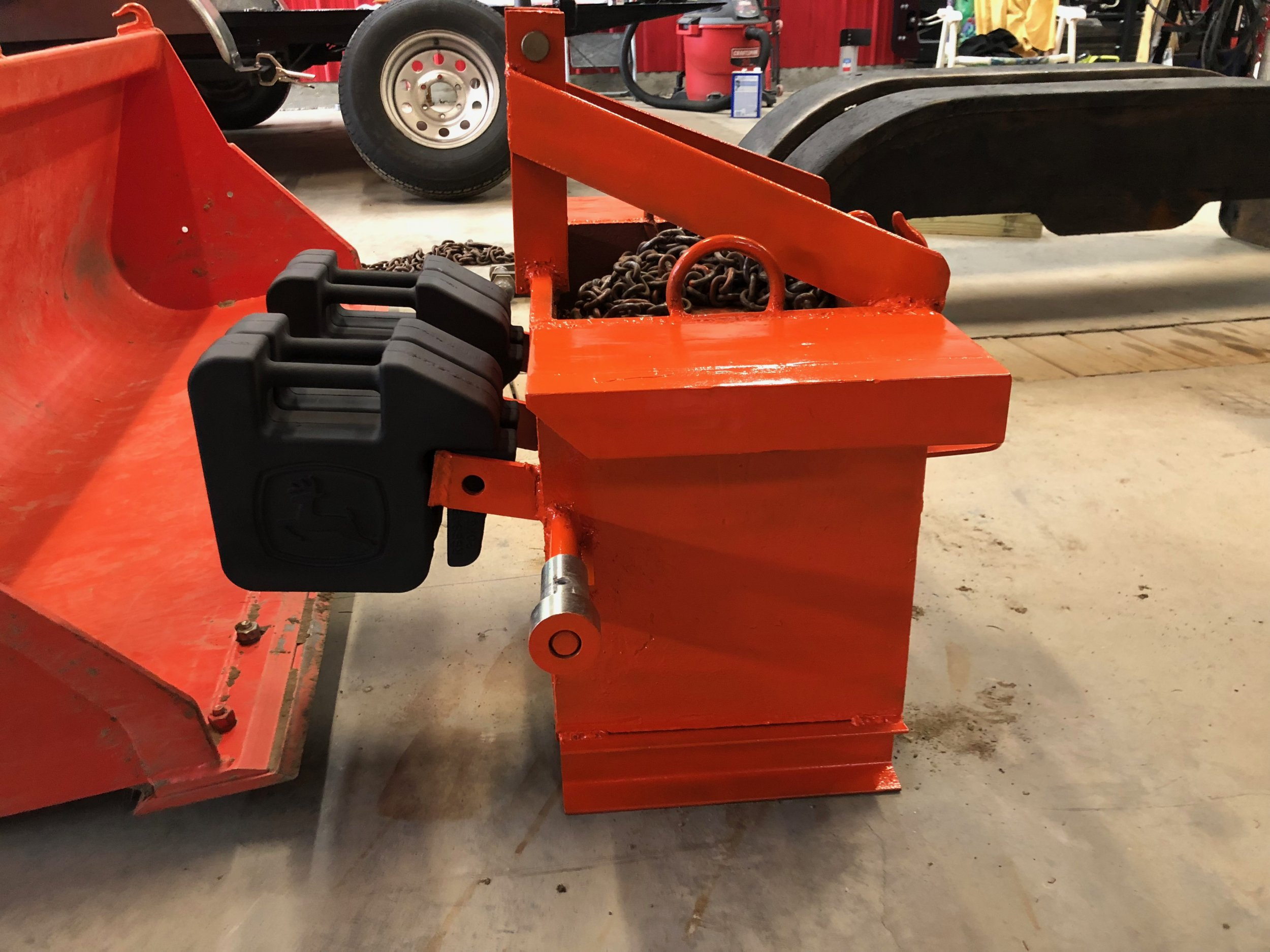

I've had this on 3 tractors now. I keep adding weight as the tractors get bigger. I added a hook to tow logs, etc. The wing plates are so I can pick it up with my forks. Last add was the bracket to add suit case weights. The box is filled with old wheel weights and I keep my favorite chain and 3 trailer ball adapters in the top. You can't see it in the picture but there is a reciever hitch welded to the back that accepts a 2" or 2 5/8" ball for towing trailers.

Here is the ballast box improvement I mentioned a little while ago. It's a common and less expensive standard ballast box, but I filled it with big steel scraps, regular concrete mix, self leveling concrete, and "Flex Seal" pourable rubber, in that order. I kept it shimmed up and level for these last two pours. It's waterproof and won't rust out if it gets rained on. I also added a bar across the top with an eye nut, carefully placed above the center of gravity. It's 800 lbs. I can lift it with my overhead chain hoist and trolley. It's funny moving the trolley because the height of the box has to change suddenly as the angle of the chain changes, which makes the whole setup shake, so I added the spring to smooth that out. I don't have to lift or shift anything heavy to mount and unmount this. I also usually store my wheel chocks in it so they're handy.
