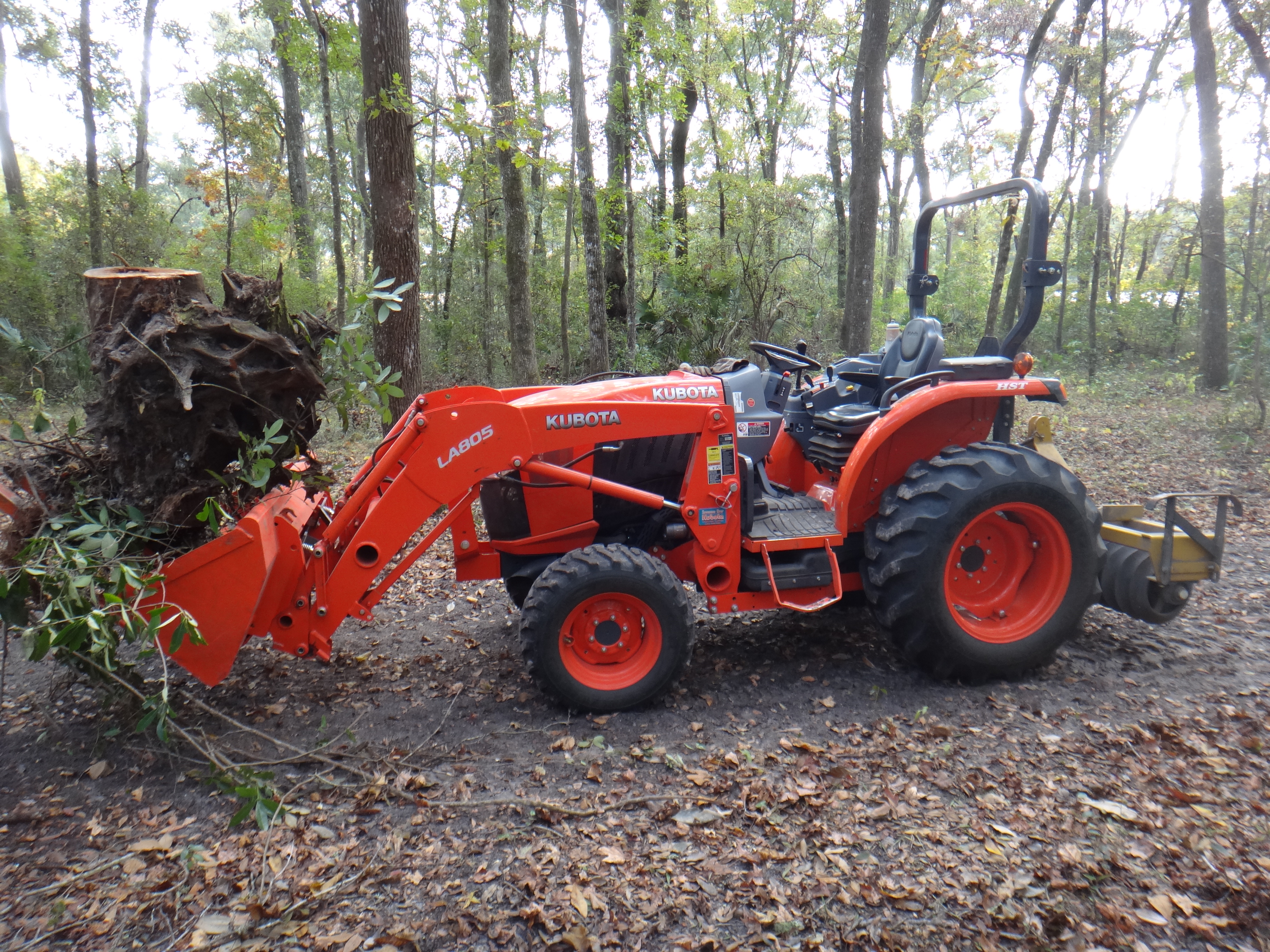

I typically us a 60"/700 pound Cultipacker as everyday, compact ballast behind my L3560. When I have a Box Blade Rotary Cutter or Disc Harrow mounted as ballast they protrude considerably, but protrusion improves their effect as ballast. I have been operating CUTS for years and find my perceptions automatically compensate for protruding implements.
( A 72" Cultipacker is typically 850 pounds, overall width 85".)
(My Cat 1 Monroe Tufline (brand) Disc Harrow, TH971820B, with 20" pans, weighs 915 pounds. A Disc Harrow with 22" pans, 7' width of cut, suitable for an L6060, weighs 1,000 pounds. )
On a one occasion I chained my Ratchet Rake to the rear of the Disc Harrow used as ballast.
Mount what you have, for now.
You do not have to ballast for occasional maximum lifts everyday.

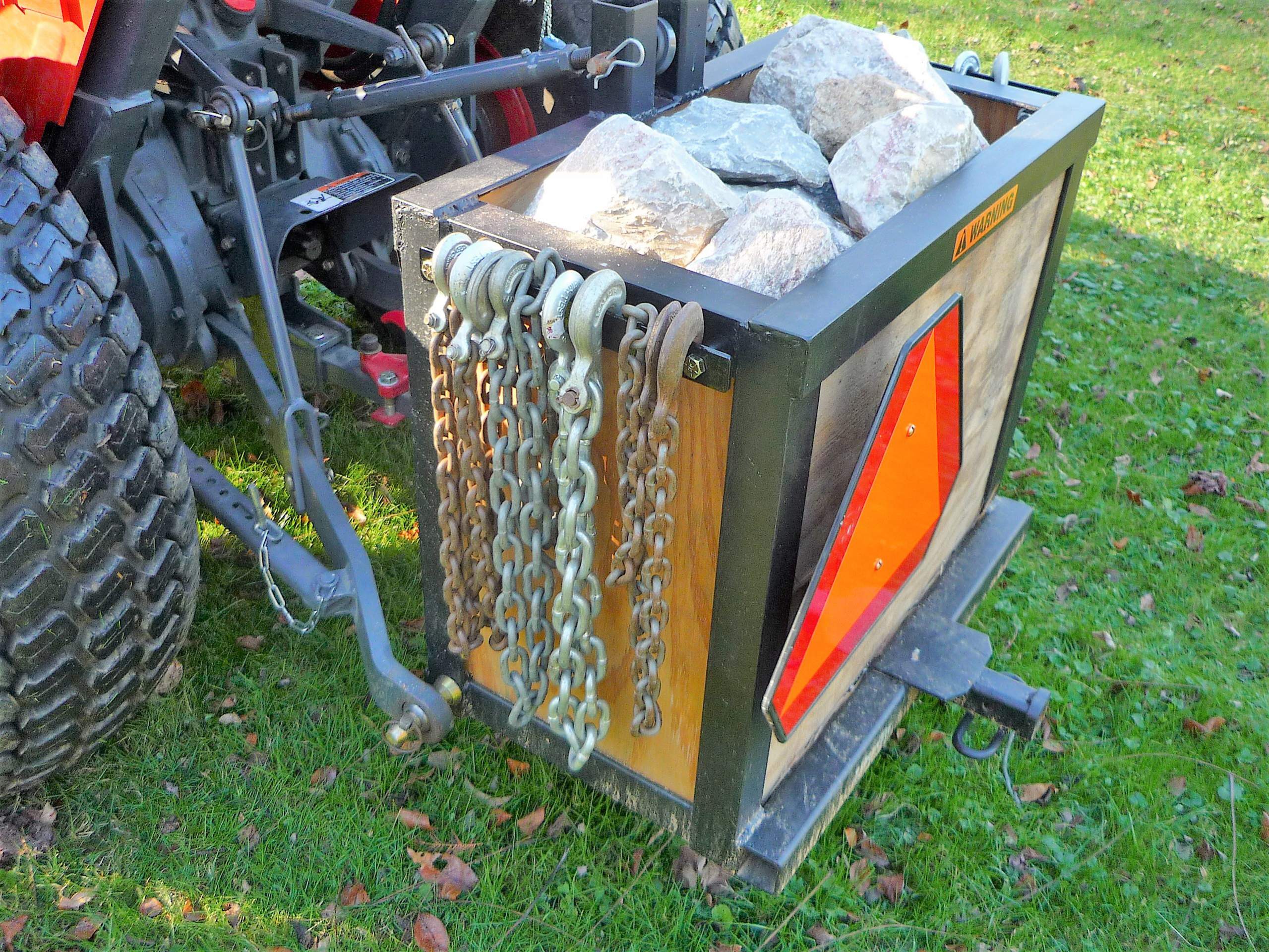

I really liked the idea of a dedicated ballast box for my B2650. I wanted to fab one up that was compact and one that was adjustable for doing tasks like plowing snow with my loader or bucketing material. I welded up a frame and welded on a drawbar. Then I fabbed up the mount for the top link and welded it on. I bought 10 peices of rr track that weigh 100 lbs apeice. With the frame weighing 150 lbs I added 5 rr tracks for a total of 650 lbs. That has been the perfect amount of weight. I can get a full bucket of dirt with my 60 "bucket and the machine stays planted even driving on uneven ground. I have left it at that weight for everything I do. Of course then I had to paint it Kubota orange to match the tractor!
20151130_101654 (450x800).jpg20151129_164129 (450x800).jpg20160112_121243 (450x800).jpg

R Kidd, that's a really nice job you did on your weight box! Mine is somewhat similar, in that the ballast is removable/adjustable... in my case, heavy stones. The trailer hitch comes in handy when I have a firewood trailer to move, and still want the rear weight. The chain rails also are very handy, and add a bit of weight, obviously.
Great job on your ballast box! Nice and compact to get around. Alot of nice features. Looks awesome!!
