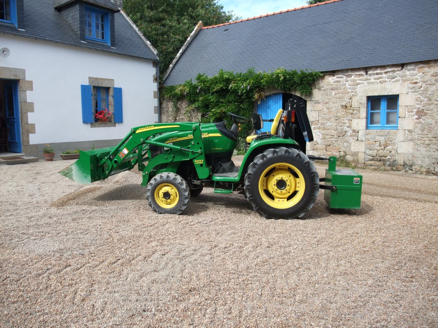

/ Ballast Box #5
I think the JD ballast box is the same for all their CUTs. I have filled mine with mortar and find it a bit heavy for the 3520. I appreciate the 2 plastic tubes I included to carry various tools.

/ Ballast Box #6
A tool caddy would be nice. I've pondered how to add one to the box blade. Or mabye make that I can use it with box blade, mower or 3pt drawbar.
