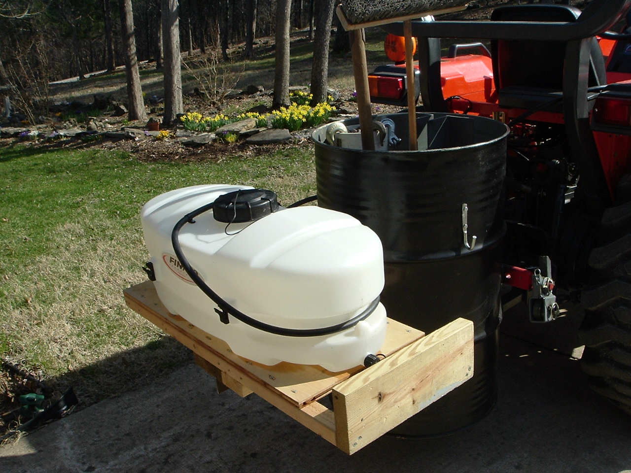

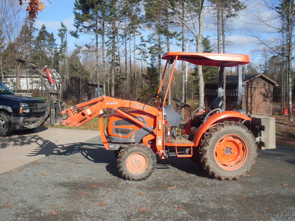

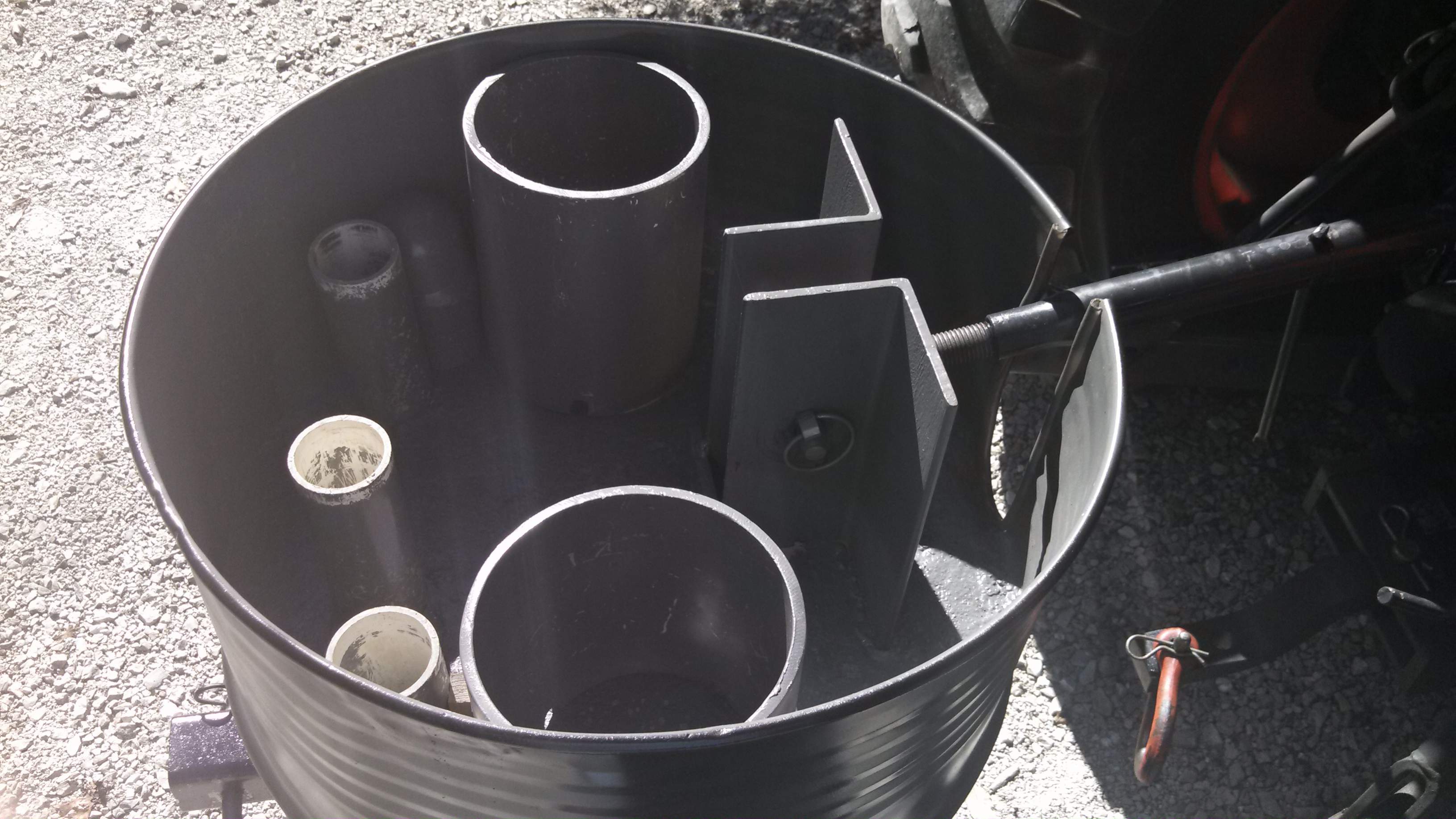

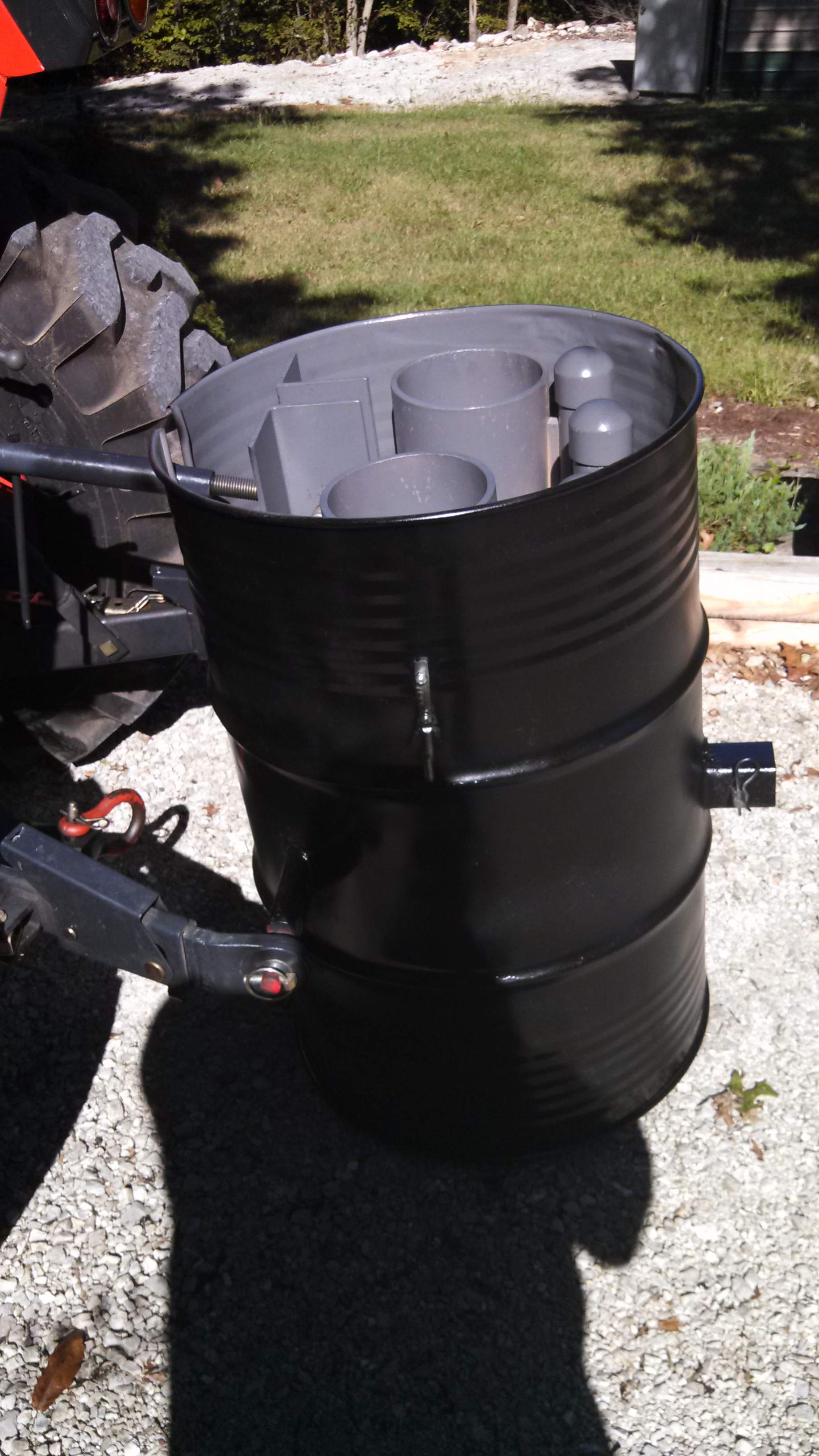

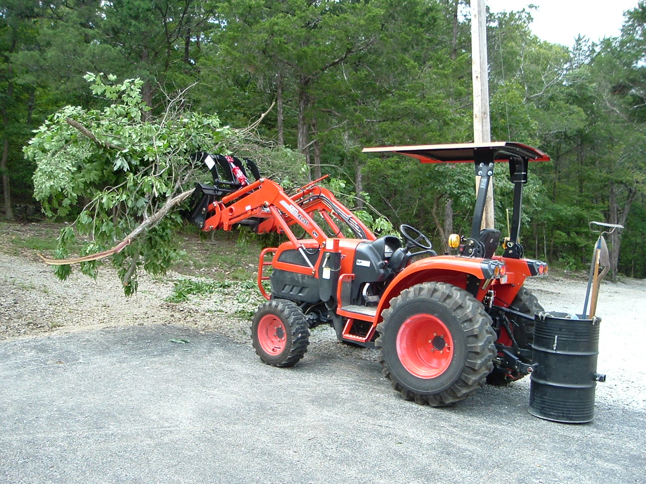

This is mine:
IMG_20130922_150347_801.jpgIMG_20130922_150228_440.jpgDSCF0548.JPGDSCF0421.JPGDSCF0422.JPG
/ Ballast box #45
Neat rig. Serves more than one purpose. I see your rig for the top link. How did you rig the connection pins for the lift arms? Is that concrete in the barrel?
/ Ballast box #46
The pins are a Tractor supply CAT 1 "drawbar" . And yes, Concrete in the barrel. The uprights are just chunks of 4 inch angle iron I had in the scrap pile. The 2 inch receiver is also welded and attached to the drawbar with a 5/8 piece of all thread, and some 5/8 rebar also welded on an angle for stability.

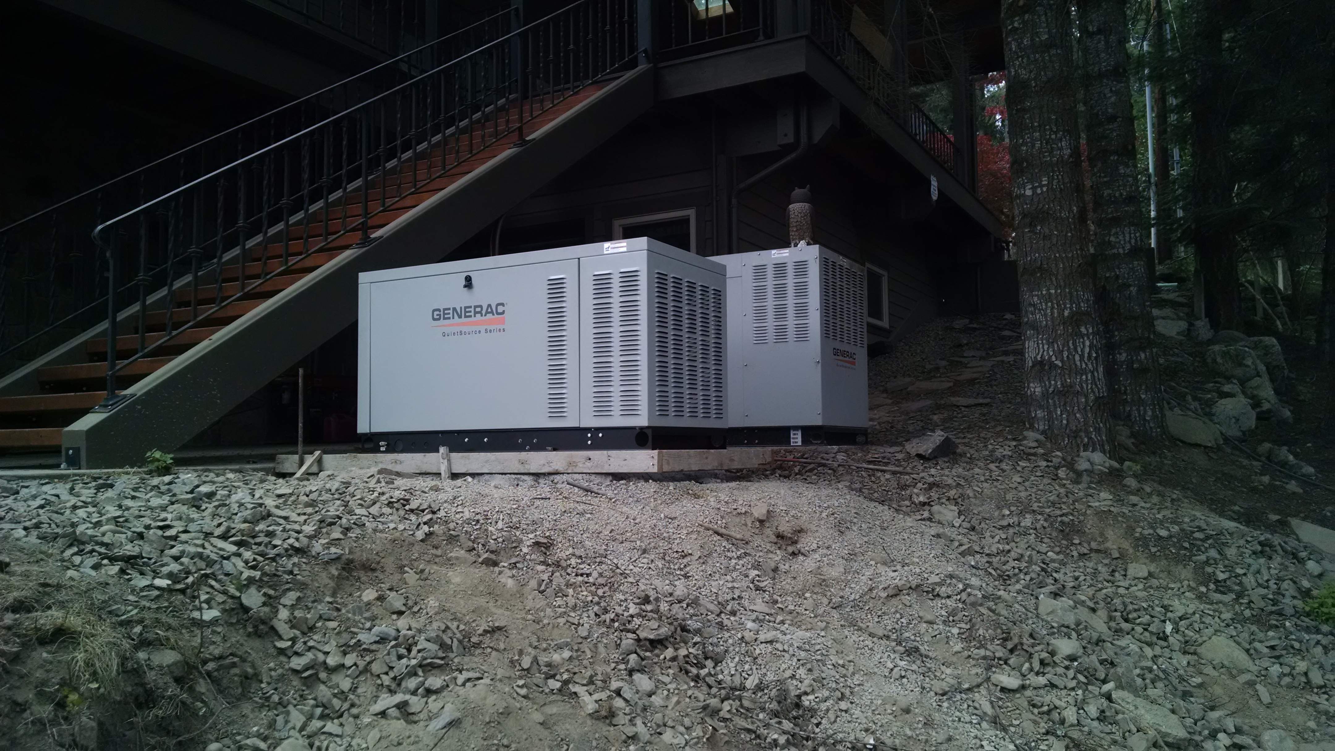

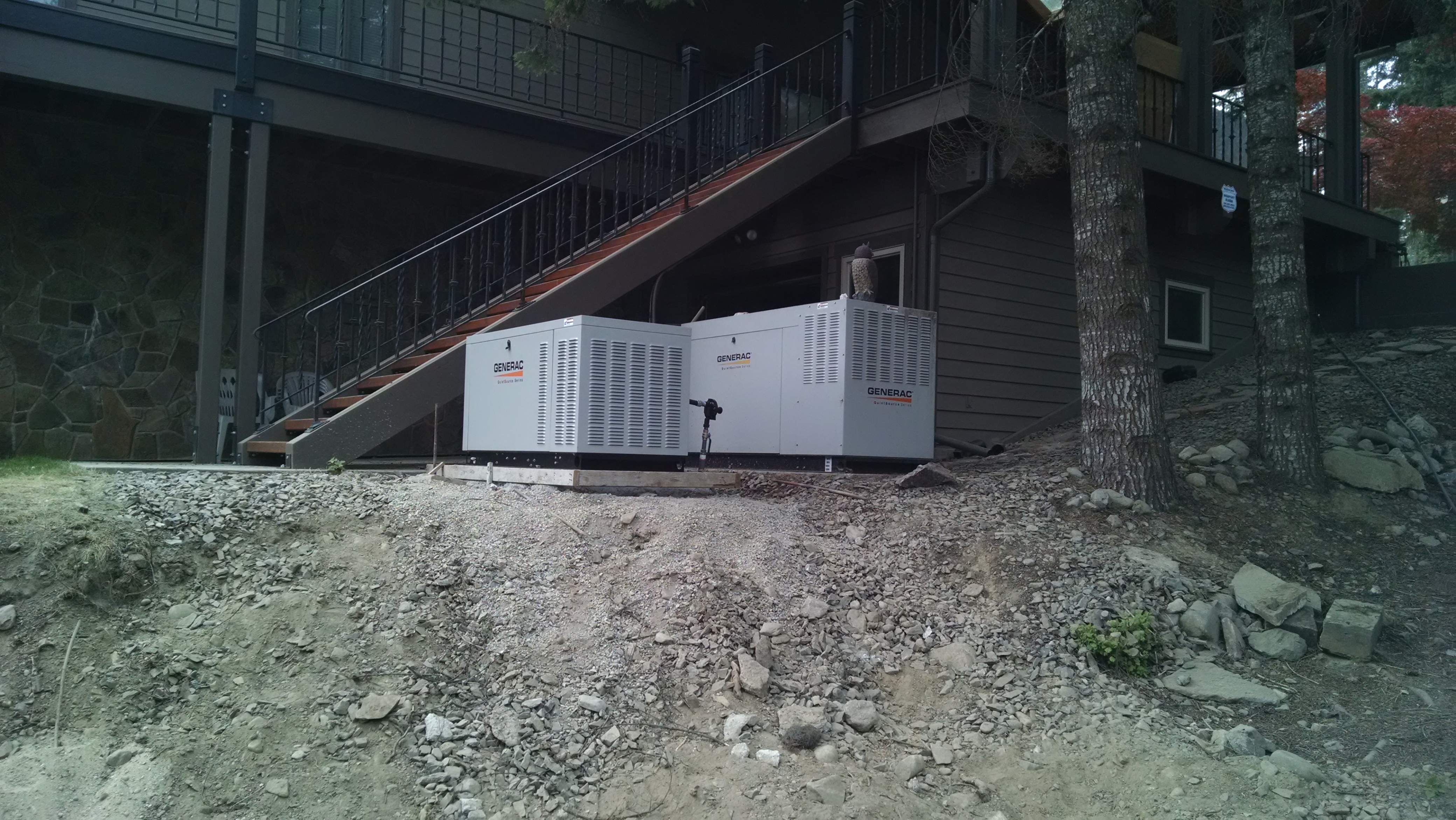

got that 22KW liquid cooled quietsourse installed. the guy had a 36KW quietsource already installed. this one feeds the guest house. Ill tell you what...that unit is quiet. about 1/3 the noise of the air cooled. i like it.

Do you have an estimate of the weight of your ballast rig with the concrete? Thanks.

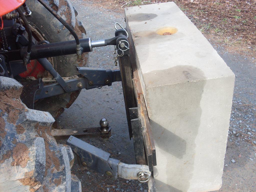

I have a couple of alternatives. What I was originally going to do was use a scrap cultivator. I planned to cut off the ends to the size I needed, build a plywood form around what was left and pour it full of concrete. Then I could strip the form or just let it eventually rot off on its own. The cultivator would give me the 3-ph attachment points and the part embedded in the concrete would act as rebar.
Then a local contractor dropped off some pieces of what I think were once composite concrete/brick ornamental gate posts. They're various sizes, mostly a little less than 2'x2' and assorted lengths. They looked so much like the concrete blocks used as barrier, ballast etc, that I decided to use them. I picked up a 3-point hitch fork lift. It's easy to back up to one of the blocks and pick it up, then put a chain around it to hold it in place (it would be embarrassing to have it slip off the rear fork in the middle of a lift) This way I have another multi-use implement instead of just a weight. Since I have forks for the loader, I don't expect to use the rear forks very often, but they're there if I need them.

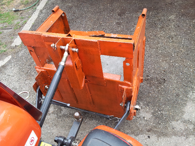

I made this attachment for rear forks, carry-all and the weight when needed.
