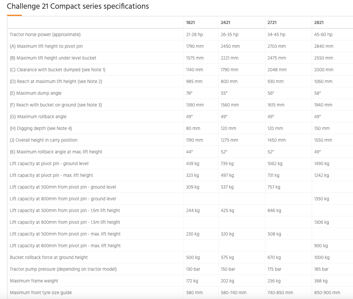

I have a Kubota MX5100, with an FEL to which I attach either a 4-in-1 bucket or pallet forks.
The tyres are filled.
I need to make a ballast box.
My property is very hilly.
I have seen some very impressive ballasts on this forum. However, they all seem to have rather high centres of gravity (COG). Given the topography of my property, it makes sense to me to try to get the COG as low as possible. Does this make sense to you folks?
I have access to dozens of brake rotors to use in the ballast.
All advice and hints on how to design and build the ballast with the lowest possible COG in mind would be greatly appreciated.

I don't have any implements other than the loader and the forks. I am not farming. It's a weekender hobby property. I have used the tractor a lot for hauling and lifting stuff. I was hoping to use the 4-in-1 for road maintenance, but the hills and the amount of loose rock in the ground make it extremely difficult to achieve a meaningful result. With this problem in mind, I am not against buying a suitable implement that I could use to maintain the roads (these are not the lovely level driveways that we see in all the videos about box scrapers and the like).
One of the lifting tasks I have struggled with has been moving 1,000 litre IBCs filled with water. They weigh 1,000kg /2,200lbs! Hence, my desire to get some decent ballast.
Your Loader has more lift than mine, however your tires are loaded. Your counterbalance need will be 800 pounds max with loaded rear tires.
I don't have a Kubota loader. I have a Challenge 2821 loader. The specs are in the attached screengrab.
Once you have counterbalance proportional to your Loader capacity, more-more-MORE TPH weight does nothing for you.
This is part of my problem - working out the maximum amount of ballast that will match the loader capacity.
I have given some thought to using the money the ballast would cost towards buying an implement to help with grading the roads, and to possible add weight to it as required if I am doing maximum lifting.

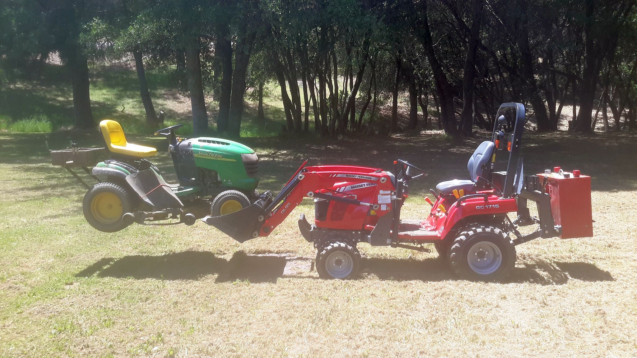

I made a 2x2x1 foot ballast box that weighs in at about 500-600 pounds (concrete weighs about 150 pounds per cubic foot), and it mounts "vertical", but there is no reason same dimension box could not be mounted "horizontal" if CG is of concern.... It just makes tractor longer and you have to be more concerned/aware about what is behind you....
Dale
