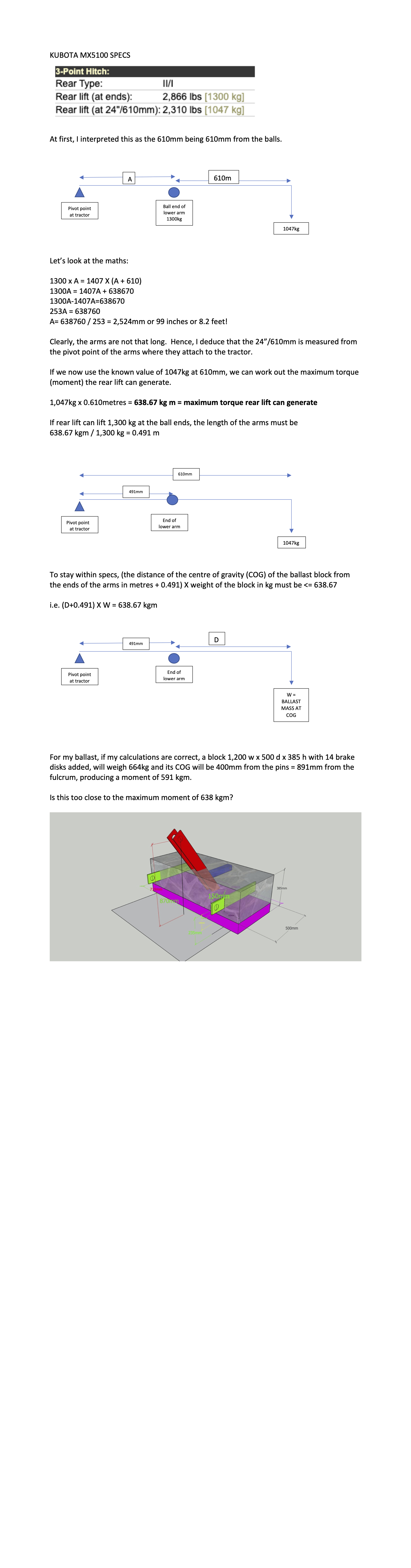

There is an excellent chance that I am over-thinking the problem or that my logic or maths is wrong, but I'll share with you, in the attached document, how I have come to the conclusion that I can't build a ballast block much above 600kg/1,400lbs. People talk about using much higher weights so it would appear there is flaw somewhere in my logic.

Your tractors rating is 2310 lbs (1047 kg) max 24 inches from the lower lift arm attachment balls. This is where the implement attaches to the tractor on the lift arms. There are more engineering safety considerations built into the factory number other than max lift. If your implement has a combination COG ≤ 24 inches and weight ≤ 2310 lbs it shouldn't be an issue.
My experience you can lift more and a safety factor is built into the factory numbers.

Nobody has been able to explain to me the physics involved in the loads at the balls and at 610mm out from the balls. I have decided to consider that to be just an academic exercise for now, and will base my thinking on the 610mm figures. In this case, the +/- 800kg ballast I intend building will be well within spec.

There are probably unknown to us safety, performance and durability considerations the factory design engineers apply to the max factory lift numbers at each location.

Before I pour the concrete, I’d be very grateful for some help checking the specs of my counterweight.
Tractor is Kubota MX5100 with a Challenge (Australian made) loader
Loader capacity: 1,300kg = 2,870lbs
3-PH capacity: 1,050kg @ 610mm = 2,314lb @ 24”
The centre of gravity of my currently planned block is at 525m = 20.6”
Assuming I keep the COG at the same point, what are….
1. The ideal weight of the block?
2. The minimum weight of the block you would aim for?
3. The maximum weight of the block you would aim for?
