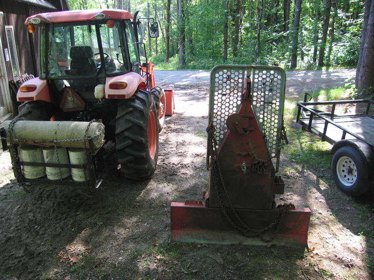

I am no expert, but I can share my experience.
Like you, my property is sloped and I do not have heavy attachments so I built a 3pt concrete counterweight. My tractor lift capacity is quoted at about 1200Kg, both the loader at pins and the 3pt (50 cm back). I have loaded tires - 200Kg each.
First of all, my tractor feels soooo much more stable with the counterweight. Hills are easy and I can safely lift so much more with the forks so do not delay, get building! I still avoid side slopes as much as possible.
For low COG, just build wide low forms with 3pt hookup and steel reenforcement and fill with concrete.
How heavy? I struggled to decide on the counterweight size and in the end decided on 600Kg. I soon learned it should have been heavier. Lifting my newly poured 600kg counterweight off my trailer with my forks (and no counterweight yet) lifted my rear slightly - not safe or fun!! Here is the math... 1200 tractor loader capacity - 500 max safely = 700kg counterweight required plus add 100 for extra safety factor. With my 600kg counterweight attached I can now lift 900Kg but have to keep it low. I wish my counterweight was 700 or 800 so I could be comfortable lifting 900 to 1000 (eg: a full pallet of sheetrock). For you, lift one of your IBC totes of water and determine what percentage of a full tote makes your rear end light or maybe even lifts your wheels and then do some math. 1500kg max loader capacity minus comfortable lift capacity = minimum counterweight size plus 100 for safety. Of course, do not stain your 3pt capacity.

A box blade isn't just for nice driveways. It will move dirt from uneven surfaces too. I've used mine to level out parts of my land. Our soil has a lot of large rocks in it. The BB still works. It's a better way to move dirt than the loader bucket. I bought a ballast box to fill with concrete but I haven't gotten around to it yet, so I have been using my box blade. I'd like a little more weight but it's much better than nothing on the back.
   / Ballast Centre of Gravity #13
The further the counter weight is from the 3 pt lower arm hookups the more effective it is balancing the loader. If you make one keep it's center of gravity a little to the rear by extending the 3pt hookup a little.
Loaded tires have center of gravity at the axle closer to the loader and this is why they are not as effective as an implement on the back.

I have 80 acres and a mile long gravel driveway. My rear tires are loaded with RimGuard and I always have something on the 3-point. About 99% of the time it's my Rhino rear blade @ 1050# on the 3-point.
This combination allows me to max lift with the grapple on the FEL.
However - I'm always cautious. A heavy load on the grapple( large pine log ) and an unseen hole could spell trouble. I never carry a heavy load more the 6" off the ground.
