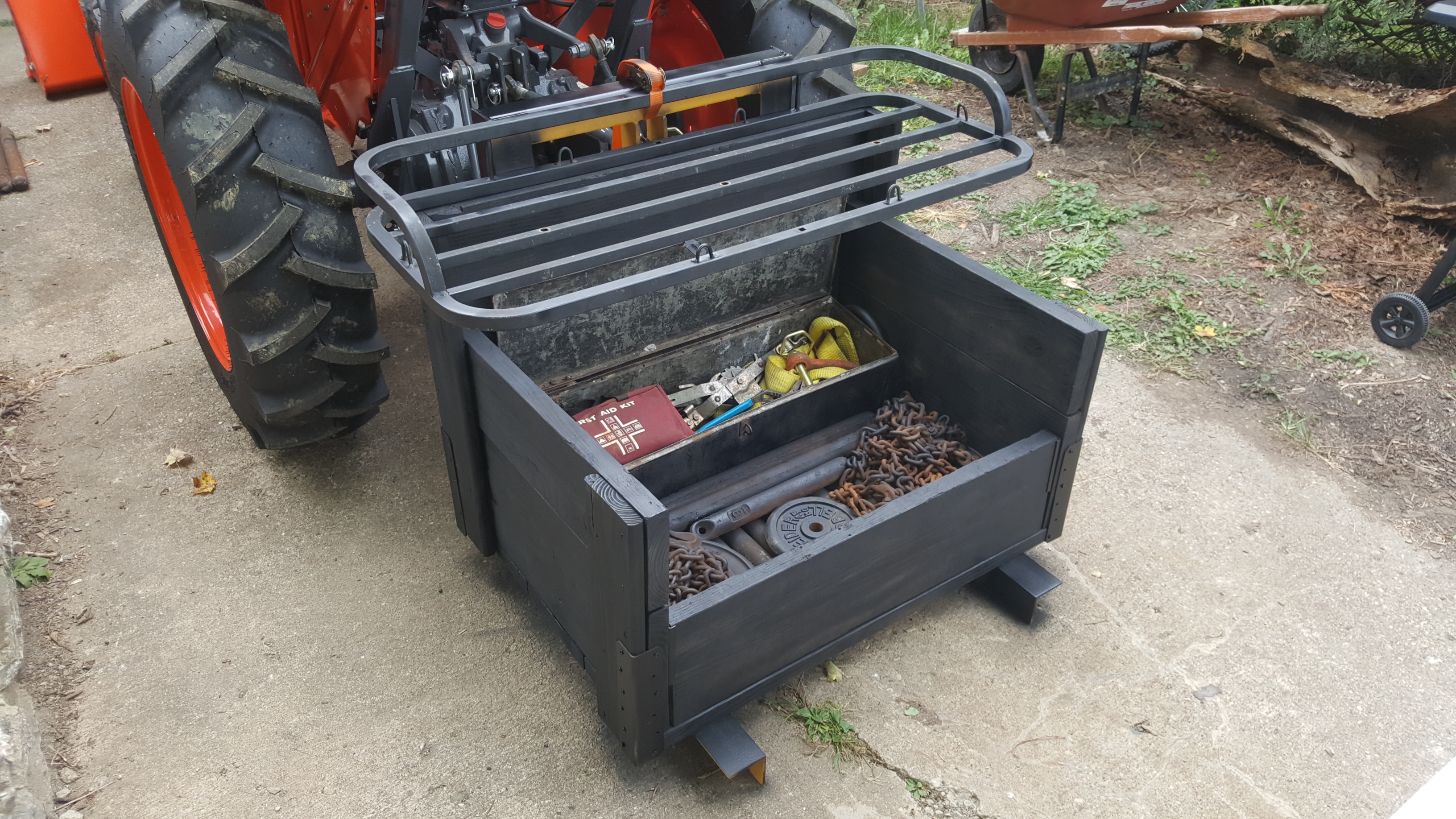

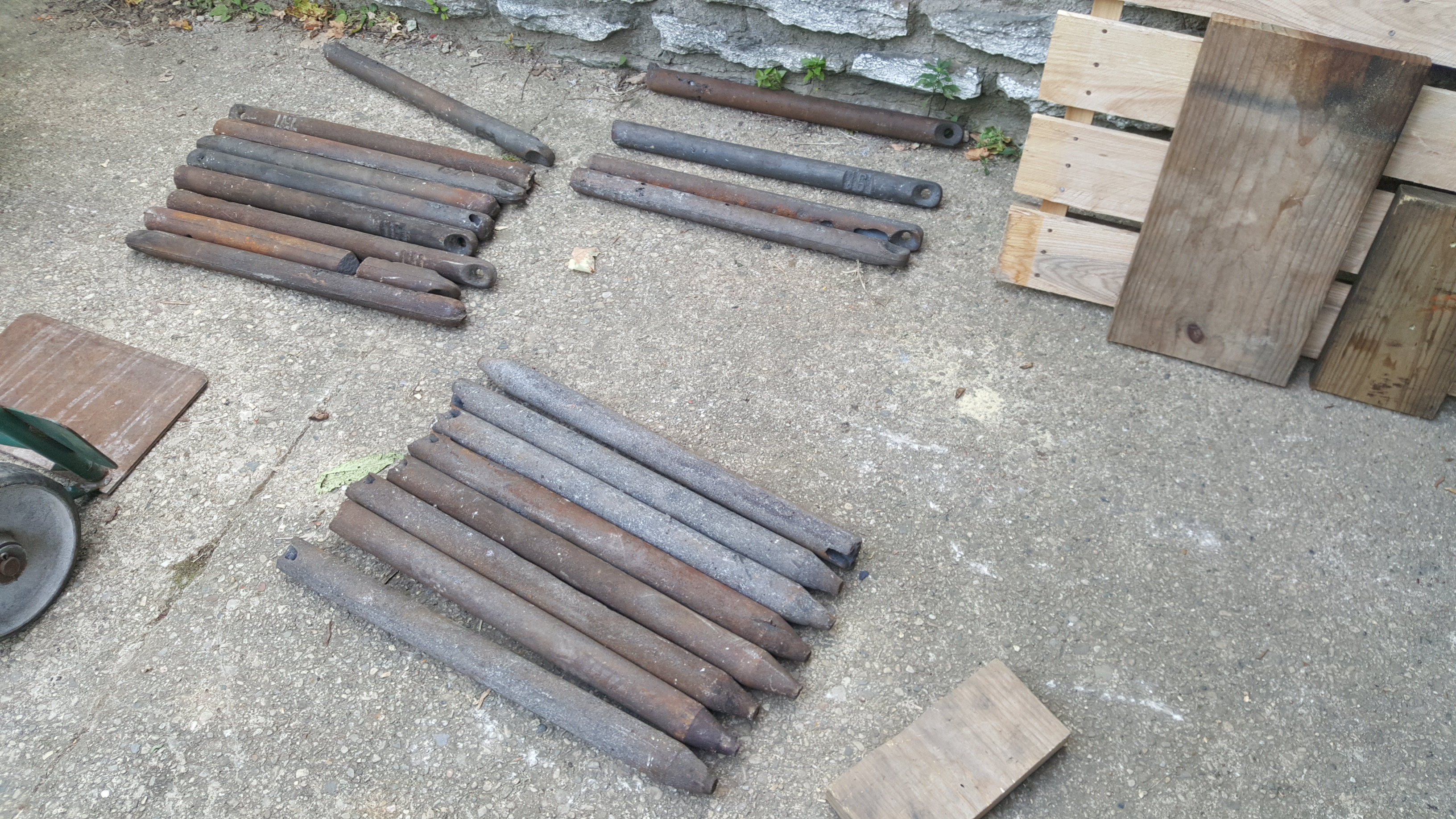

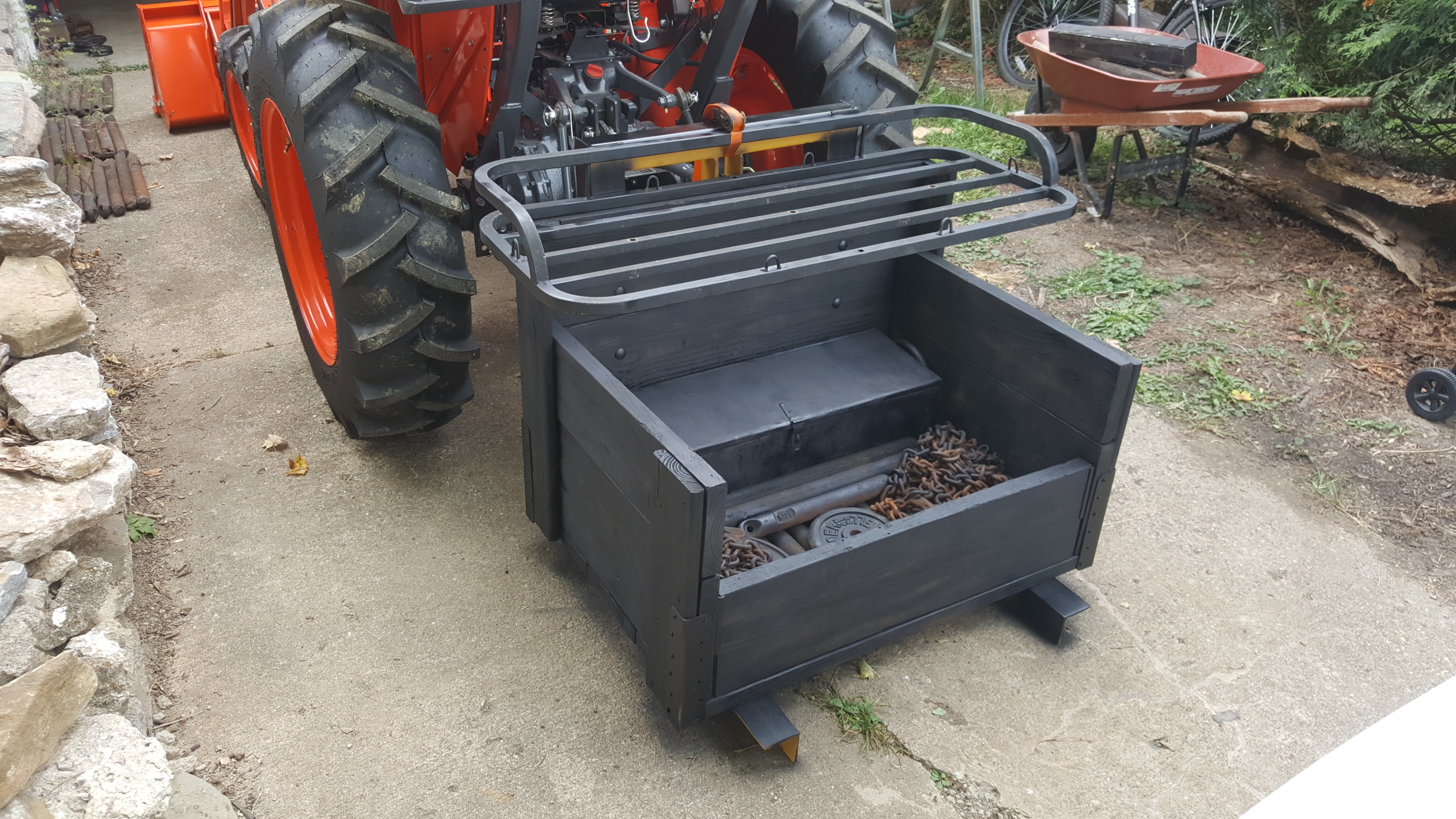

I decided to build a small carry-all box out of the Tractor Supply Co. frame. Wanted good maneuverability in tight spots (box blades and rotary cutters stick out too far either way) Had the extra wood laying around, and very lucky to have a friend that gave me 7-800 lbs of old window weights.
They are around 20lb each. I loaded the bottom of the box with them, roughly 400 lb... nice because it's low, and then just have a couple hundred lb of chains and tools in there too. I figure plus the weight of the box itself I'm around 600 lb. total which seems nice for most things given my loader/tractor capacity.
I can always just take the weights out or add more by hand. I have plenty extra :)
Still need to finish mounting the storage rack on top but you get the idea this is a multi-use counterweight that I hope works out for me...yet to be tested.
Didn't really cost too much, a little over $200 for the frame plus hardware??

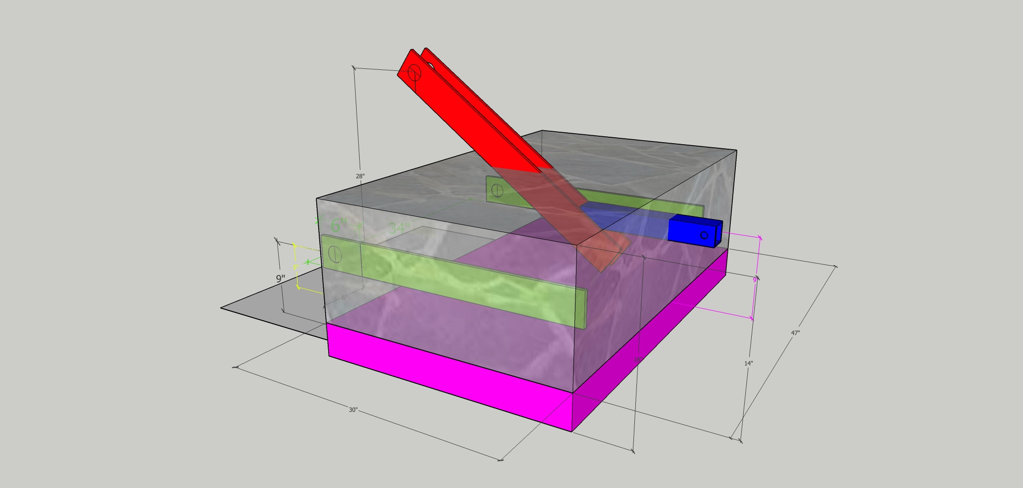

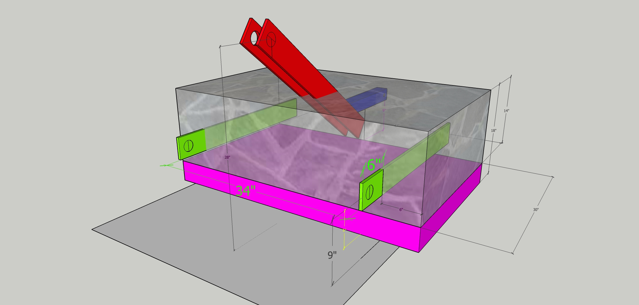

I have made a Sketchup drawing of my initial plans for the ballast.
At their lowest point, the lower arms on my tractor have the centres of the holes 5" above the ground. I have extended the base of the block down another 4" (depicted in pink on the drawings) so that the arms are not at their lowest point when the block is on the ground.
The upper linkage (red in the drawing) is positioned so that the upper arm will be about 1" (maybe a bit more) clear of the PTO cowling when the block is at its lowest position.
Ignore the position of the receiver (blue in the drawing) - I'll adjust this once I have finalised the main dimensions.
One of my main goals with this design, perhaps totally foolishly, was to get the centre of gravity very low. I think this design achieves that, but at the expense of extending back possibly a bit further than is ideal.
With these dimensions the block will end up weighing around 2,400 lbs (1,083kg). The tractor is a Kubota MX 5100, so this block might be too heavy for the tractor. Perhaps I should cut off the two corners farthest from the tractor, to reduce the weight and to improve the maneuverability.
Is there a rule of thumb formula for an approximate target ballast weight e.g X% of the Rear-lift capacity at 24" ?
All comments and suggestions about this design would be greatly appreciated. Bear in mind that I have about 35-40 hours of experience on the tractor, so I am definitely open to all advice you can give about the design.

I screwed 1"x4"x16" boards in the bottom of the forms. Once the concrete set, I removed the boards, leaving 1x4 sockets. Then I pounded in 2x4 boards that protrude 1" below below the ballast and act as feet so it is a bit easier on the garage floor. This would allow you to adjust your pin height.
As for weight, I have found that 50% of the loader capacity is not quite enough and I even have loaded tires. If I was to do it again I would go 2/3s. As mentioned above, the pressure relief valve should activate before the rears come off the ground, but that is hard to determine.

The specs for the loader differ depending on the distance from the pivot pin. It looks like 1,400kg would be a realistic number. My tractor is spec'd for a rear lift of 1,050kg at 24"/610mm from the ends. 2/3 of 1,400kg would be 933kg. That is seems to me to be pretty close to the limit of 1,050kg, but perhaps I am being too conservative.
It looks like the weak link in my setup is the capacity of the rear lift, and the calculations would need to be based on this limitation and not on the loader capacity. Would 800kg sound about right for my situation?
   / Ballast Centre of Gravity #48
The further out from the 3pt lift arm pins the greater the effect as a counter balance to the loader. This is why 3pt weight is more effective vs loaded tires. The dimensions look reasonable for a low center of gravity and safe counterweight that's small in size.
Interesting ratio. I am no expert - just sharing my one experience. If I was in your situation I would likely settle on 800kg. It will dramatically improve safety when lifting heavy loads. You may not be able to safely lift 1400kg, but how often do you need to. You will love how much safer your tractor feels every time you raise the counterweight.
