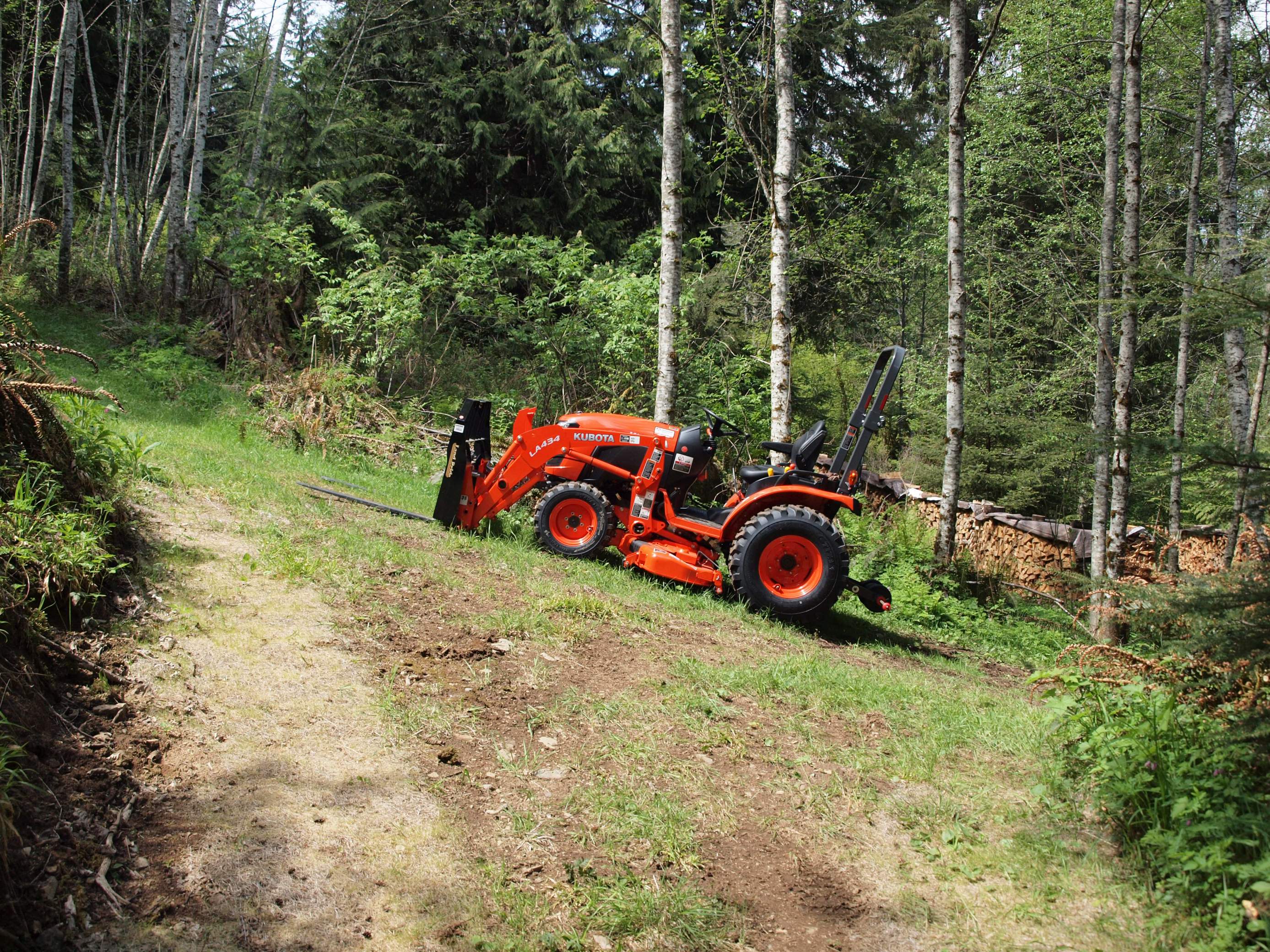

/ Ballast for B2601 #24
You can't get a much lower centre of gravity then a loaded bucket hanging 6 inches off the ground. It Sounds like the OP needs a counterweight. If the forks are clamped to the bucket that makes it worse than if quick attach forks. No amount of wheel weighting will help. If funds are short, go for a box blade, otherwise a ballast box is the best. With both the loader and ballast box riding 6 inches off the ground you would have a pretty low centre of gravity.
The best possible center of gravity on any vehicle is at axle height and between the axles. I just finished a few minutes ago cutting on steep hill and side hill angles again . . so its ever fresh in my mind.
It you are on flat ground . . then weight low in front and low in back is fine. But as soon as you put straight inclines and compound inclines in the picture . . . then leverage outside the axles exists and thats where it gets tense.
We all have different needs . . but one is the key . . . ever night . . bring your tractor and yourself home in one piece. On my steepness of hills . . a front end bucket is only on for a very small amount of time for very specific purposes. Some think I'm a risk taker . . . but I understand I have to have a constant awareness of geometry and gravity. :)

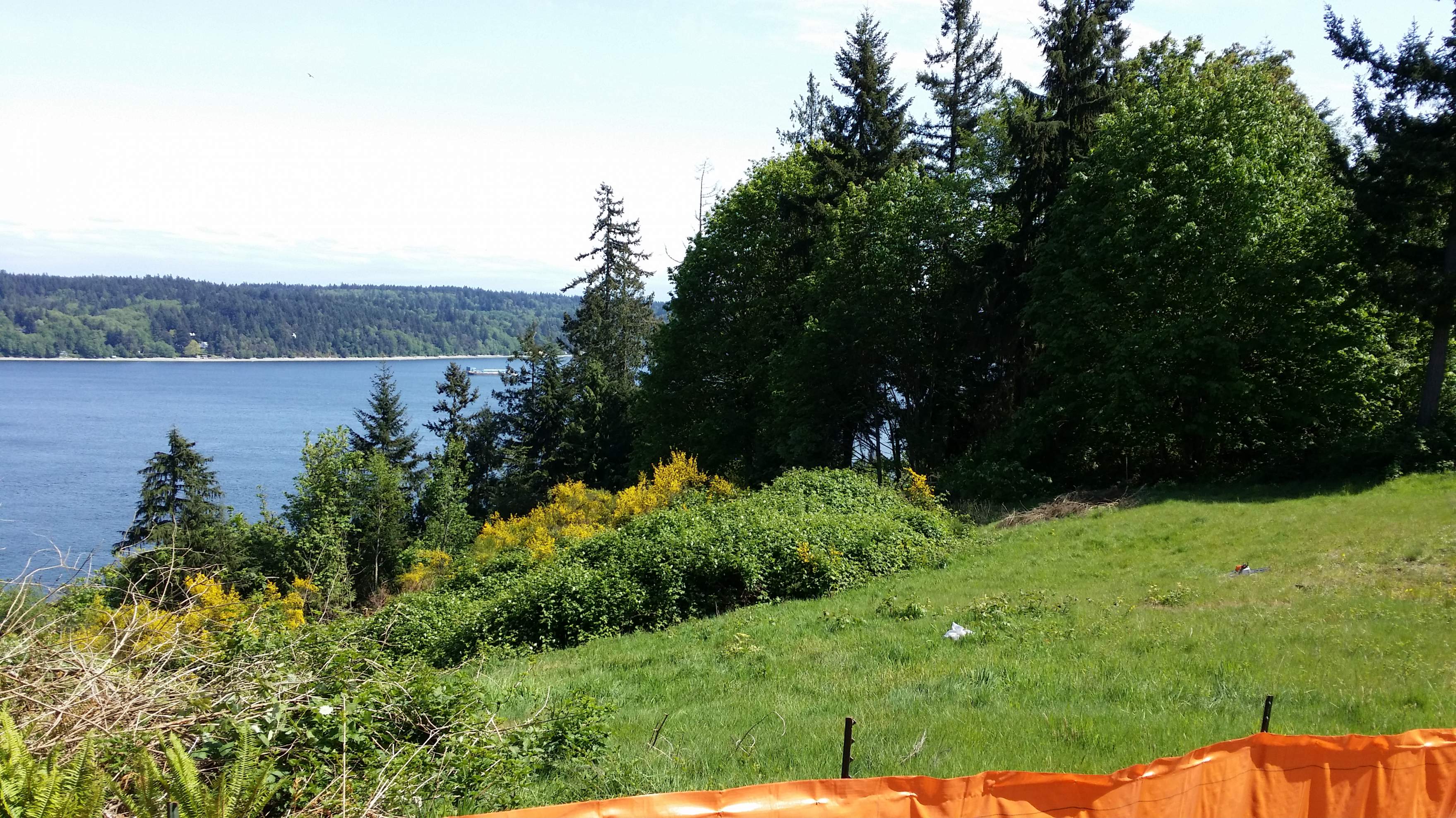

post a picture of it on your hill when you get a chance
/ Ballast for B2601
#26
Success! That particular part of the hill is 15 degrees and a little farther up it turns to 20 degrees. which is more than I would transverse sideways.
/ Ballast for B2601
#28
great picture! Really shows the slope well.
