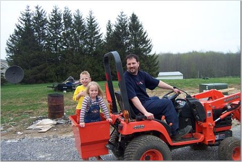

The weight box is a B8120. It itself weights about 100 pounds. It says the weight capacity max in the box is 300 pounds. Without it on the tractor you can move dirt but very carefully. But with it you can do anything the tractor is capable of lifting.
Remember if your moving heavy material with the FEL keep the loader as low to the ground as you can. In the event it starts to tip on you the FEL will bottom out and not tip you over. I learned the hard way after changing my shorts 1 time. There is no reason to transport things over your head until your ready to dump it.
It your moving mulch don't bother but if gravel or dirt I'd get one now.
