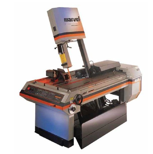

There are many saws which come with blade welders built in, and those saws are not $100k machines.
some fab shops I have worked in had Marvel vertical saws which had blade welders on them (but I don't remember if they were a Marvel accessory or something the shop added on) and I know those saws were under $100k new. We used them to cut 18" H beams and 12" tube steel on down.
They looked like this but earlier versions. I would love to have one of these if I had the space in my shop, even one 25 years old.

A lot of commercial vertical bandsaws that are made for hand feeding material doing intricate shapes and stuff have a blade welder on them. A vertical structural saw that has power feed like the Marvel in your picture is a really expensive saw and doesn't have a blade welder. I've never seen a bandsaw designed for cutting structural steel that had a blade welder on it. A blade welder for those saws is very expensive. The blade welder I used would do from 1/4" blades up to 2" blades and was water cooled. 1/4" blades for wood working were the most troublesome to weld.

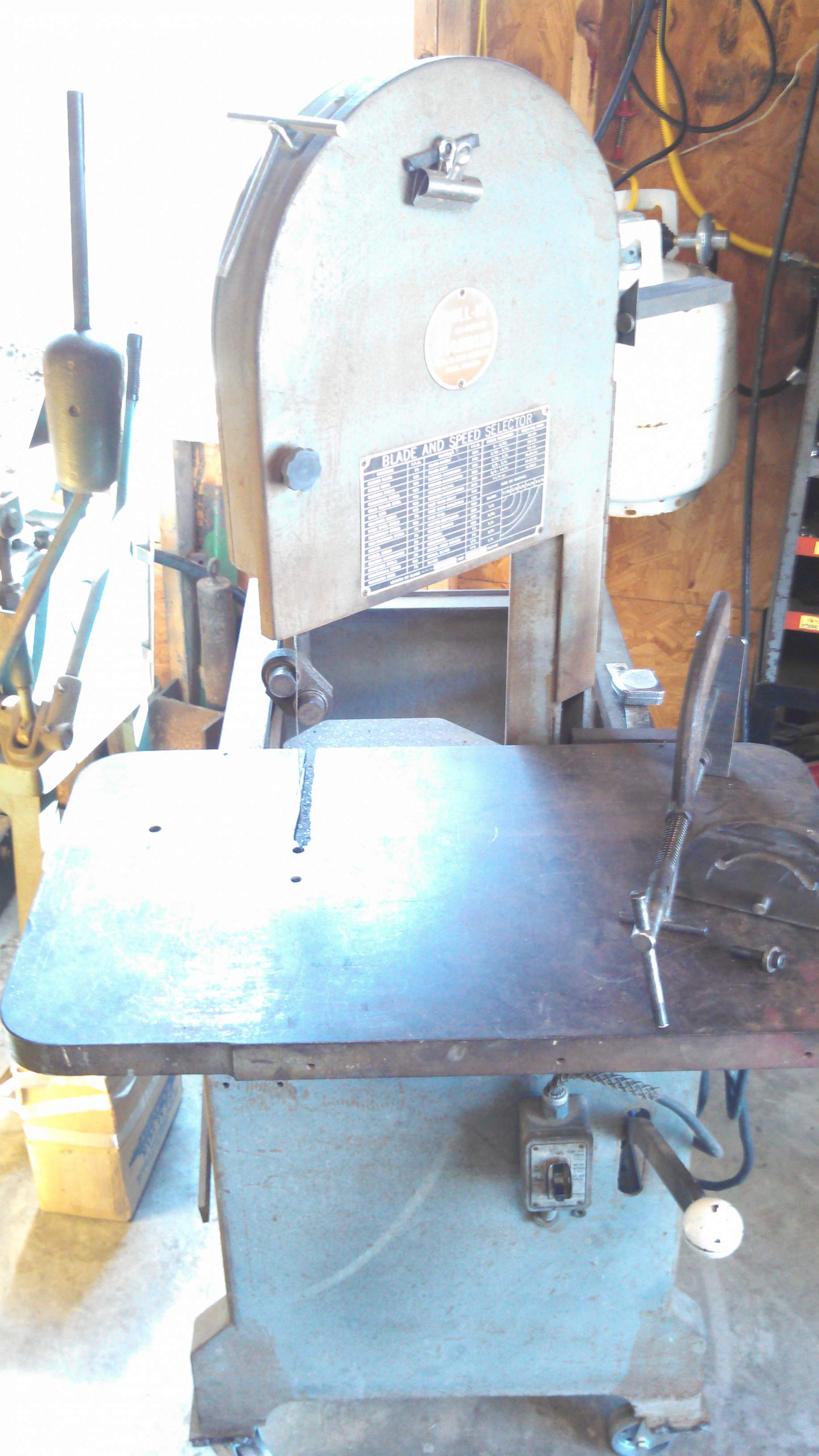

I still don't get exactly what the difference is between a "roll-in" saw and any other metal band saw. Google is no help.
   / Bandsaws---what type? #38

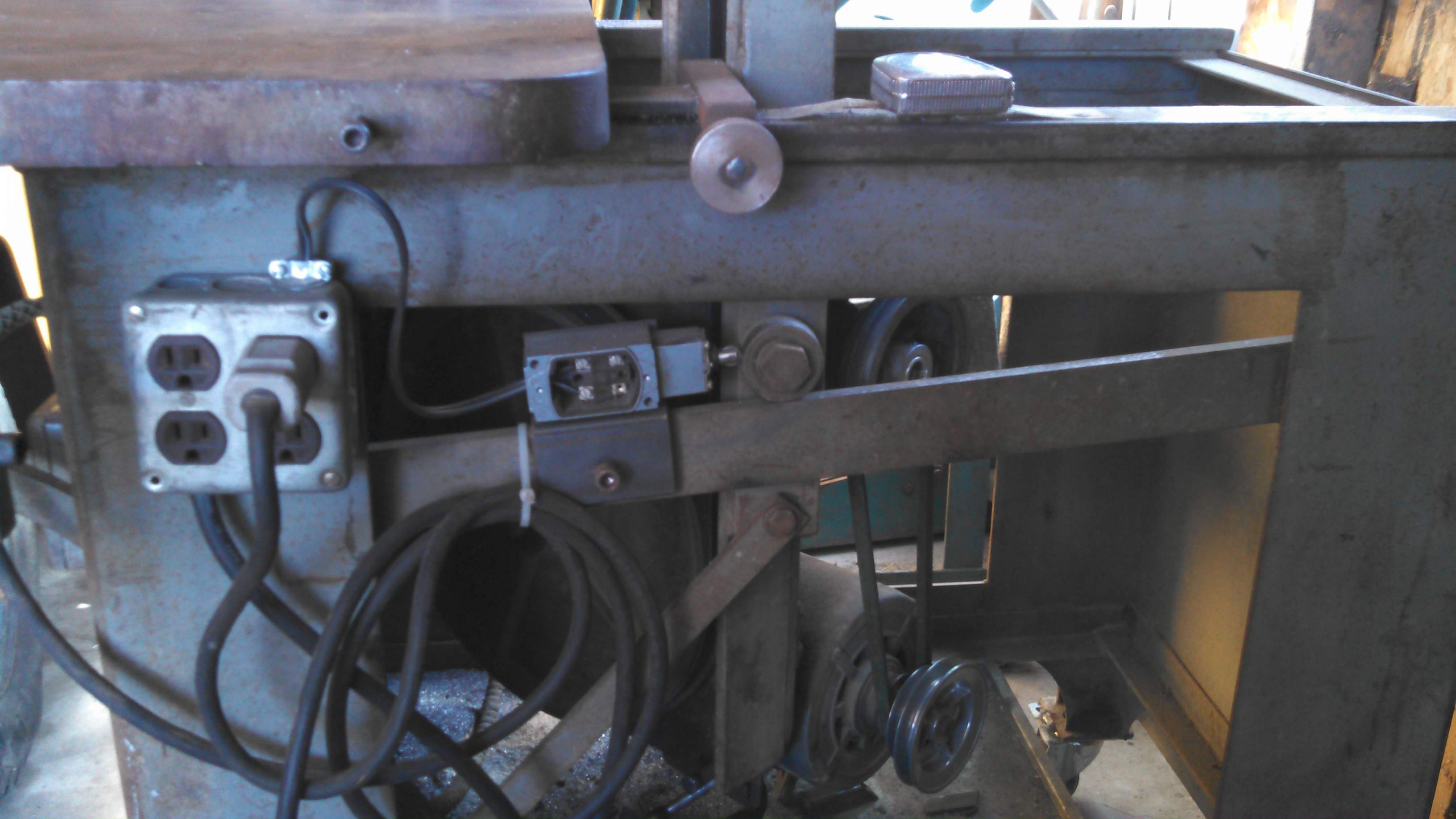

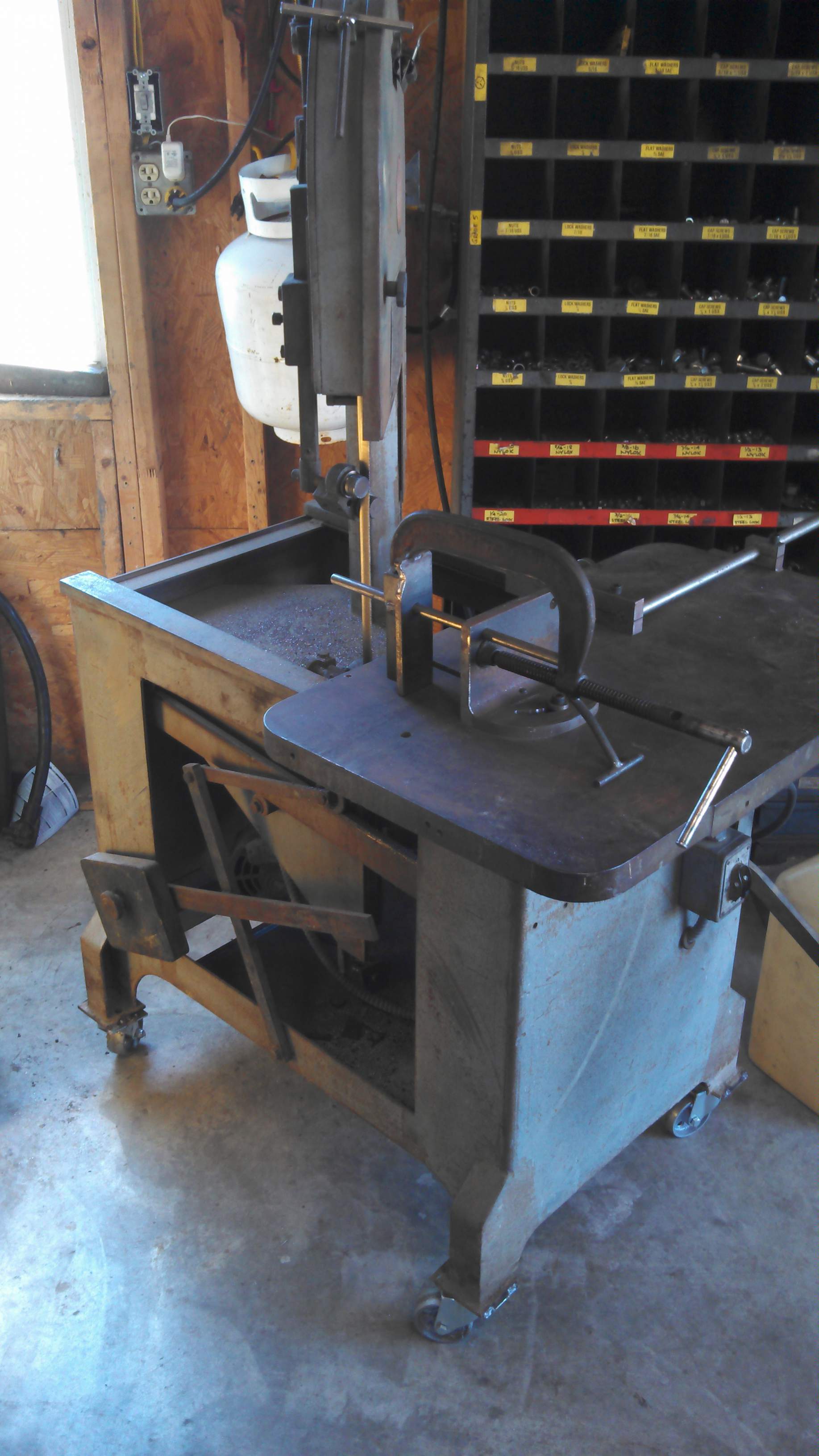

A roll in is different because it combines the offset blade of a horizontal (so you can cut any length) while still being a vertical band saw with a table for "hand work".
It is also self feeding using gravity, you adjust the counterbalance on the left side of the machine to set the cut pressure, clamp the work and let it go.
It can miter and the table is already drilled an tapped for stops, like the adjustable on I threw together.
I also added a switch to mine so it will turn off once it completes the cut. Lets me know when the part is ready for my attention again.
