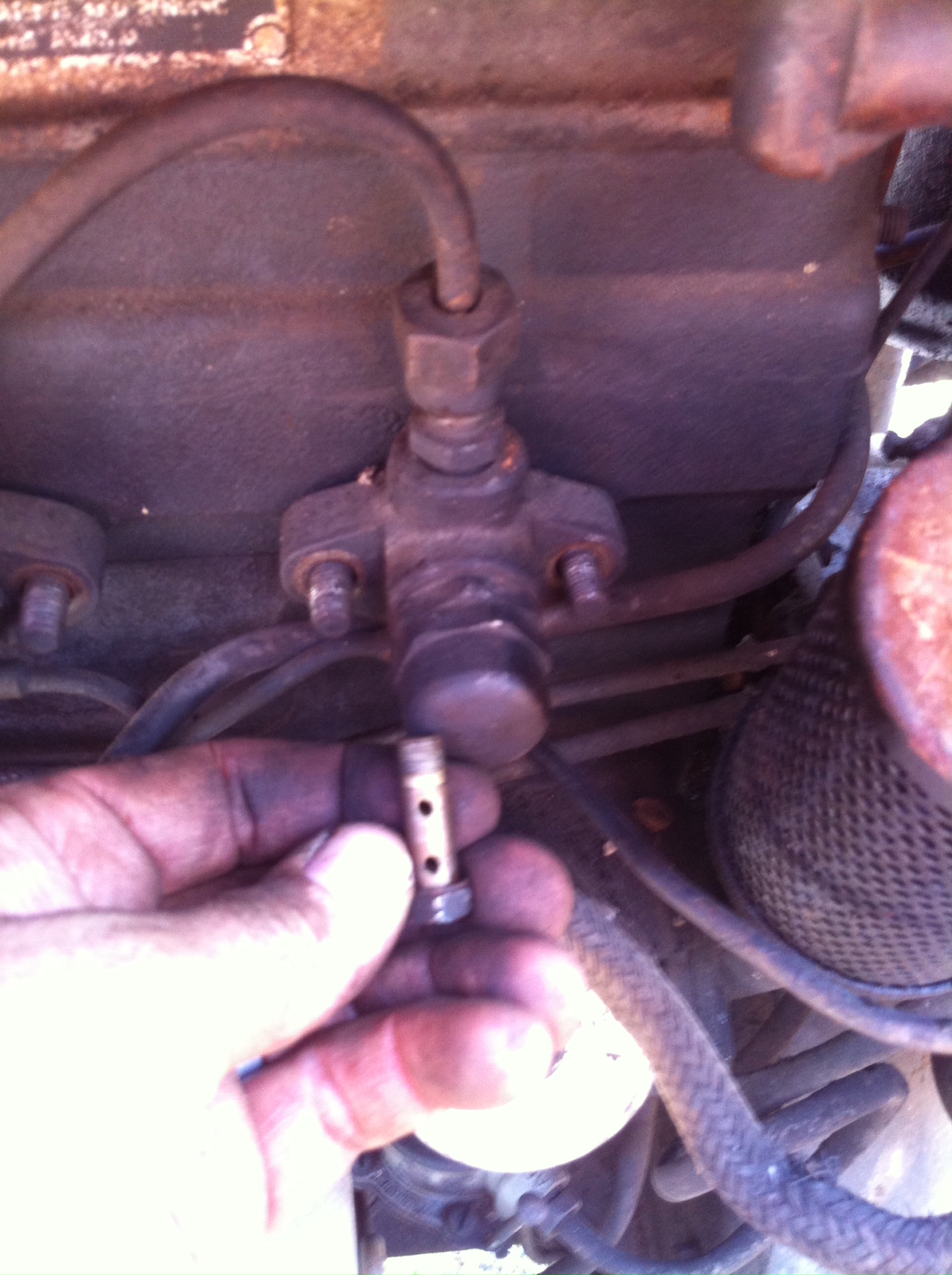

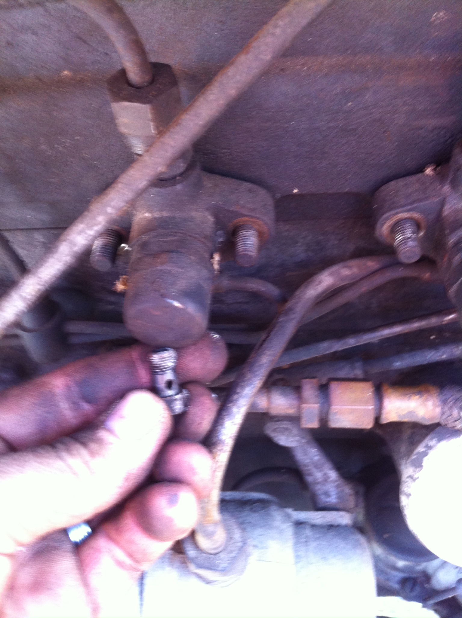

I have a 1956 TEF currently a non runner.
Can anyone tell me are the return fuel lines connector bolts from each diesel injector a generic item or when I loose them will I be up for complete new injectors.
I notice that some are single return and some are double. Ive called them Banjo bolts in the past is there another name.

Banjo bolt/fitting is the correct name, Mate. Blackwoods say they have them, although maybe not exactly what you require.
   / Banjo bolts on a diesel #3
The one on the left is a DOUBLE banjo bolt & the right is just a single.. To bad you weren't closer, I have a pile of um..
Don't forget to get the gaskets.. 2 per single.. 3-4 per double..
When I took them off there were no gaskets, just a single copper washer on each.
Hopefully I will beable to get an equivalent from Bolt masters, they are my closest.
   / Banjo bolts on a diesel #6
The gasket are the copper washer, those bolts are to buy at a MF dealer or tractor/diesel workshops.
   / Banjo bolts on a diesel #7
Keep in mind, you are suppose to replace the copper washer once it's used.
If you don't, you may want to keep a few around, to fix any leaks you have.
