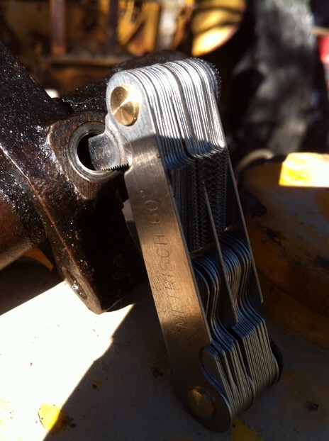

Seems that the thread is 8mm with a 0.75 pitch. Finally remembered and found my thread guage.

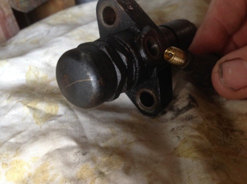

I was complaining to a mate from work about my need to identify the thread and he asked if I had tried a Schrader valve for size.
