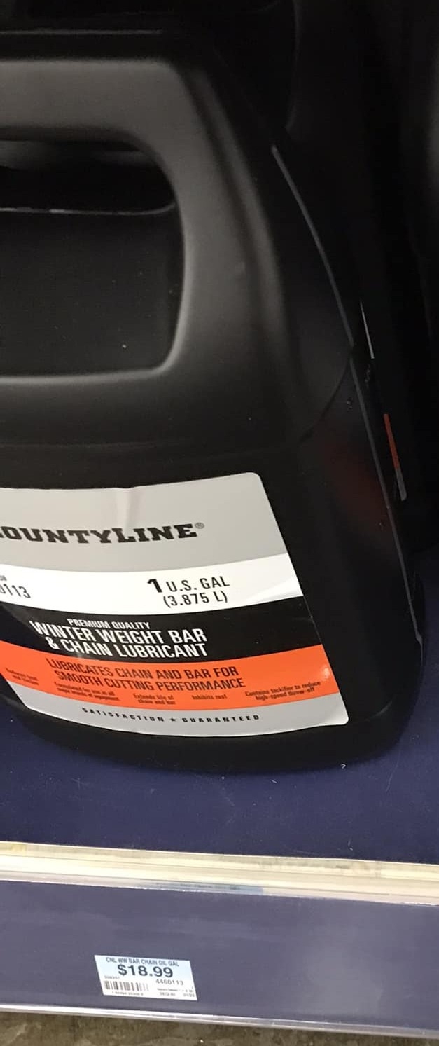

So you saying you dont know if the winter weight oil you bought there is 10w or 20w?
/ Bar Oil #43
The can said winter oil.
Ya I get that. But winter bar oils come in 10w and 20w.
I'd steer clear of 20w ones.

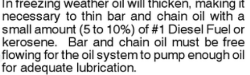

Just use some diesel and all good though. Was in manuals too.
The can is not in my possession. Here's what there page says,,,, which is not much.
The CountyLine Winter Chainsaw Bar and Chain Oil lubricates the bar and chain for smooth cutting performance in low temperatures. Designed to inhibit rust, this winter chainsaw bar set is sure to hold up for long-lasting use. The chainsaw bar set also contains tackiness agents to prolong performance. It's great for extending the life of the chain and bar.
  • Chainsaw bar set reduces heat and friction for safe use
  • Formulated for use in major brands of equipment
  • Extends the life of the chain and bar
  • Chainsaw bar set inhibits rust for long-lasting use
  • Contains tackiness agents to prolong performance
  • Lubricates the bar and chain for smooth cutting performance in low temperatures

What I've found from cutting a ton of extremely dry, extremely dead standing ash is that you make more dust than you do chips. That wreaks havoc on your bar/chain/oiling no matter what temp it is outside. But 20deg is definitely cold enough to justify winter grade bar oil. Cut it with diesel if you're in a pinch. If you're making repetitious firewood type cuts, pause in between cuts and mildly rev the saw to get some oil to the bar/chain. But even that might not be enough
