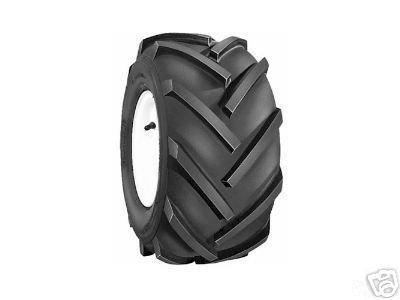

Did you check Ebay, I found hundreds of lug or bar tires. Check listings for seller TUCKERTIRE.
I have received many good deals from Ebay sellers.

Yes, I checked eBay. That's where I found the metric-sized import 6-plies.
I also emailed Tuckertire and Rustybore -- neither could get 10.50s in 6-ply, other than Carlisle Super Lugs and those imports...
