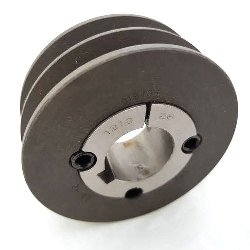

By gear, you mean pulley? Usually those are locked to the rotor shaft using a taper lock system. Essentially, there is a taper between the locking hub and the pulley that as it gets tighten, the hub will compress and lock to the shaft.
To remove these, you pull all the set screws out and put one on the hole that is meant to pull the hub out. Which will be the hole that has threads on the hub instead of the pulley like the other holes have.
This may or may not be the case in your flail though.

Well, disregard the previous post. From the exploded view, looks like it's just a big ol'nut (#39) on the shaft. I imagine there is a key so the pulley can drive the roter and you may need a puller to pull the pulley out.

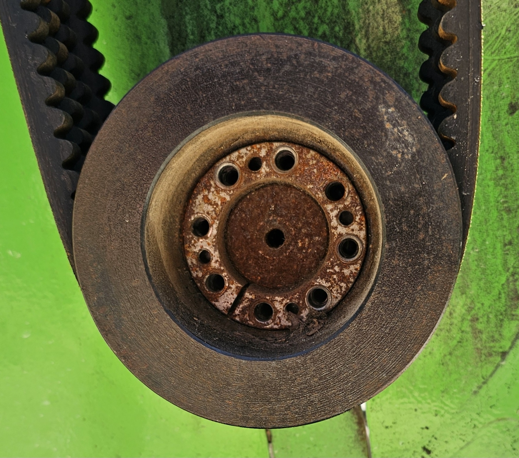

Yea, pulley. Mine has a bunch of small bolts similar to your photo with a very small one in the center.
/ Barbed wire vs Flail
How do I pull it out without damaging something?
/ Barbed wire vs Flail #7
Ah nice. Picture really helps. It's a taper lock system but the parts diagram shows something completely different.
Thread 4 bolts on those threaded holes I marked and tighten equally. Eventually, it will pop the pulley out or in, depending on how you look at it.

Got the pulley to come off. No lube needed. It would have taken a lot longer without all of the help. Never used a taper lock before.
Jacking bolts are wonderful, and I wish more products included provisions for them
