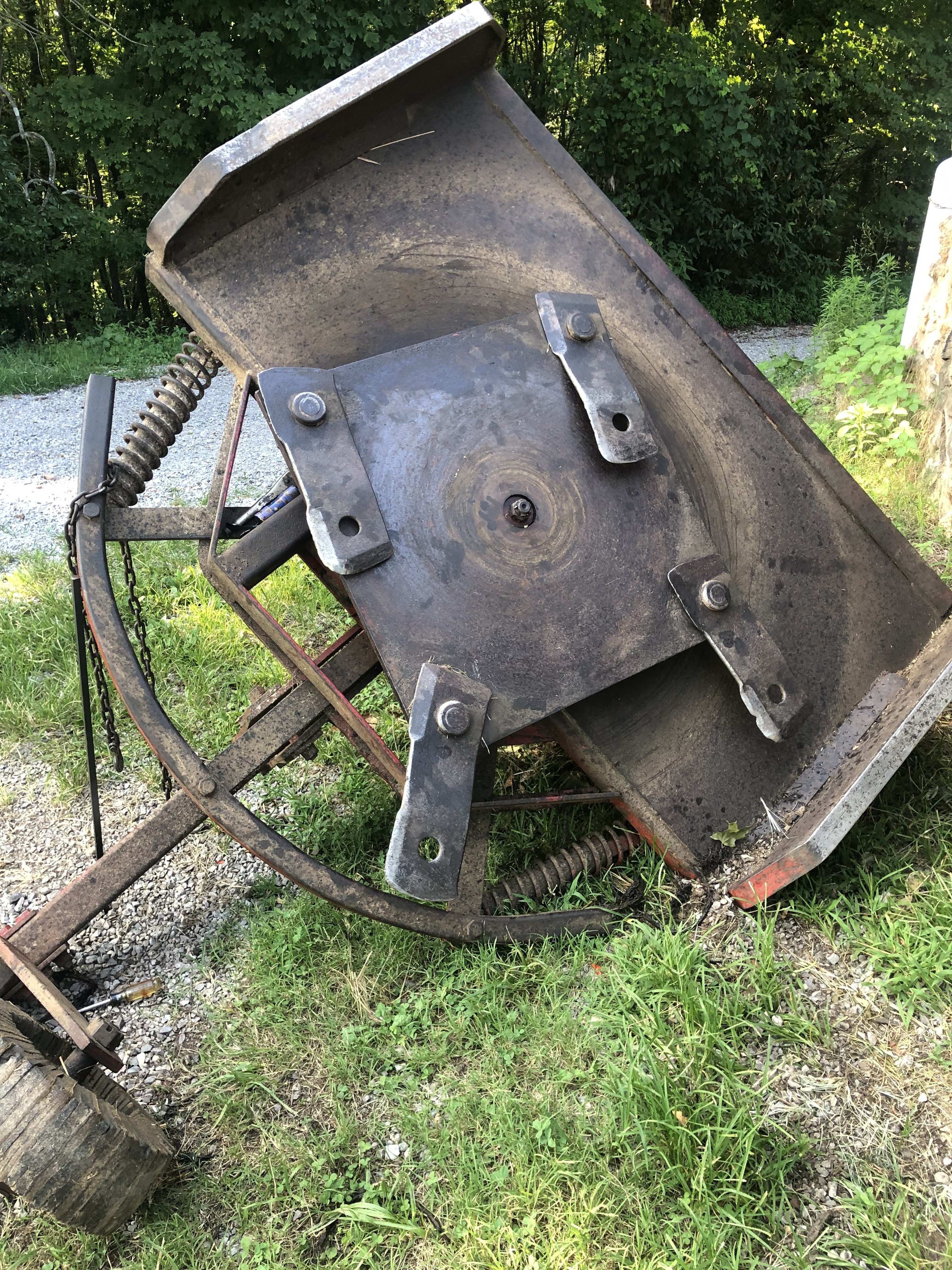

Got the pulley to come off. No lube needed. It would have taken a lot longer without all of the help. Never used a taper lock before.
Hello Torvy,
Please be sure to use a torque wrench for the taper lock screws and
a bead of blue Loctite on the taper lock screw threads to secure the
taper lock bushing.

Thanks all. Using @leonz idea, I was able to get it off of there. Since it's a ditch mower, setting it on its back was tricky.
It's all put back together. Lube and testing will have to wait until tomorrow. The beauty of retirement. I can stop before I hurt myself and do more work tomorrow.
I thought about using the dremel, but I'm out of the grinder wheels. Hopefully there won't be a next time.

Just enough here to stop rotation. It's free now.
