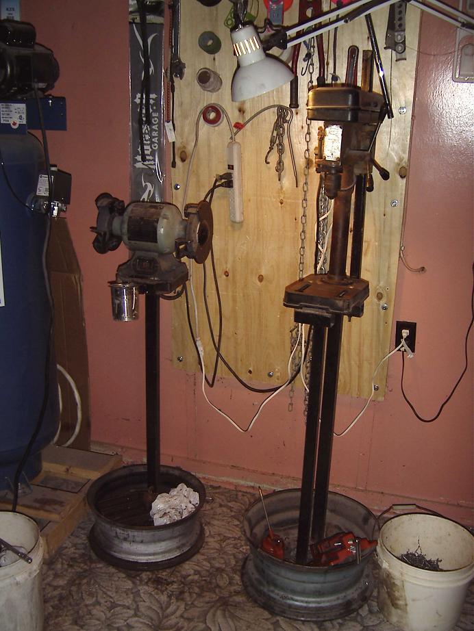

btw, have included pics of a couple quick/cheap backyard pedestals
