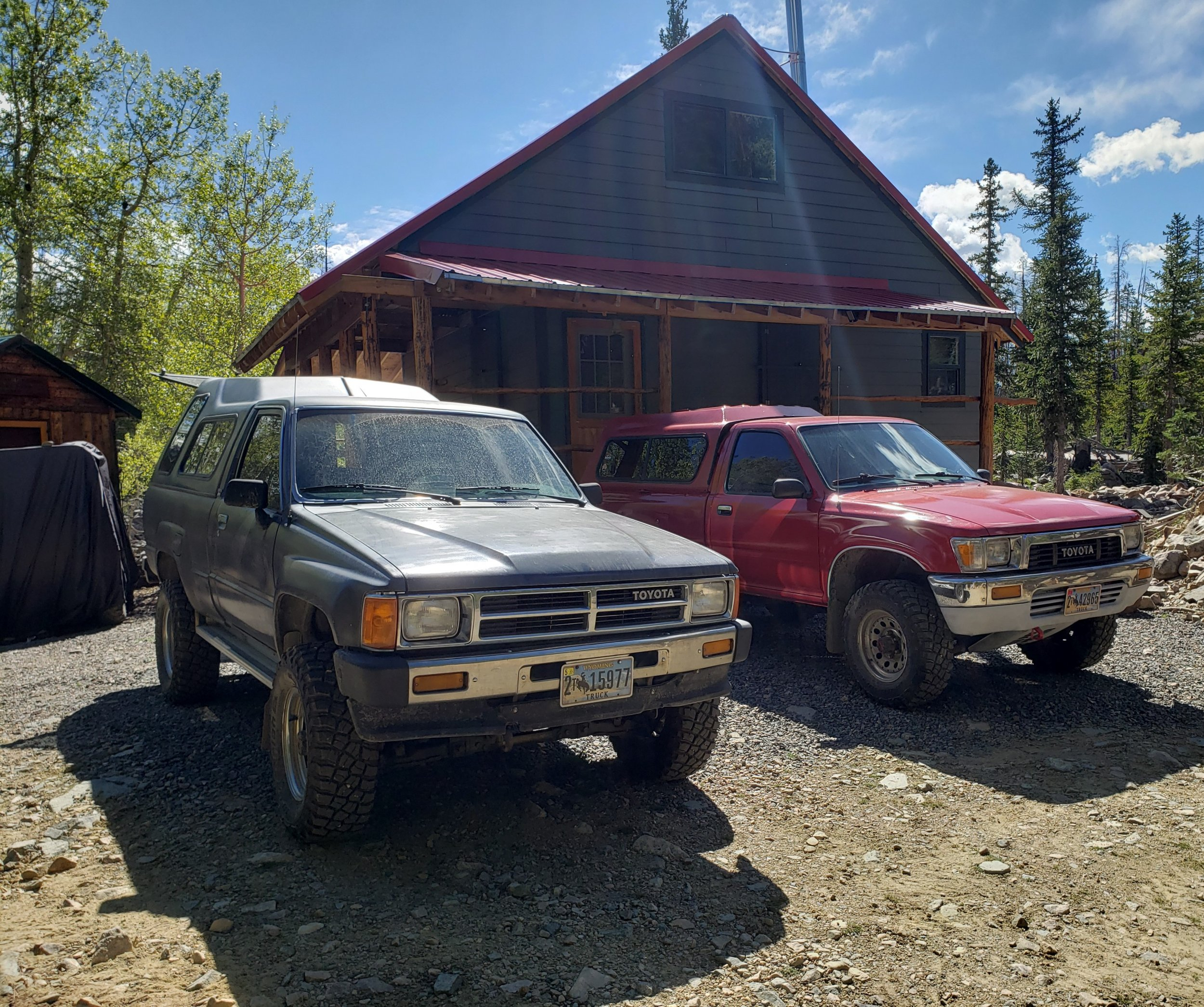

When I repainted my 1988 toyota truck with epoxy primer, I waited 2 days. It is still holding up today. The problem I had was it was my first paint job. I didn't put enough mill thickness down to build up the paint layer. I now, 12 years later, have some of the top coat wearing through. Plus I used a single stage paint. Mistake.
Two year ago we painted my dad's 1991 toyota truck. I did not use epoxy primer and did do a paint and clear application. Much better and it's how I am going to redo my 1988 truck this spring. I'm an armature at this, but we like to take the toyotas up to the cabin. It's the best vehicle for that. So I learned how to work on them because it seems nobody likes to work on 1980 vehicles anymore, or knows how for that matter.
