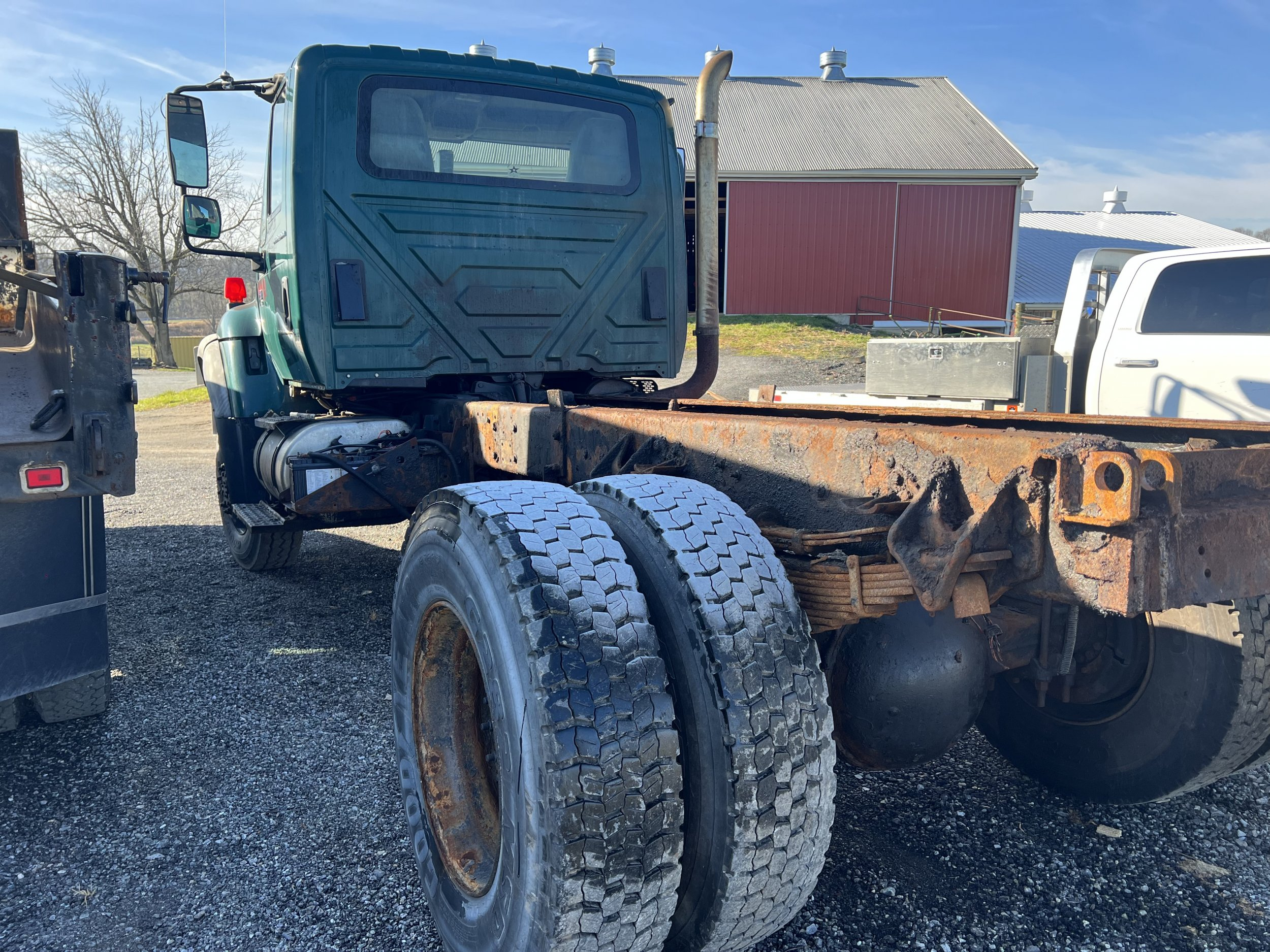

Thanks for the advice. My truck frame is moderately rusted. Has some flaking and some rust jacking, but not enough to require replacement. I want to make sure I convert the rust before painting, right?
I ask sincerely, because I don’t want to skip a necessary step.
Not a show truck by any means, but want to make sure I’ve done as much rust preventative measures as possible before painting.
I like the wash primer idea, but does it convert rust, or just cover it?
Just to reiterate before we drift to other areas, I am trying to restore a badly surface rusted, flaking double truck frame. Trying to make it last 5-10 years if possible.
Step 1 was to remove the dump body. That is done.
Here’s what I’ve got:
I think the next logical step is to sandblast all the loose material and surface rust/flaking off as possible.
I guess my most basic question is: What is the next step I do after I sandblast?
My guess is a rust converter, but that’s where I am looking for suggestions.
Thanks to all and appreciate all thoughts.
   / Bare metal epoxy primer for truck frame #38
I am certified on a number of automotive manufacturers paint systems. NONE of them have, use, require or recommend a rust converter in their best practices. That should tell you something.
If you are not going to properly clean the metal for paint, it's a waste of time painting it. Rust converter is a gimmick for homeowners to use when they can't, or won't properly prepare the metal. If you remove the rust, there is nothing to convert.
Preparing that frame for paint while it's on the truck will be all but impossible.
The rust needs oxygen to form. If you cover the metal with anything that blocks the air and water from it, it's going to prevent corrosion.
I suggest you scrape and wire wheel it thoroughly, them apply a coat of a professional quality undercoating: Rusfree ruberized undercoating, which you can brush, or spray on, https://a.co/d/7hjbILp That will actually do more to protect it than anything you can do yourself. While it's a dirty job, it's very cost effective. It does dry enough to touch it without transfer, but will never crack, or flake off if the surface is clean when applied.
