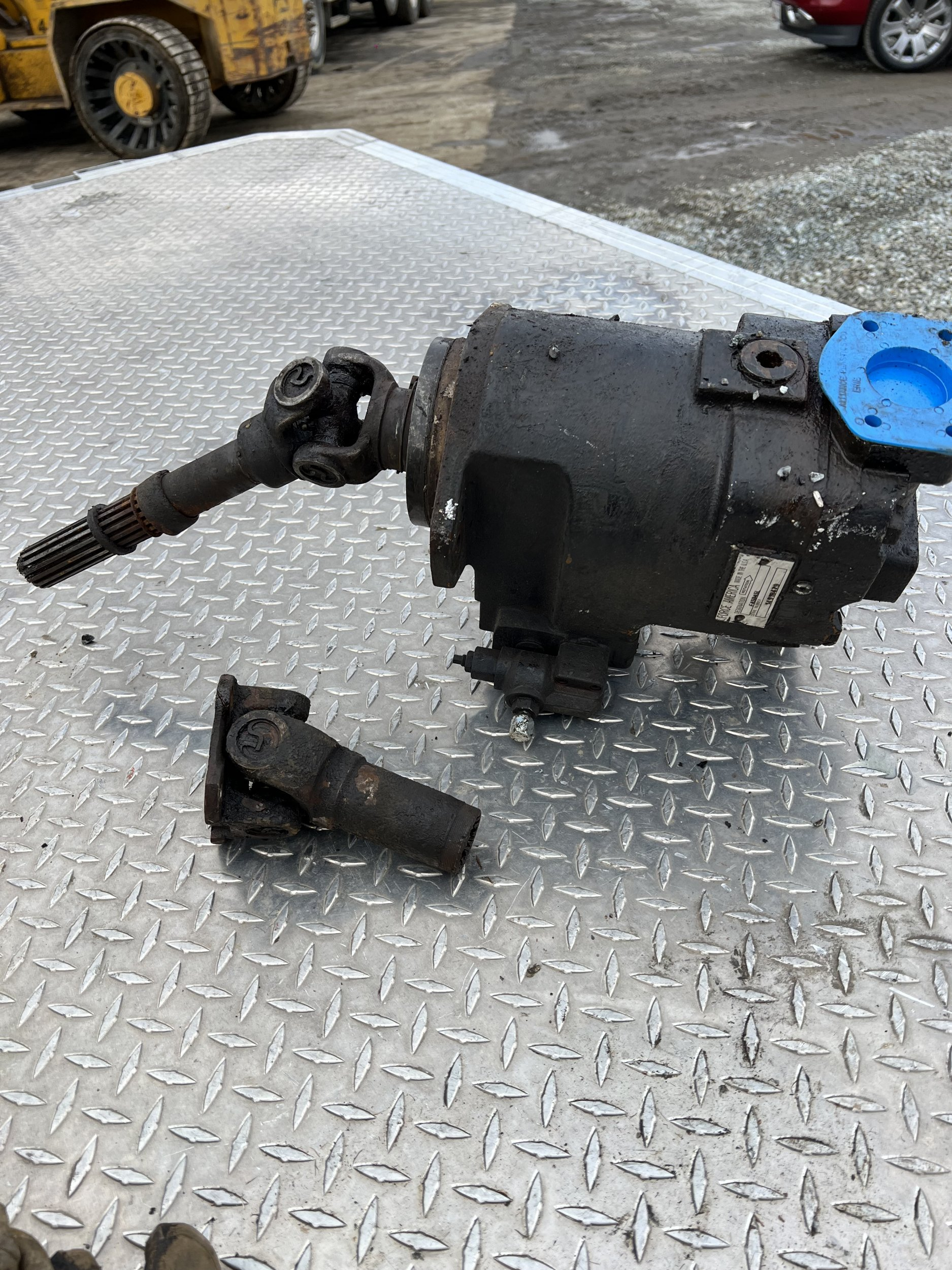

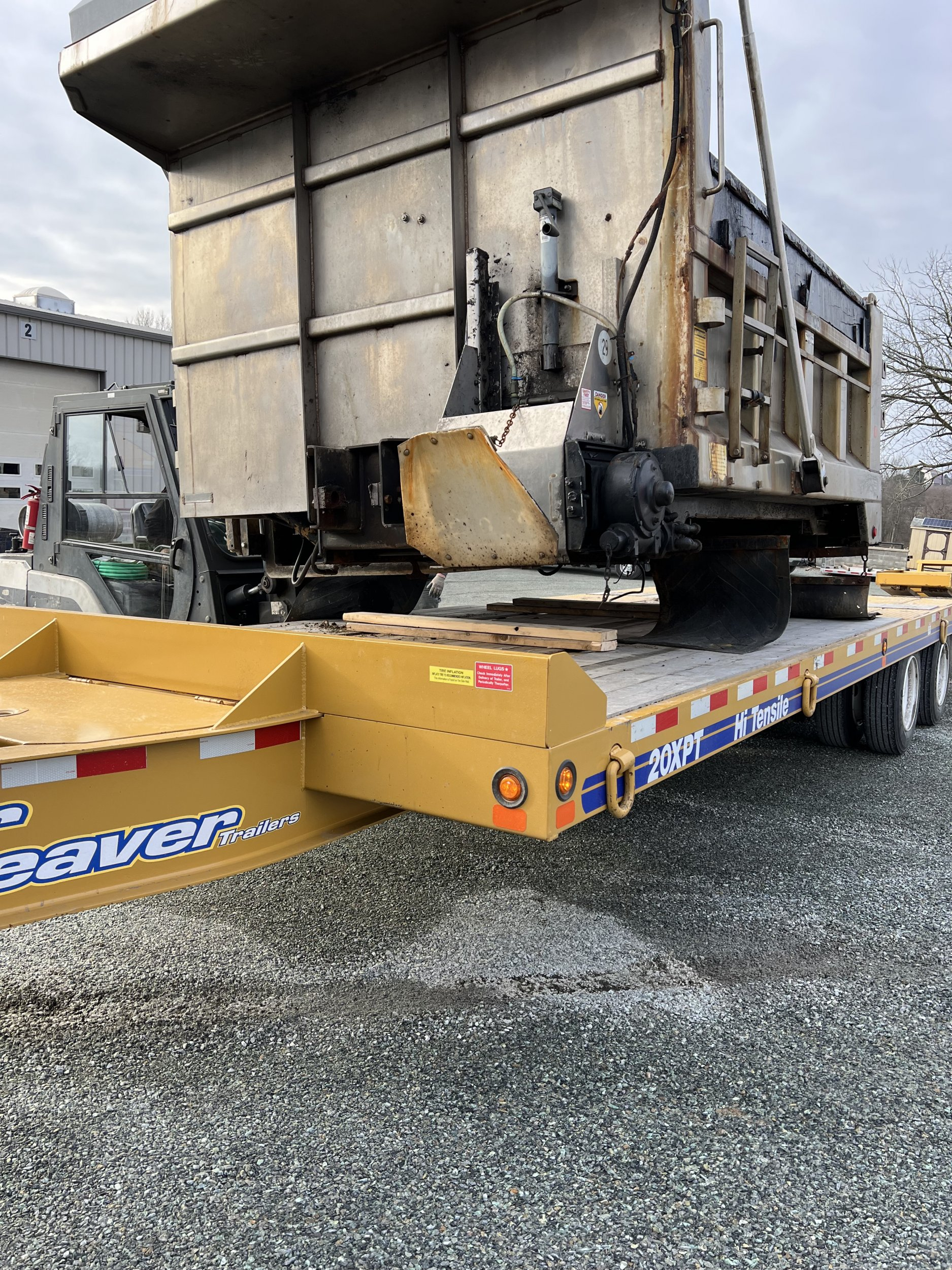

Sold Stainless Steel bed & hoist today.
Probably took a little less than I could have, but still happy to have that behind me.
Still have engine driven variable piston pump. Was $7,000 new!!!
Trying to get $2,000.

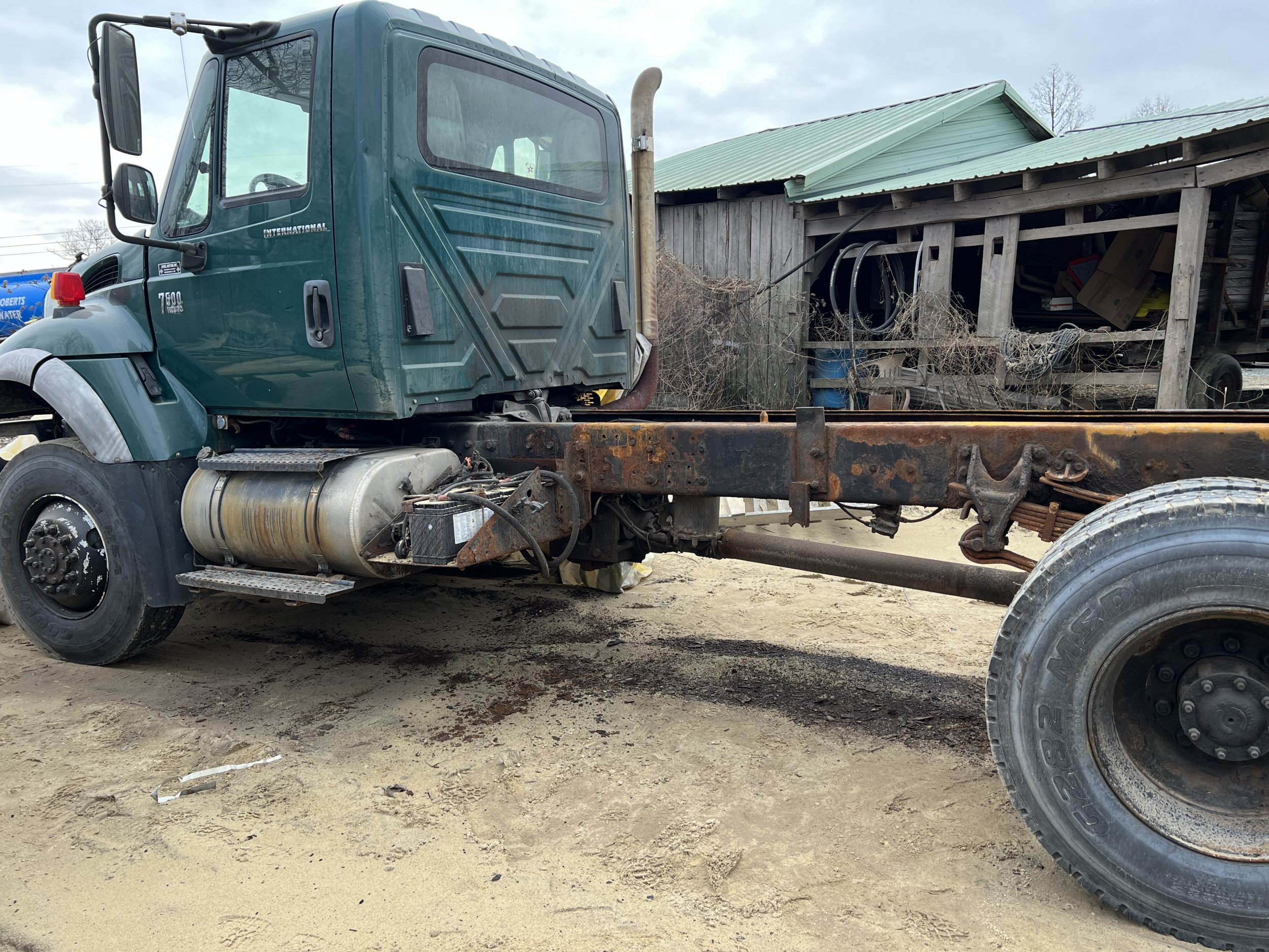

Got some more rust jacking removed and going to finish blasting next clear day we get.
LOL, told u they weren't cheap. The weight of the things you could almost sell it for scrap LOL, they're fun to replace by the side of the road in a snowstorm, trying to take off the oil filled 2" suction line that seems to shrink in length once you remove it is fun also.
Glad you finally got rid of the body, one less thing to be concerned about. If they had used a little bit of grease on the slip yoke would have been good as well. I've always said, government vehicles are greased twice, the first and the last time....if they see grease at all.

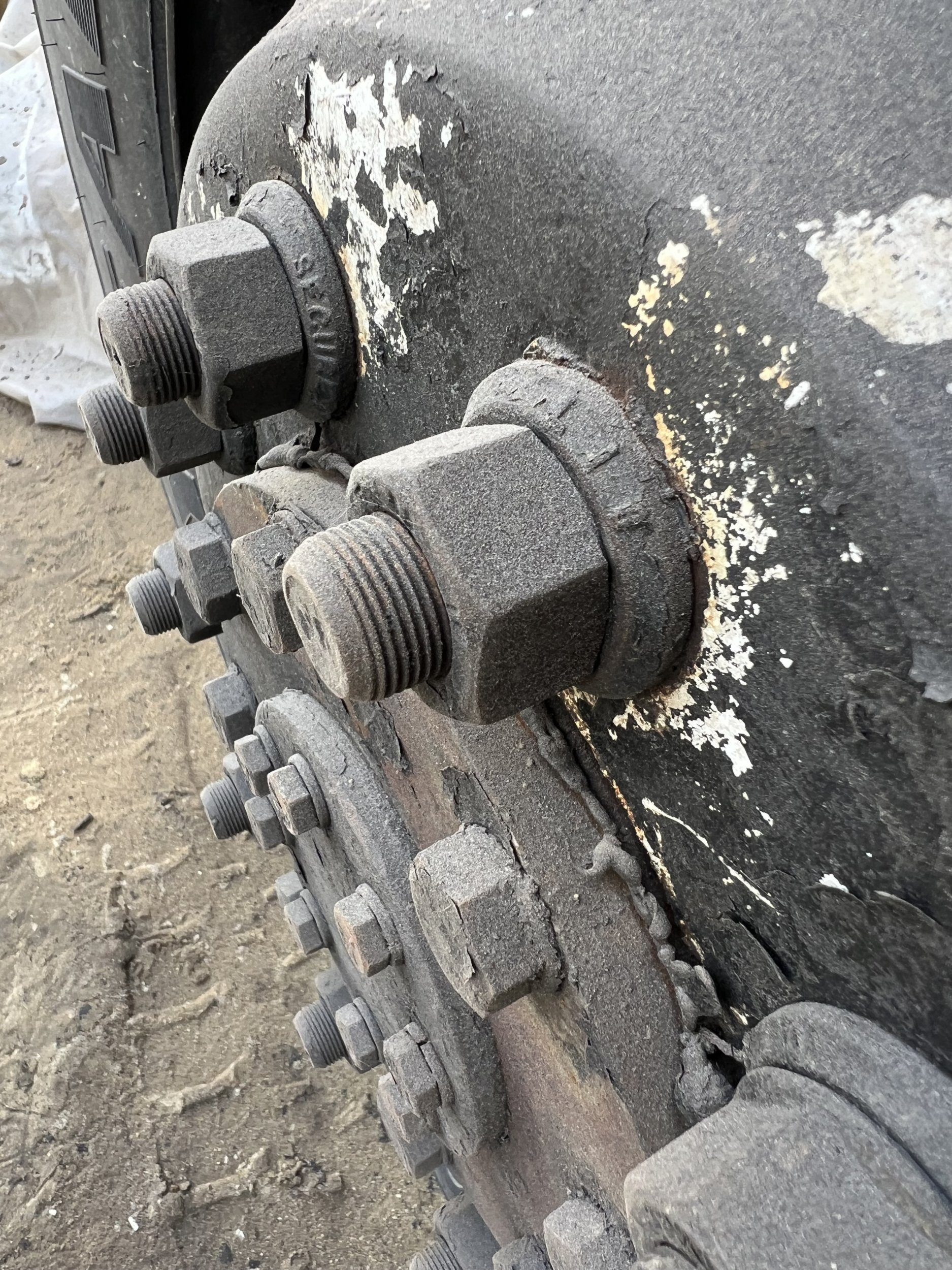

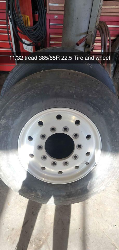

Looking ahead: Found some used, wide base Alcoa aluminum rims with 385/22.5 tires.
I see about 1/2” of extra thread on my existing front wheel studs. Wondering if it’s enough for the thicker Alcoa aluminum flanges?

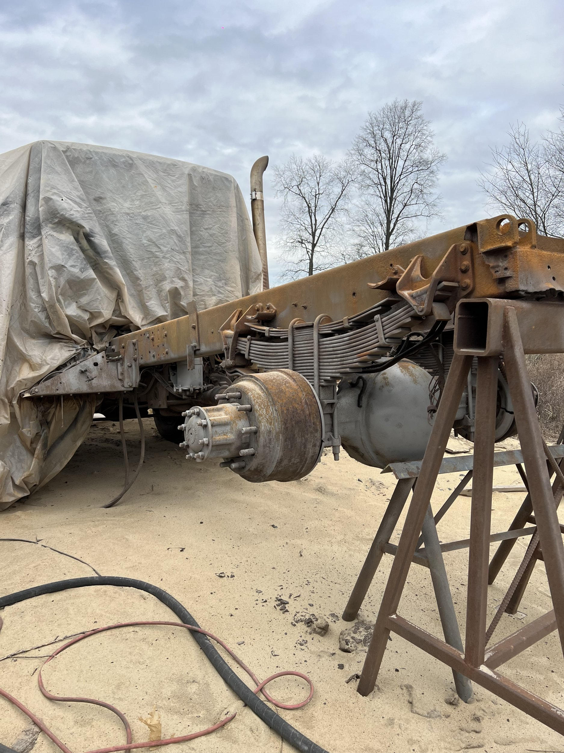

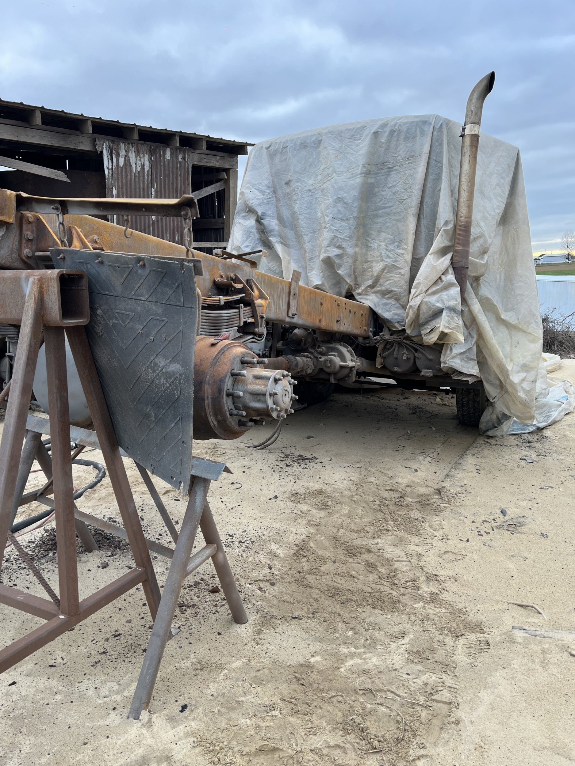

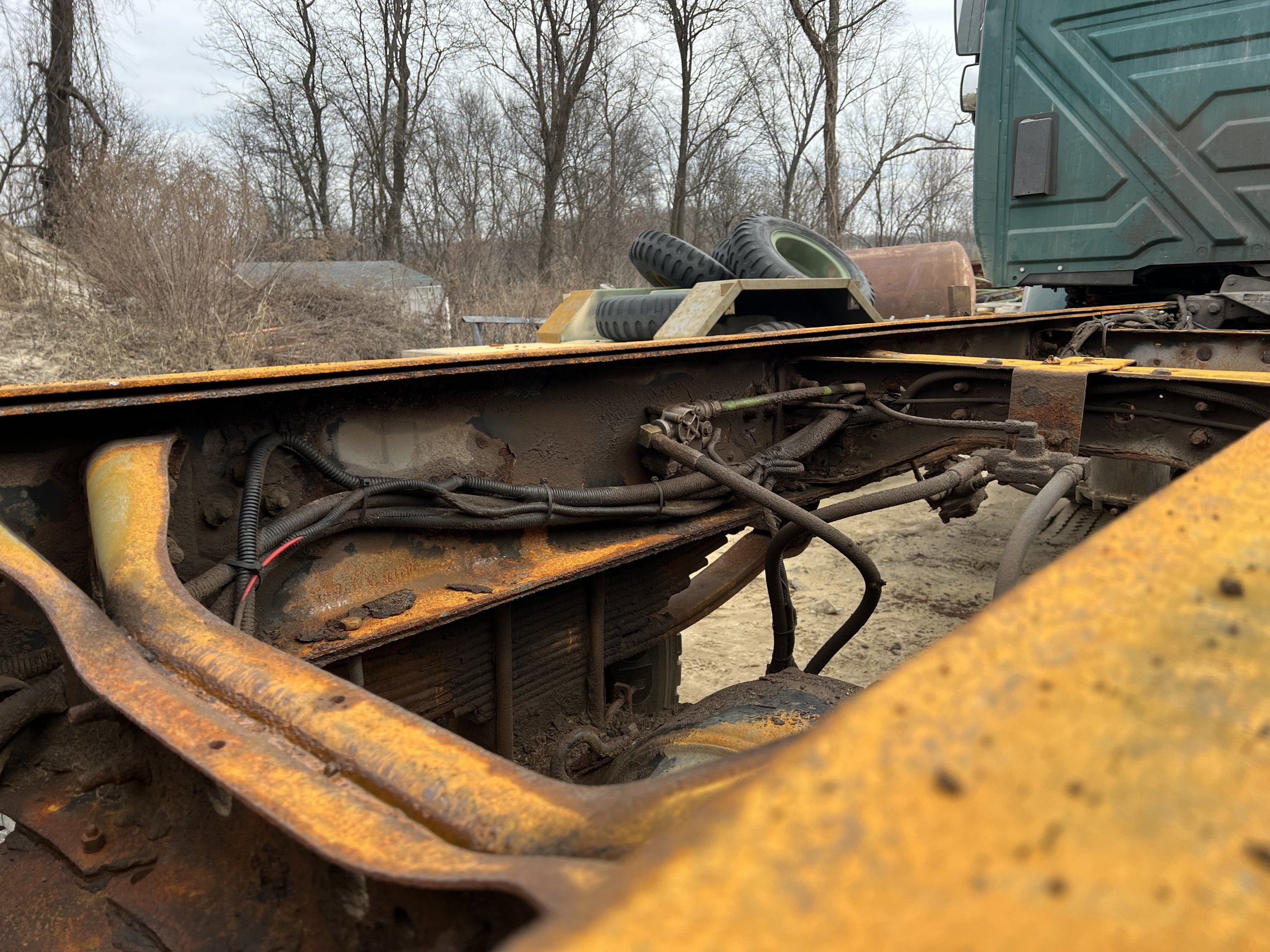

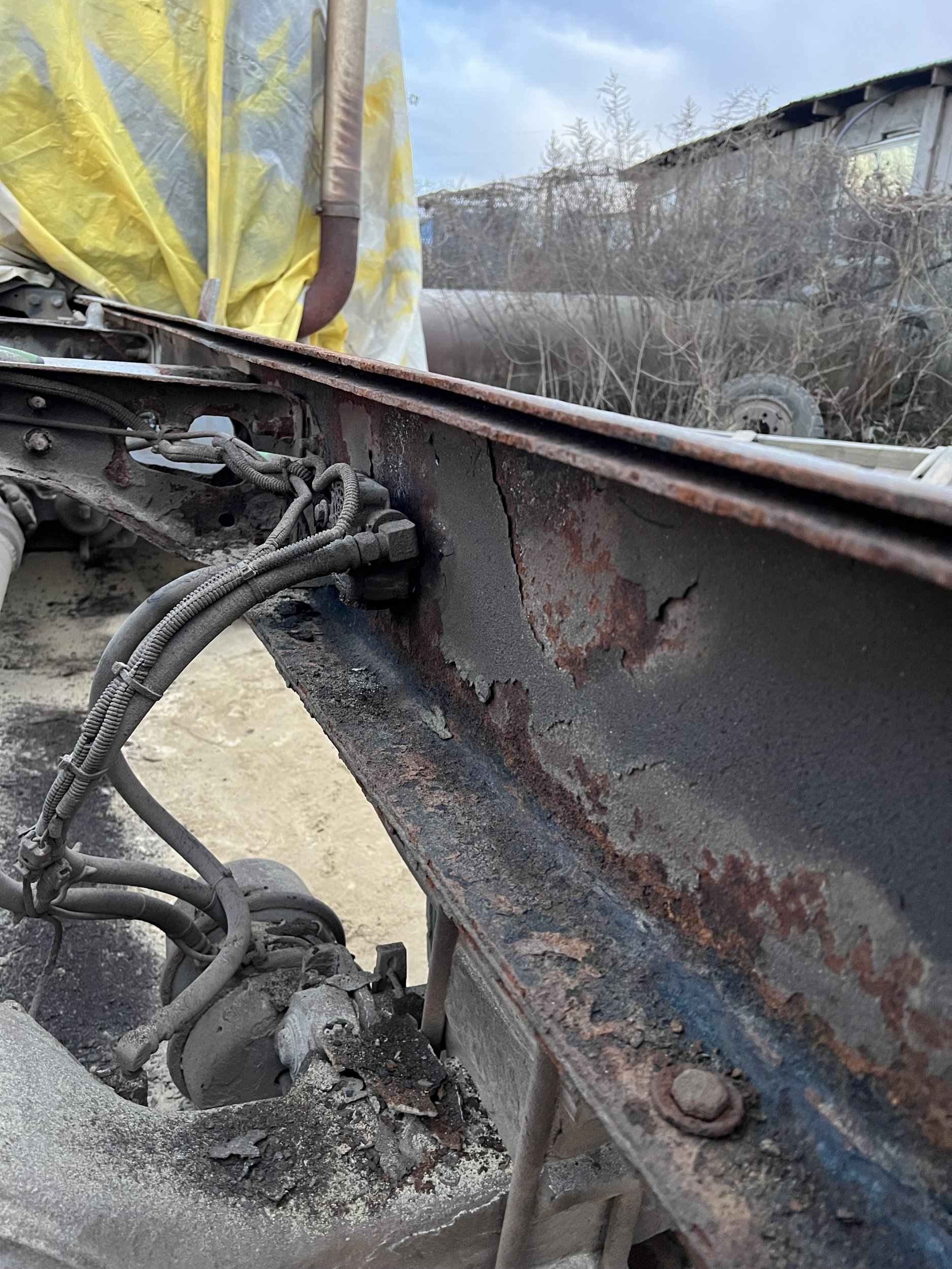

So the rear dual wheels & tires are removed and the frame is up on a stand now. I am cleaning out the tight, hard to reach areas.
Not sure whether I have the time & energy to clean the rust jacking out of the lower frame flanges, but I’d like to.
The tires are great, but the wheels are pretty well shot.
I am contemplating a steel inner and aluminum outer, just to give it a little shine once again.
Couple more days of this dirty work, and maybe finally get the rust converter on, then inside for paint.
Feels like it’s been forever.

When you’re done you can put a net up and play beach volley ball. It’s coming along nicely.

Lots of asphalt trapped in crevices.
