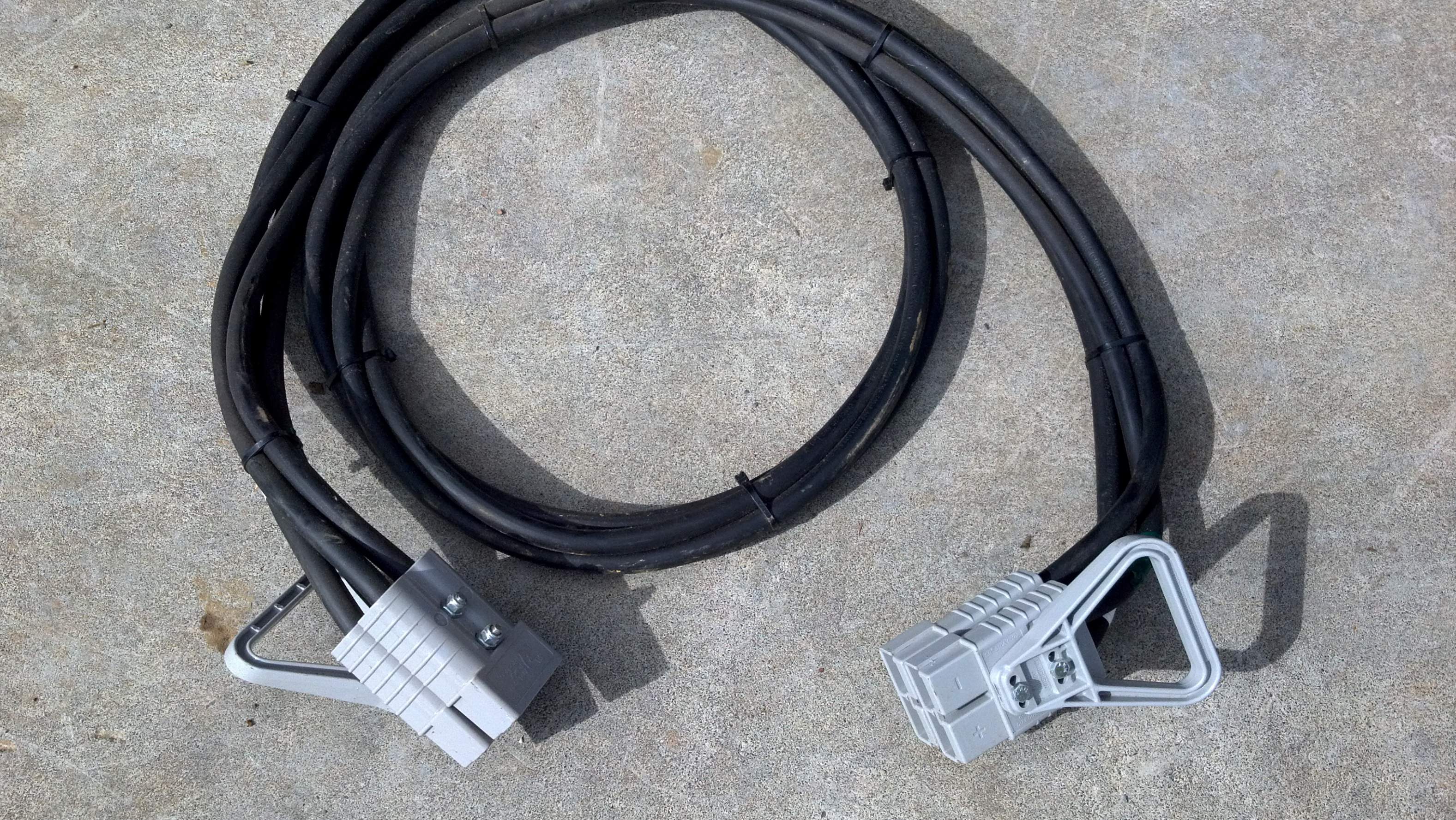

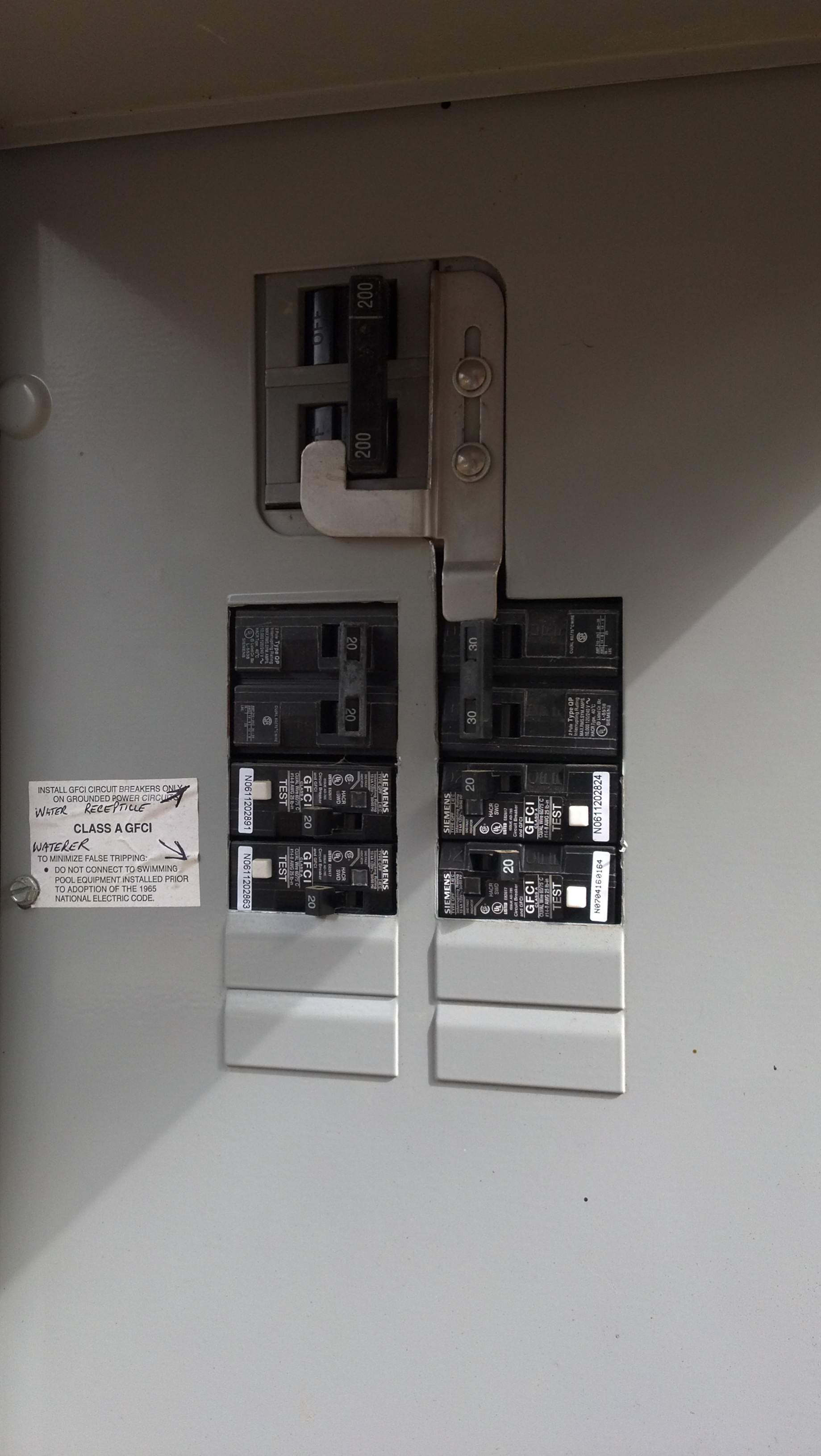

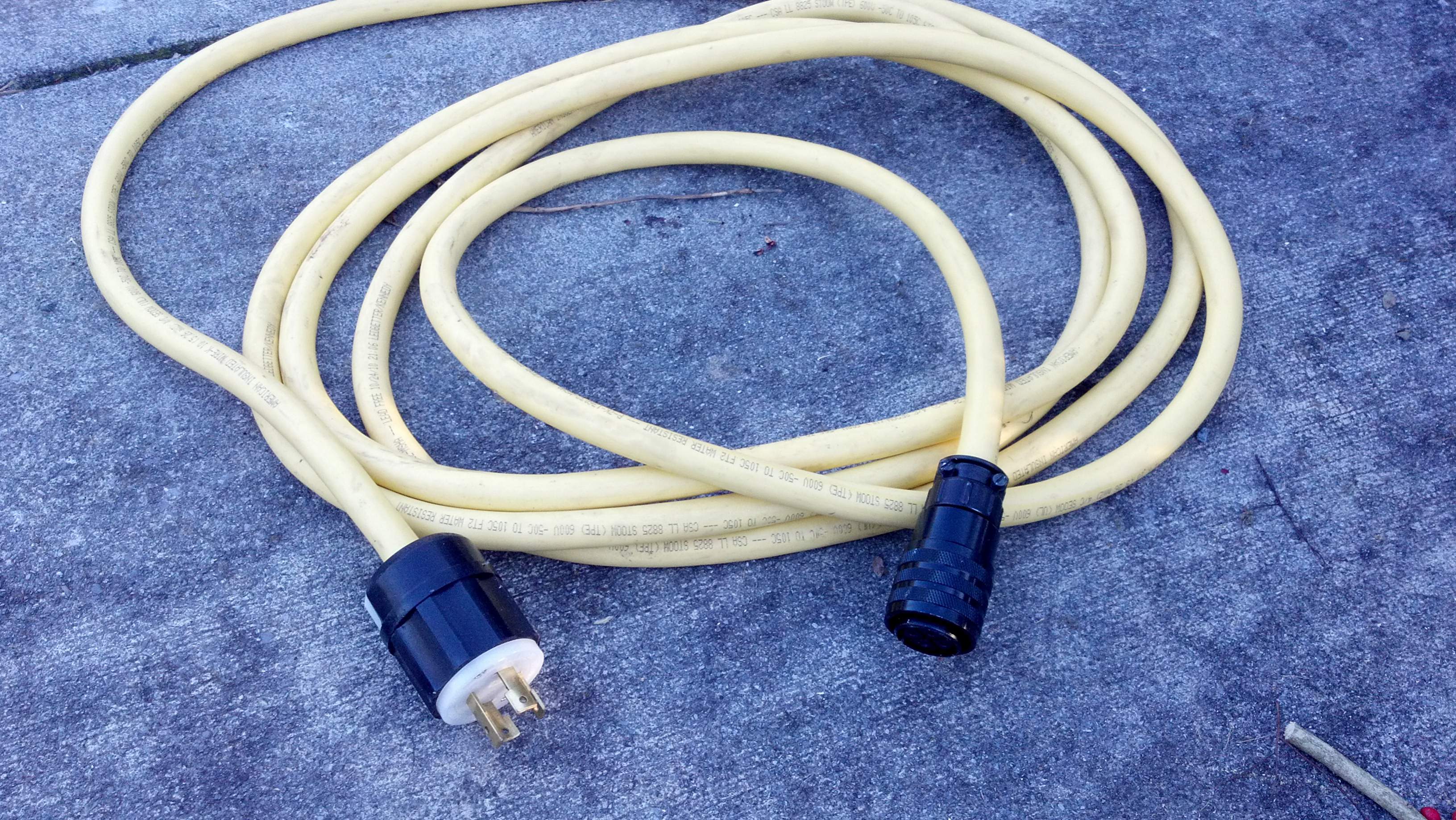

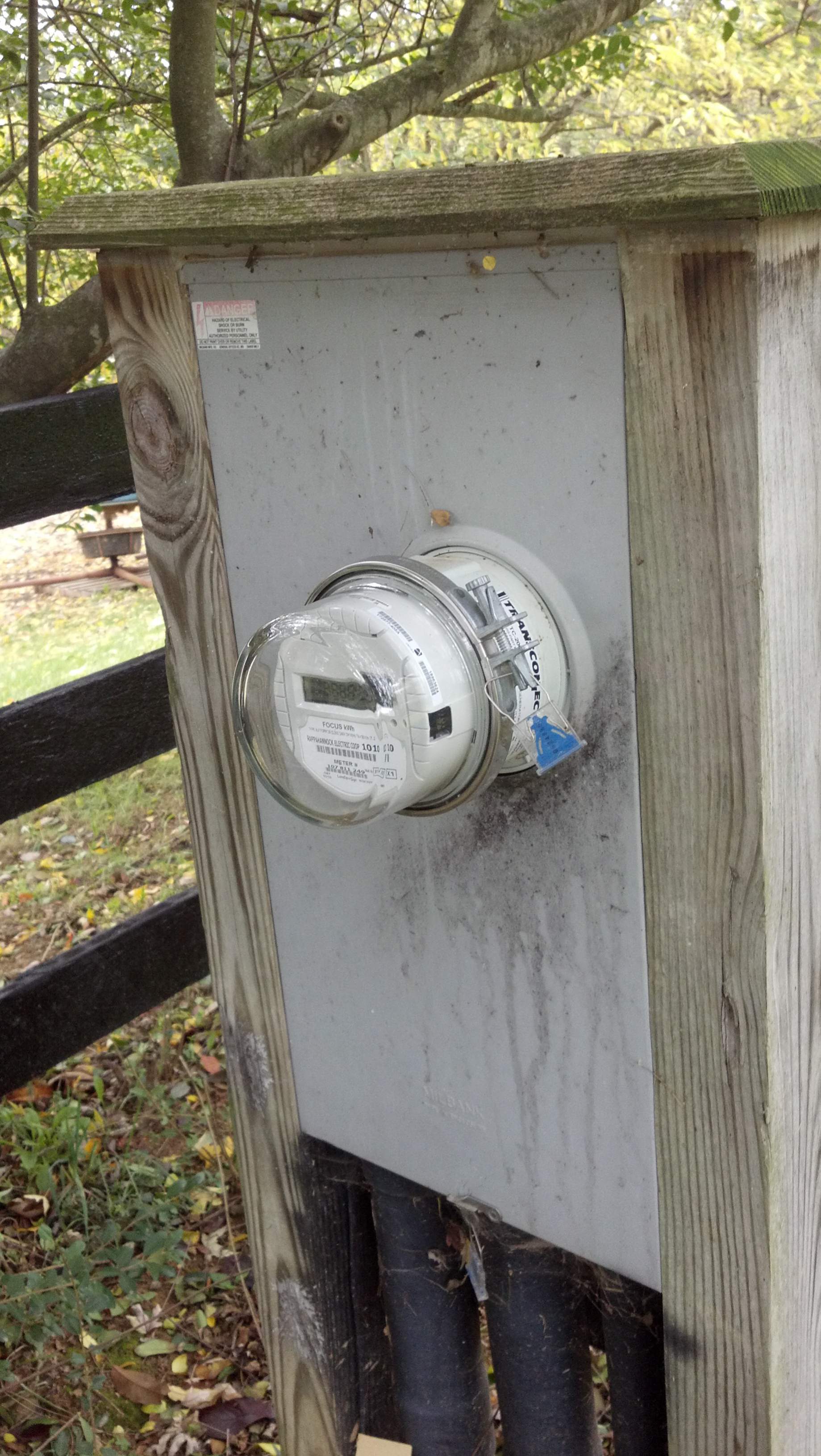

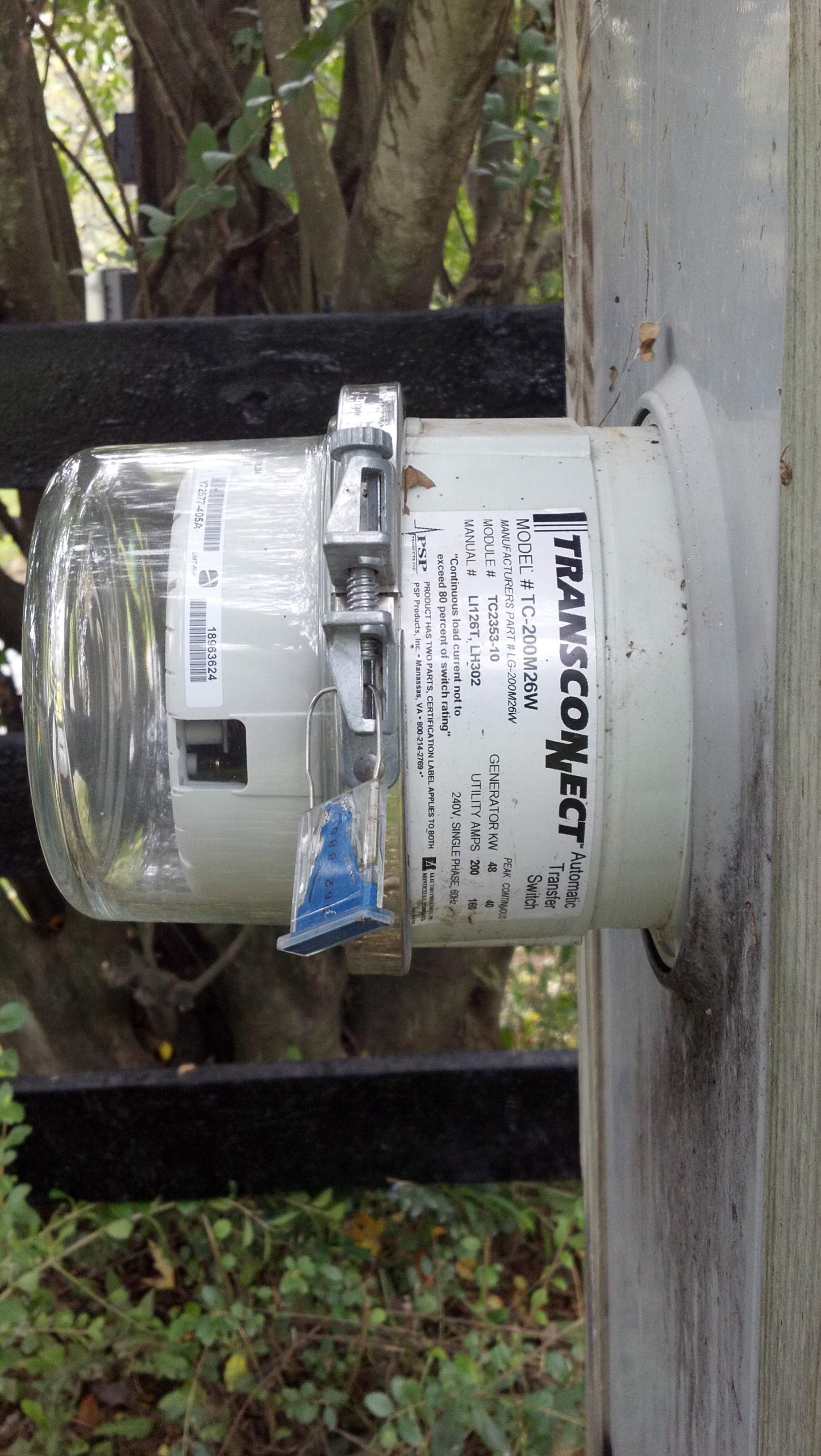

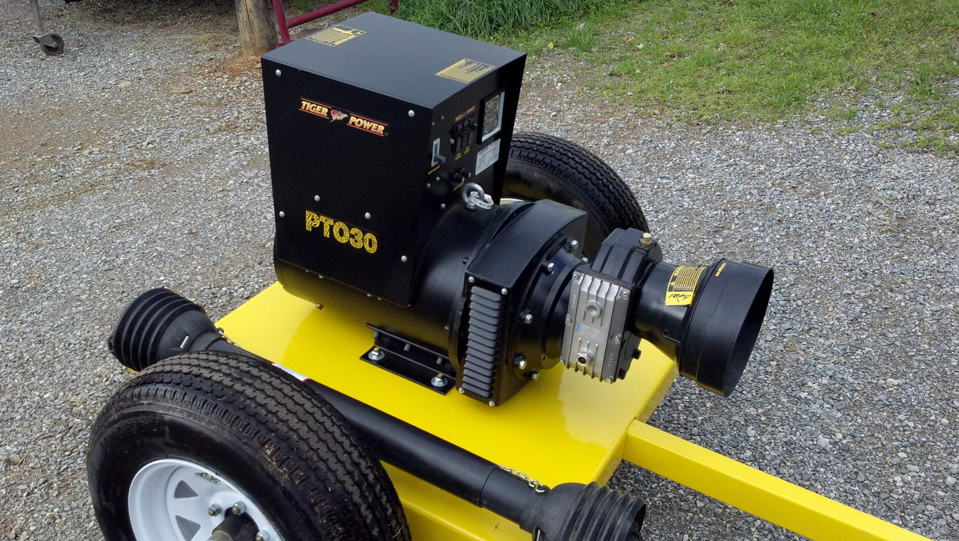

Howdy,

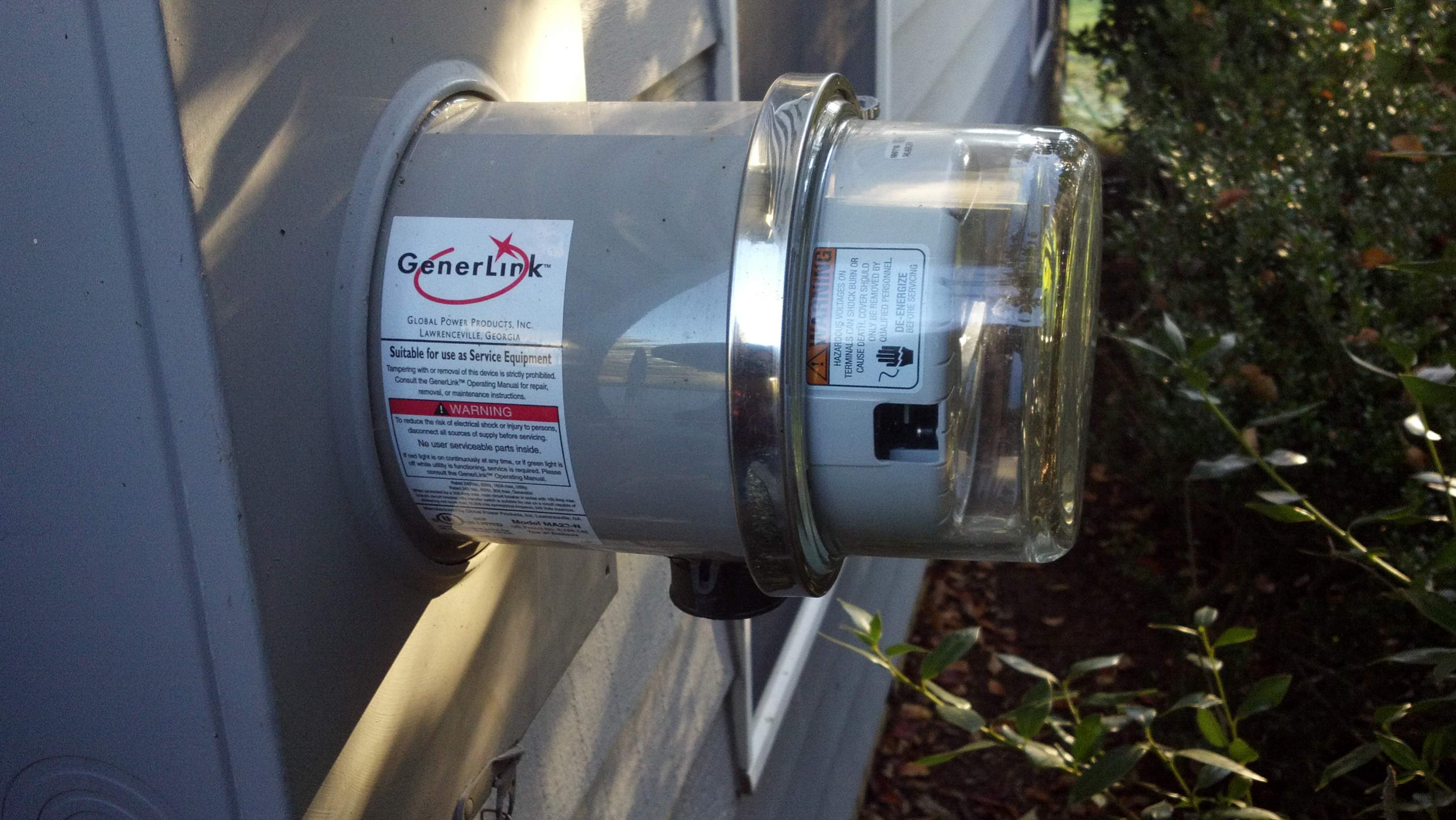

I have one and it works good. It's at a smaller gate house. I do not need to power lots here, well, hot water, each by itself. You simply monitor your own usage and breaker panel.
30amp connection installed in about 10 minutes.

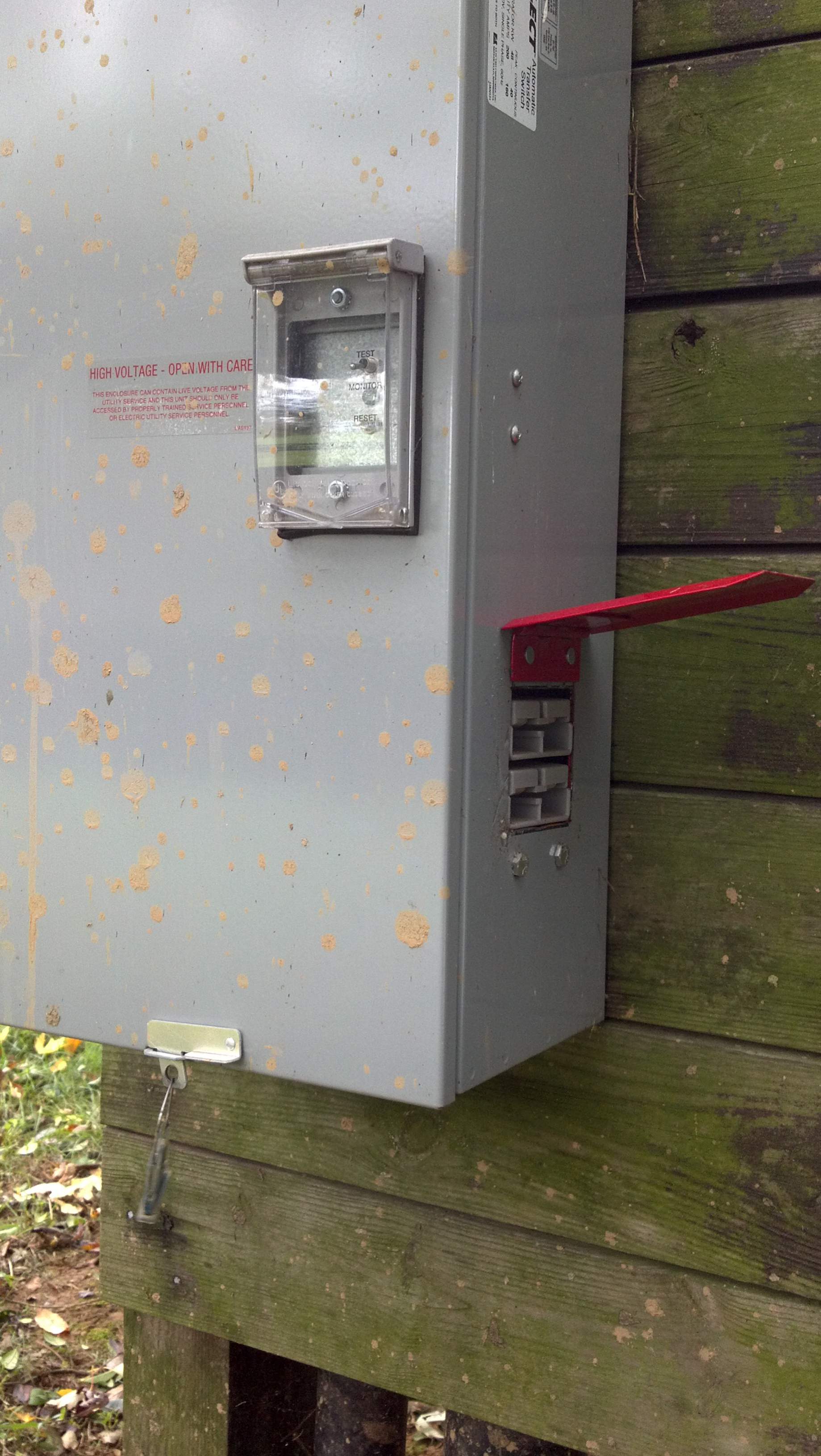

For a larger connection, I have a PSP Products Transconnect TC-200M26W (central farm distribution point) Tiger Power PTO 30kw feeds large house, well, barn, machine sheds, shop.
2011-10-20_13-39-35_968.jpg2011-10-20_13-40-48_549.jpg2011-10-20_13-41-54_608.jpg2011-10-20_13-42-22_52.jpg2011-10-20_13-56-37_654.jpg2011-10-20_13-59-14_40.jpg
All approved and installed by local utility (Rappahanock Electric Coop) Northern Virginia
and for a distant well, you can build it with a meter combo unit with a built in interlock.

This is the the best I've seen. I'm saving up for it. $500.00 for the unit and $1000.00 labor for the installation.
Honda Generators - HP2S Portable Power Systems: Basics
Are you sure of the price? That seems like a heck of a deal.
Generlinks are pretty good. Price really isnt that bad considering how much a proper transfer switch costs and the time it takes to install. The Generlink is Plug and play.
   / Bargain transfer switch instead of double male ended cord farmer fix #15
Good idea but local electric utility refused to install it.
Good idea is highly debatable and I fully understand why your local utility refused to allow it to be installed. Stuff like this has been designed and promoted by people who will never ever have to put their life or limb on the line (literally) if these devices happen to fail. As a Lineman with 35 years of service I can tell you that I would never have trusted anything like these units to guarantee that there was zero possibility of a back feed situation.
