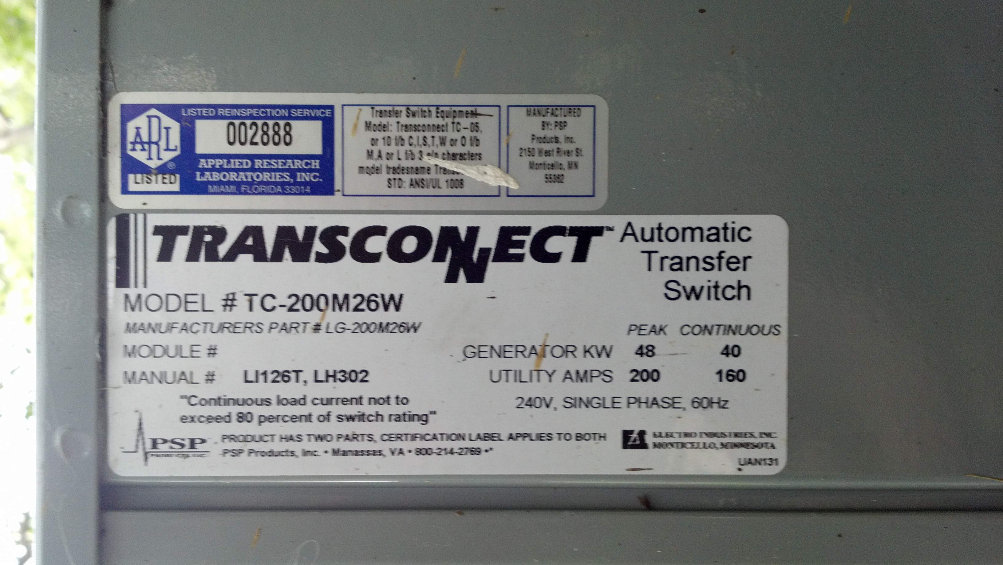

I had been searching online for generator hookups for my new 320 amp service, a work in progress in the past couple of weeks. Our local co-op offers the Generlink, up to 200 amps. Quite by accident I found a co-op in MO. that offers a 320 amp.https://www.crawfordelec.com/electricity-101/portable-generators I sent them an email asking if it will work in a standard 320 amp meter base, (already installed), and name brand, so as to present it to my local co-op and see if they will accept it's usage.
I had planned on stopping by the first of this week to check on it, but the huge windstorm that came through Friday night put a damper on things. Most of the state is under a State of Emergency,and a lot of power not to be back on until late this weekend. Some areas, 3 to 4 weeks. I'm just grateful mine was back on within 36 hours.
   / Bargain transfer switch instead of double male ended cord farmer fix #48
Howdy,
I was in the same situation. My local utilty is Rappahannock Electric Coop. I have 2 different units from them. The smaller unit is in fact a Generlink unit (30 amp model), and was installed in approx 5 minutes. The other unit is for the central farm distribution. 320 amp service feeding house, barn, shop, sheds, well. The product is from PSP Products and was installed by the local utility. Model TC-200M26W PSP TC-200M26W.jpg might be just what your looking for. My utility information page is REC Electrical Services. I am sure you could get the ball rolling with that information.
The other reason I went with these units was COST$$$$$
The overall cost is actually cheaper than any other method.

The 320 amp SemiAuto looks to be what I need. Now to see if I can get one...
