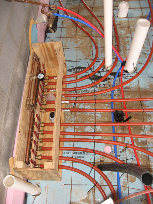

The below pics are not the best, but at least they are sumthin! I finally got the radiant to hold air pressure (forgot to tighten one connector I had taped off at "tightened and don't need to check again"...I am sure no one else has ever done that! I also put 1.5 inch foam around the edge to prevent lateral heat loss. I still have to clean up a lot of junk in there--ladder, tyvek, extra foam pieces, etc. There is also a pic of the main in slab manifold. The extra red and blue lines are the regular water lines. I still have to insulated the hot one. My concrete guy called but we are playing phone tag. But this time of year it should be easy to get on his list. I will update when I have more. Thanks for all the nice comments.
Also thanks to ALL on this forum. I have gotten a huge number of ideas and help from searching many old posts. I am very actively thinking of going solar hot water to heat this thing. That way I do not have to put in a gas line nor pay high commercial electric rates. And since it is a barn I don't care what temp it is as long as it doesn't freeze. I can work in there at 35 degrees with no wind or if it gets too hot I just open er up.
Peter

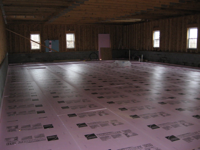

I was "clerk of the works" for a new highway garage and fire dept bldg,.both went up at once, and both were modified metal buildings,. On both, they were required to place 2" foam all around the edge and under each door and overhead doors, The overhead doors were 14 X 14's. THe 2' foam laterals make all the difference in the world especially under overhead doorways.,

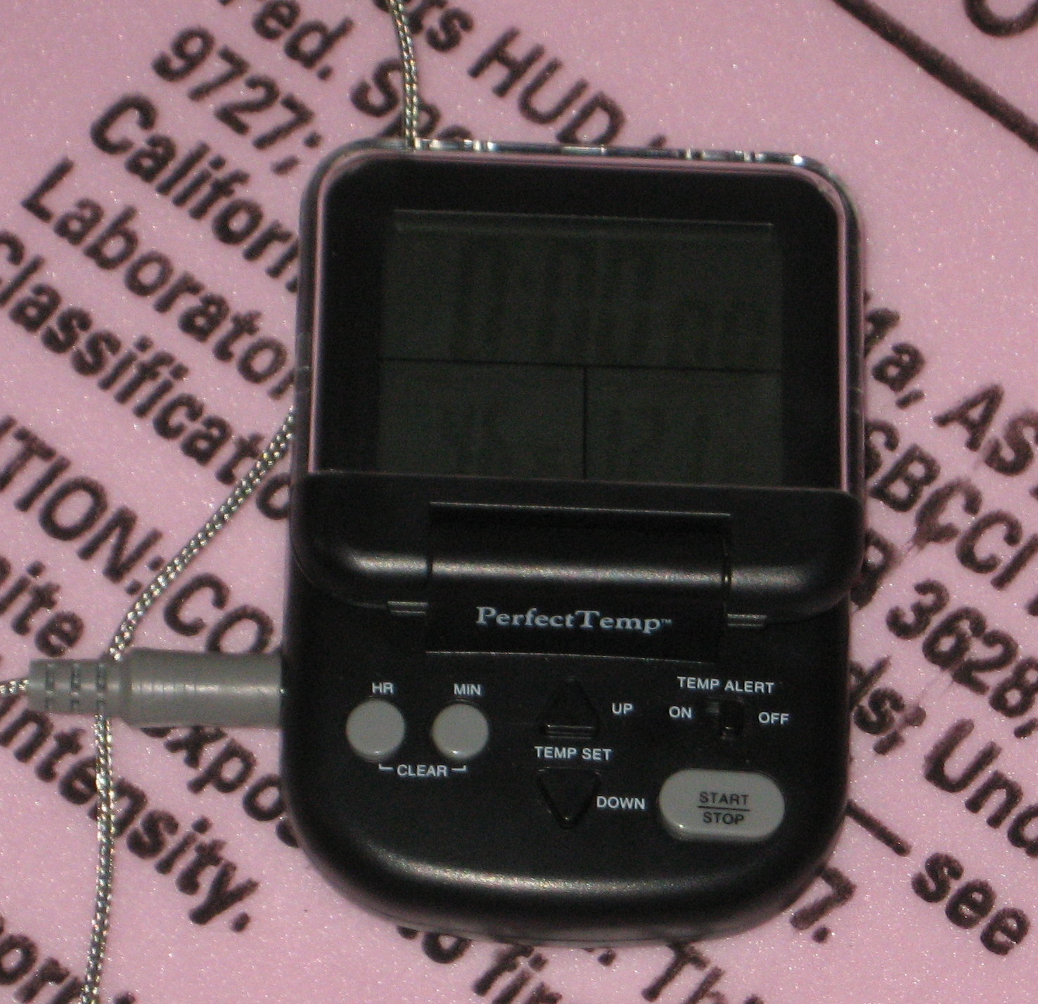

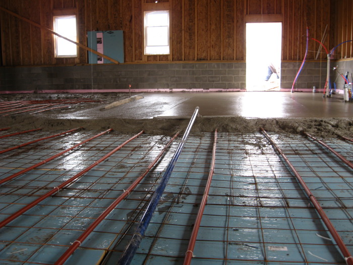

I did post similar pics under a differrent concrete question...but I will post here also. Maybe I shoud have kept a single thread but the concrete question was specific...and might help searches by others in the future. It is still slow go on the barn. Lots of other projects seem to prevent me from ever getting out there...and it is dark at 5 now.
I have a pic of the concrete being poured (pumped actually). You can see that it is well over 4"...and actaully closer to 6" in many areas. That will just be better for me long term. They had not pulled up te WWR/PEX yet-but I still think it is in the lower third of the slab. After the concrete was poured I then covered with all the foam. I will use that foam as part of future insulation anyway. The slab went down to about 345 degrees in spots but them came baack up the 56 degrees. It is now 11 days after the pour and the slab is at 46 degrees...I think I am doing well.
Peter
