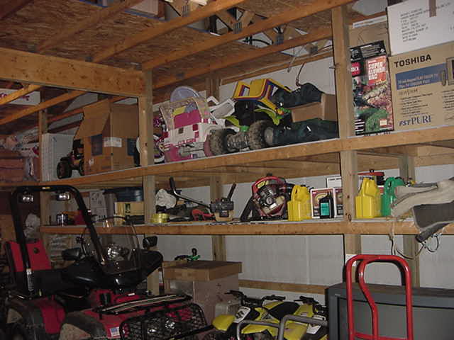

   / Barn/shop layout #5
Paul,
This pic shows one of the walls of shelving. The opposite side of the wall has the same type of thing but only on the upper side (workbenches below).

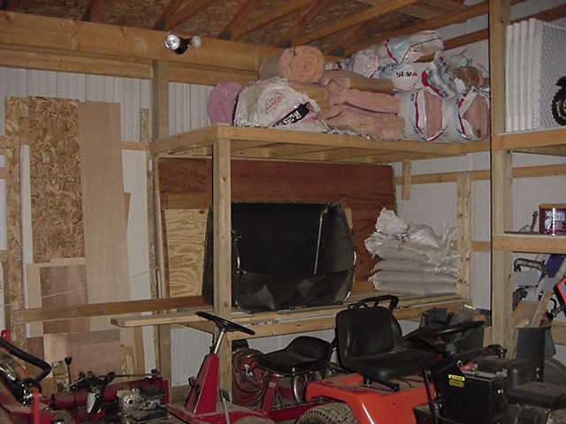

   / Barn/shop layout #6
Here's a pic of the 2 layer shelves.
Also, I forgot your design. If you have rafters like I do, I put some plywood in the center to store light stuff.

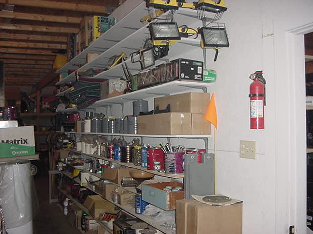

   / Barn/shop layout #7
Same set of shelves looking from other direction.

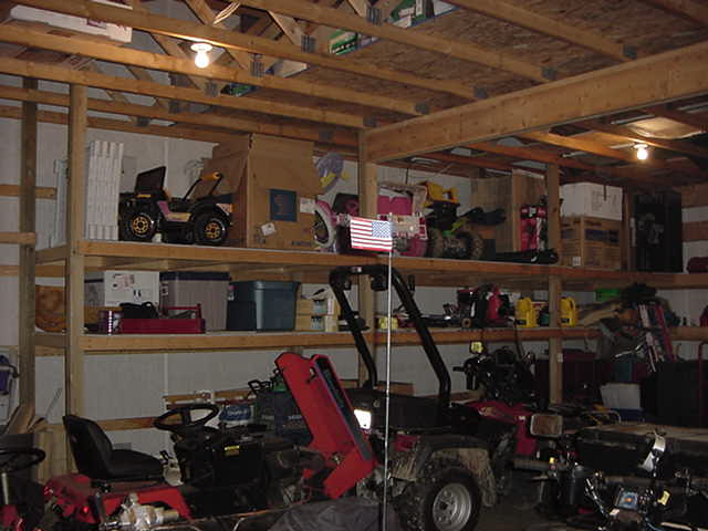

   / Barn/shop layout #8
Last pic.
Wood storage shelf. Not much in it now /forums/images/graemlins/frown.gif
Note the motion detector above it. Behind my right shoulder is the big door. Light comes on so I can see my way around when I return after dark.
