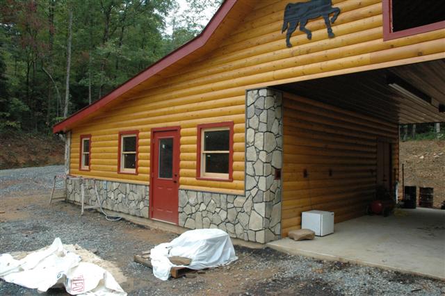

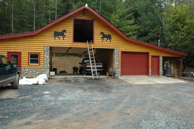

I just finished an addition to my barn and changed the siding to Spruce Log T&G and stained it with Sikins Natural Oak. Came Out nice. I put OSB over the studs and then Tyvek vapor barrier. You could use Tyvek over the Cedar T&G and then your new finish boards.
See attached two pictures of the finished look.
/ Barn siding help #16
One more picture.
This siding really goes on nice and give a rustic log look. Trims out nice in 2x4.
