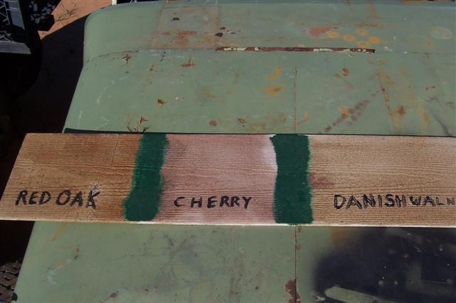

Here's a picture of some wood stains that I put on a piece of Hardi lap siding. This sample failed pretty bad, but shows what the it could look like if I had something better.
Right now, we're really liking the look of Minwax Gel. It's designed for metal doors and other non pourous materials. It dosn't mention Hardi materials, so we're experimenting with three differen colors, plus a Gel stain from Olympic.
I also have concrete stain by Quikrete and everything else from oil based paints mixed with thinner, to Walmart paint thined down.
The Hot tub gazebo that I'm building is also going to be where I run my trials. When we decide on what to try, we'll use it on this Gazebo and keep track of the results.
My ultimate goal is to be able to build some one bedroom cabins with the Hardi lap siding and stain it to make it look like wood. If I can find the right product, I'll have the ultimate cabins. no maintenance, no bugs, no fire and no rot.

Thanks, I liked it allot too. The problem is that all the wood stain faded away in the sun. I was thinking it would wash off with all the rains, but it made it through one of the wettest years in history. What killed it was about two months of summer sun.

From what I've been able to find out, Hardi needs a special type of stain. Regular wood stains don't work because they must penitrate into the wood. That's impossible with Hardi priducts, so it's just a matter of time for the stain to wash away.
Hardi says that a 100% Acryilic stain is what you are supposed to use on there products. Home Depost sells this in a variety of colors, but in my test sample, it comes out like paint and doesn't add anything to the grain in the Hardi boards.
I tried a variety of paints, from oil base to exterior latex paints mixed with water and thinner. The paints all came out looking like really bad paint jobs. :mad: :D
Minwax has some Gel stains that are designed for metal doors and other solid materials to make them look like real wood. They are designed for indoor and outdoor use. I bought three colors of the Minwax, and one from Olympic. I don't know of any other gel stains, so this was about all I could find. Cost is $12 a quart for the Olympic and $13 a quart for the Minwax. It only seems to come in quart sizes, so it's gonna be pricey.
The colors in the picture are Honey Maple, Antique Maple, Colonial Oak and Aged Oak. There realy is no comparison for us, we're going to use the Aged Oak and see what happens.
