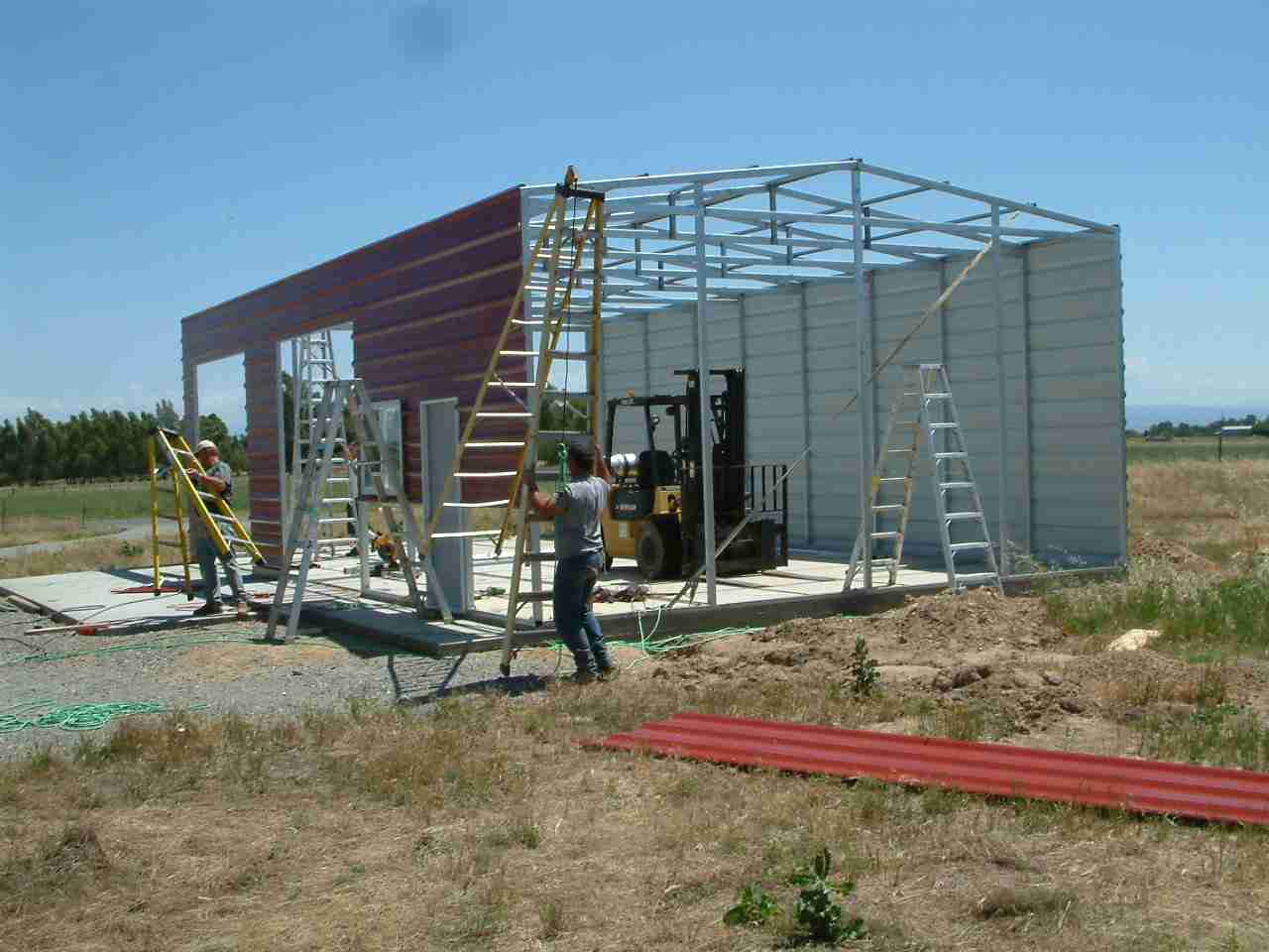

Last June I had a steel pole frame garage/shop built (see attachment for construction details)
24'x42' slab with 12-ft walls
two 10'x10' roll up doors
one 36"W man door
one window
6" thick slab with criss-crossed #4 rebar in the slab on 24" centers both ways
Price: nearly $24K.
Don't know what kind of steel building you're planning, but $12K sounds low. Care to share details on this structure?
To answer your question: you bet my garage/shop is overflowing, in less than a year of use. My solution is to build (eventually) a 3-bay tractor shed in an open space in the almond orchard. Probably will have one bay with a concrete slab and the other two with roadbase gravel. I like to park my implements on dollies that roll around easily on a concrete floor. Makes hookup to the 3-point hitch a lot easier.
