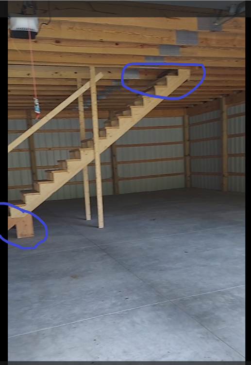

I'll ask the new contractor (To be determined) if the stairs can be relocated to the back and support poles used in the middle.

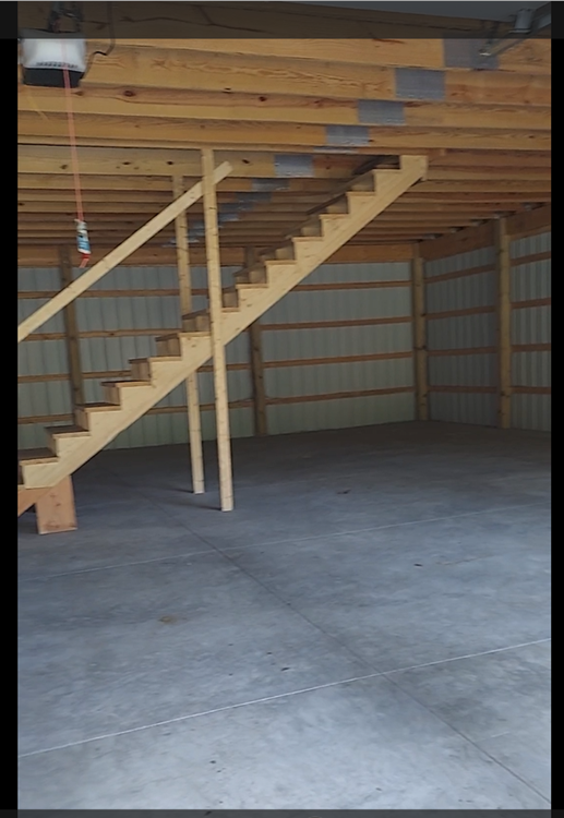

It looks like all the floor joists require additional support. With the "mending plates" all lined up it looks like you could have one failure easily cascade.
Are the mending plates nailed in or just dependent on their "teeth"? If the latter my first thing to do (and soon) would be to go around with nail gun and put some nails in each mending plate.

Your 'joists' appear to be the bottom chord of engineered attic style trusses. The plates are offset because a 14' + 16' board gives your 30' span, no problem. It would be nice to see the truss design document, so that the supports, spacing, etc. could be checked. Sometimes, intermediate supports along the truss are specified, sometimes not. Would the town inspector have them on file? Assuming they are properly supported, the design floor loading would probably be 20 psf or more.
I'd be more concerned about the stair opening. It appears one or more trusses were cut and altered, which would put additional stress on the adjacent trusses. I think you said this work was done after the inspector passed the installation, he/she wouldn't probably have accepted it.

The toothed "mending plates" hold the ends of the loft's floor joists (?) together. They are the only things connecting the long boards together across the 30 ft. width. And they are all (with a few exceptions) in a straight line from front to back. They aren't in the middle, they are offset by 1 or 2 feet. I was wondering if the two different board lengths were supposed to alternate each time, so the "mending plates" are offset from the adjoining ones and there wouldn't be one long straight weak point for the full depth of the building (40 ft.)?
You definitely have some things that need to be addressed, but those are not one of them. Those are not "mending plates", they're truss plates. Those trusses were designed that way. You do not need additional support underneath them, unless you intend to put some sort of extraordinarily heavy loads on the second floor.

Is there any tags on the trusses identifying manufacturer. You might chase that down for how the trusses were planned and maybe a design drawing. Drawing would have floor loading and additional on site bracing etc required. I have similar attic trusses in my building, but it is only a 16 ft wide attic. My bottom cord under the 16ft room is a 2x12, plated to 2x6 or 2x8 going to the eaves. Attic has 5ft knee walls. Roof slope is 7/12 pitch. Jon

Are there metal anchors on the posts, or did they set the posts in concrete? I don't see any metal brackets on the back door pics, so I assume set in concrete. the back door can be made taller, I'd put in some sort of overhead door. Looks like pretty heavy roof trusses. Did they cut any to put in the stairs? If so, that is a big problem. Normally if there is a stair opening like that, there are double trusses on either side. From the picture it looks like they cut a bottom cord and moved it sideways to put in the stairs. That is a major screwup. The bottom of the stairs looks like another screwup.

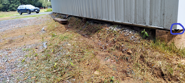

this hole, where they did a piss poor job of installing the rat guard, should give you a peak at the post / pier intersection. Posts in concrete would be better than using the simpson standoffs, in my opinion. but that part was probably inspected. I assume by the space under the slab, the slab is poured on top of the piers. Id get some gravel put down and under the slab edge where it's like that. take some CR and pack it in with a digging iron under the slab, then fill 1-2 ft away from the wall so it won't erode.

I would just add fill where ever you have erosion issues and add a gravel trench on the drip line to handle the soil erosion. If water drainage is an issue then you could easily add some drain tile to move the water to where it isn't an issue. As has already been mentioned, I would also pack some gravel under the slab where it needs it.
I like your desire to move the stairs to the rear of the building and to repair the cut truss/trusses.
I can't say for sure but to me it looks like the trusses were designed for a second floor. Maybe talk to a trusted engineer on that one. I'm pretty confidant that you will address the safety railing issues etc for the second floor.
