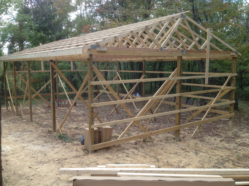

Made some pretty good progress this weekend working in the BEAUTIFUL weather we have been enjoying. Another day of work or so should have it ready for trusses and a roof.
Lookin' good. Now is a good time to take corner to corner measurements to check for square at the top of your walls. Maybe stretch a mason's string along each edge to check for any wander in your walls. Getting it true at this stage avoids a lot of hassles later.

Dave, Yep. The building is going to be the new home for my tractor and implements. And thanks for the advice on verification of walls and corners. I took great pains to assure that the BOTTOMS of the posts were exactly positioned, but a lot of imperfection can occur over the course of a 16' 4x6.

Yep, poles can be an approximation of true :) The sooner you get them all pinned together, the better. I hate it when they begin to warp and wander soon as they get in the sun.

Finally making some progress on the project...
Hope to have the roof on by next weekend.

Looking good! Are you going to back fill and bring the floor area up level or just leave it as it is? I had an old equipment shed one time that was almost 3' higher at one end than the other it worked out pretty good cause I had one piece of equipment that was real tall that would fit in the lower end like it was designed that way.

As soon as I get the roof completed and can remove the bracing, my plans are to get in and around the structure with the box place and reduce the grade somewhat. My intention was to have some degree of grade but I didn't realize it was as great as it is until I began setting the posts.
No plans to pour a concrete floor because I am way out in the woods and don't believe a concrete truck could make it in. I may however put gravel down at some point. Priority now is just to get a roof over the tractor and implements before the snow flies!
