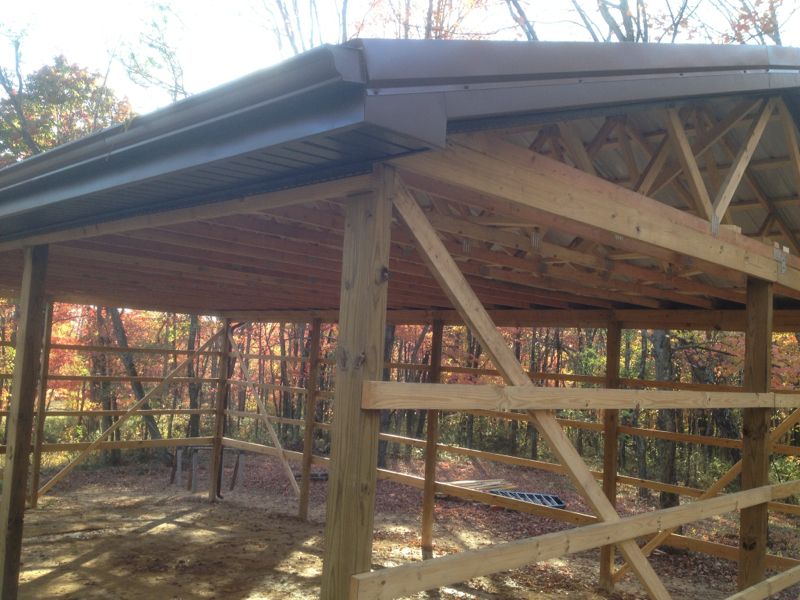

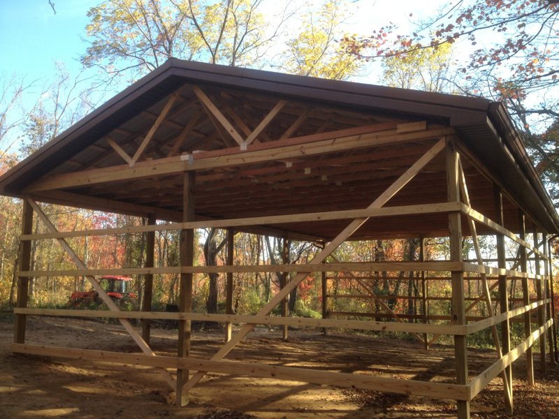

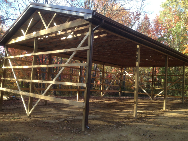

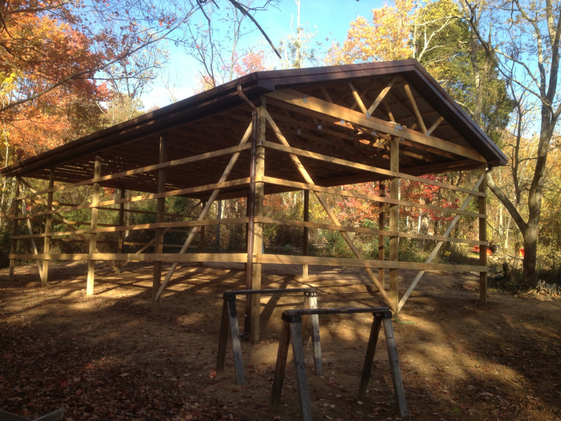

Finally! The initial construction phases are complete! Now I can relax and enjoy some hunting and get this baby enclosed and finished at my leisure.

Nice job. I really like your soffit job!!!
Eddie
   / Barn under way (not under roof!) #25
Wow. Really nice job on the roofing/soffits/gutters. Isn't some of that going to be a pain in the butt to work around when you try to side and finish out the barn though?
#26
No Deezler, should be a piece of cake. I have J-Channel installed already all the way around the top.
   / Barn under way (not under roof!) #27
I saw that, but meant more like where you have the downspouts coming down the posts, but I guess that's easy to r & r.
What color siding are you going with? I like the dark roof.
#28
I put the downspouts together with screws so they will be easy to disasemble. I have plans to capture the rain run-off into a 300 gal. poly tank and then gravity drain into an old U/G sistern located nearby since this is way back in the woods with no water available, but that is a project for next spring.
Siding will be a light beige color. Three of the "bays" will remain open and the fourth will have a wall installed to separate from the rest and a sliding door mounted on a rail.
Thanks,
Dave
