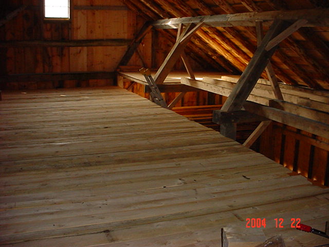

There's the difference, post and beam versus stick built. I have a 3rd floor in my barn that it 12 feet wide by 14' tall if I recall correctly. Eventually I will lay down plywood off to the two sides of the 3rd floor for more storage space.
Mornin Jim,
Yep, that would be my dream to own something like that :) And then have it planted about 75' to the right of my Vt house might be more than the old heart could take :) Thanks for the pic!!!
