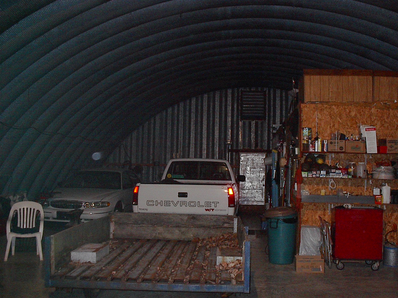

IM001529.JPGI don't know how old you are or how long you will live there but you may not want the up stairs later on in life . This is a picture of my dads place in the summer just a little apartment he went south in the winters.
