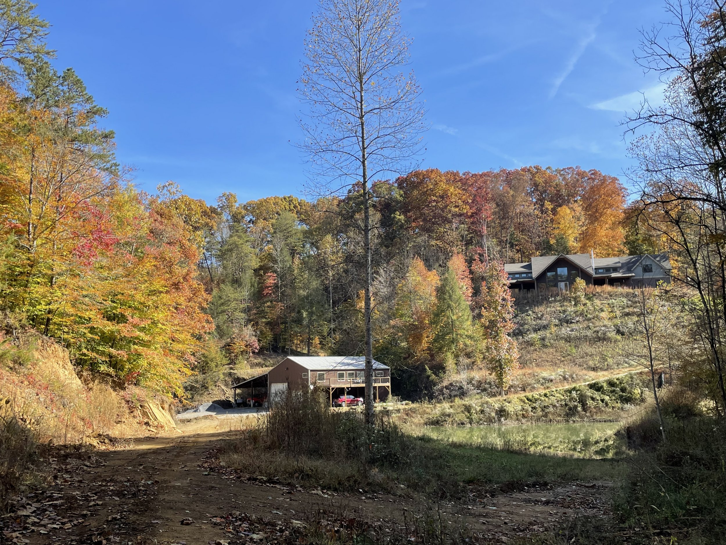

Moved to TN 110acre mtn. farm at 67 (2007) - no liveable bldg. Built a 40 x 50 steel bldg. with one side having a 20 X 50 1 bedroom barndo. Built it 1st class & we lived in it until 2018 when we moved into 4400 SF house 100 feet above. Just the 2 of us & we loved it. Use as guest house or rental now & in process of adding another room over the back 18' of the other 1/2. Have a 10' 8' rise OHD under living section & 16' 14'rise at other section, plus a walk door. Made provision for elevator.
Also added a 40 x 50 lean to on one (left)side for machinery/stuff storage--not attached but roof of barndo drains onto it.
Very nice place.
