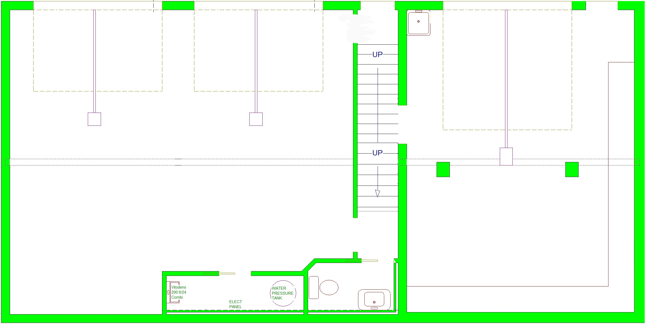

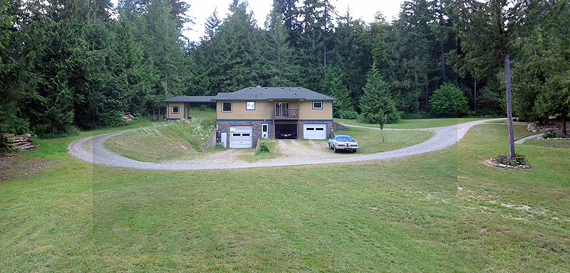

I'm 80 and have a 1250 square foot home (25 x 50) on top of a 1250 square foot three car garage built 20 years ago into a slope for ground level walkouts all round.
Two things I have that you are going to need eventually; handrails on both sides of the stair case plus a toilet and sink two piece bath room on the lower level.
Just sayin' 🤔
BTW, those are 10 foot doors.
Just sayin' 🤔

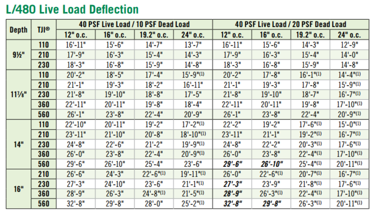

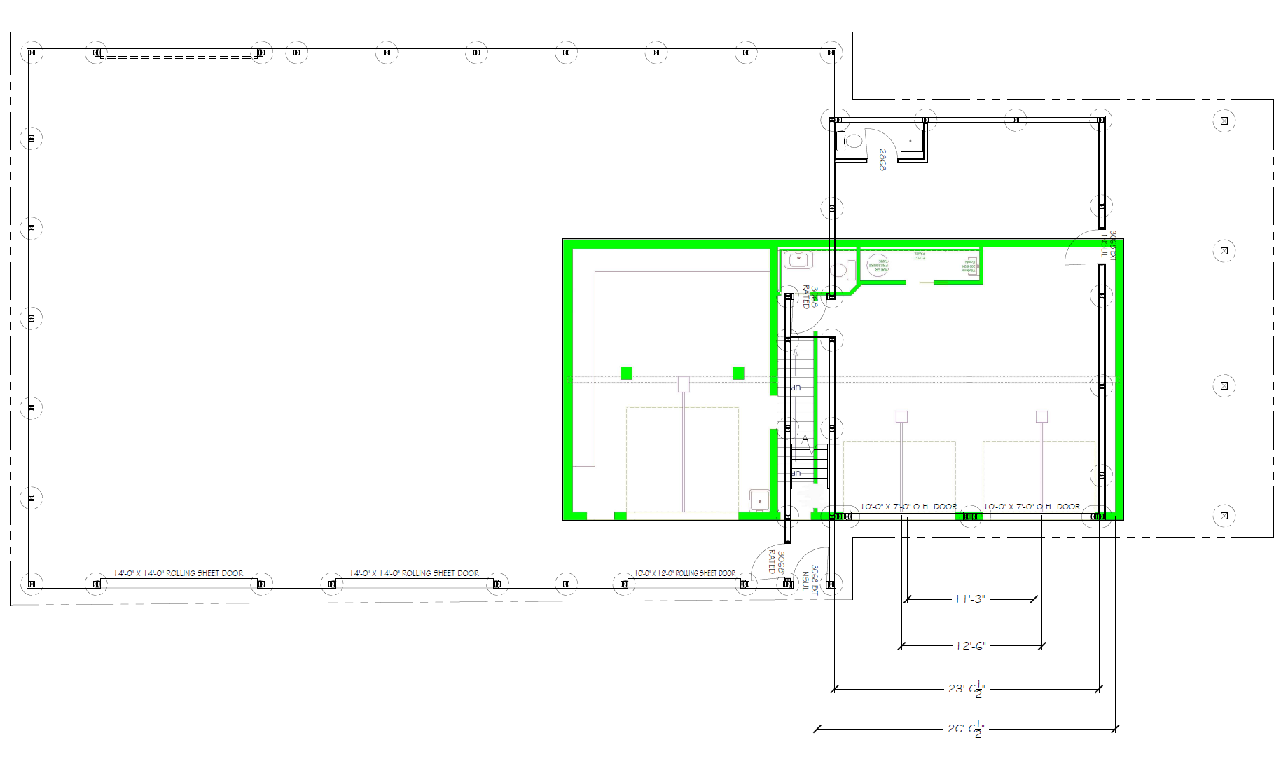

I overlayed our floor plans. Looks like your door spacing is about 15" wider, and overall the inside of your garage is about 3ft wider.
Do you have work benches & shelves on the inside of the garage? The plan is for mine, just parking, no clutter. I have the rest of the shop for benches, shelves, toolboxes, etc.

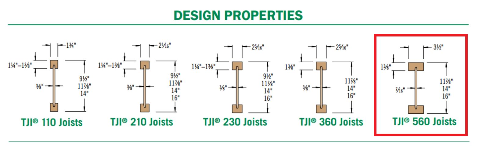

If I make the garage wider I might have to move from 14" tall I-Joists to 16" tall, losing headroom. I don't want any columns inside the garage, want a clear span ceiling.
Right now I have designed in 14" (TJI-560 from above chart or equivalent) @ 16" O.C. I may be able to add 3 ft width to the garage (one section of steel siding) and put the I-Joists 12" O.C. I'd like an overperforming floor and not reach the max span of these joists per the chart. I don't want a bouncy floor in the living area.
Just sayin' 🤔
Nice house. Love the design.
