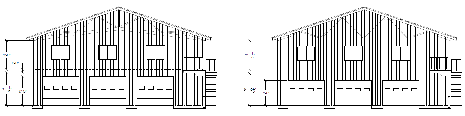

What is the advantage to 8 foot tall garage doors? Seems like a huge expense making the entire building taller, and paying more for 8 foot tall doors over the standard 7 foot tall doors.

In the OP's case he simply made the hole larger, not the building. I totally agree with that philosophy. All it cost him is the additional cost of the door size. I had two 7x9 doors in my previous house garage. I hated them. But in that case I didn't have a choice. When we built this time we calculated in larger doors. The wife's attached garage door is 8x12. Much more comfortable to use.

Not that much change required for 8ft doors. Seems like a no-brainer:
I wasn't paying attention to the inches in the two drawings. It looks like the overall height of the building is increasing just a couple of inches to get the 8 foot tall doors. Not as big of an expense as I first thought.
But I still don't see the advantage to spending the extra money on 8 foot tall garage doors

Again, in the OP's case all he did was redraw the door openings. This is based on his comment and his drawings. So in his case, why would he put in smaller doors?
I thought Moss gave very good reasons.

The overall building height didn't change. I moved up the floor for the living space which made those celings less than 8 ft, so I put in scissor trusses to gain taller ceilings in the living area.
