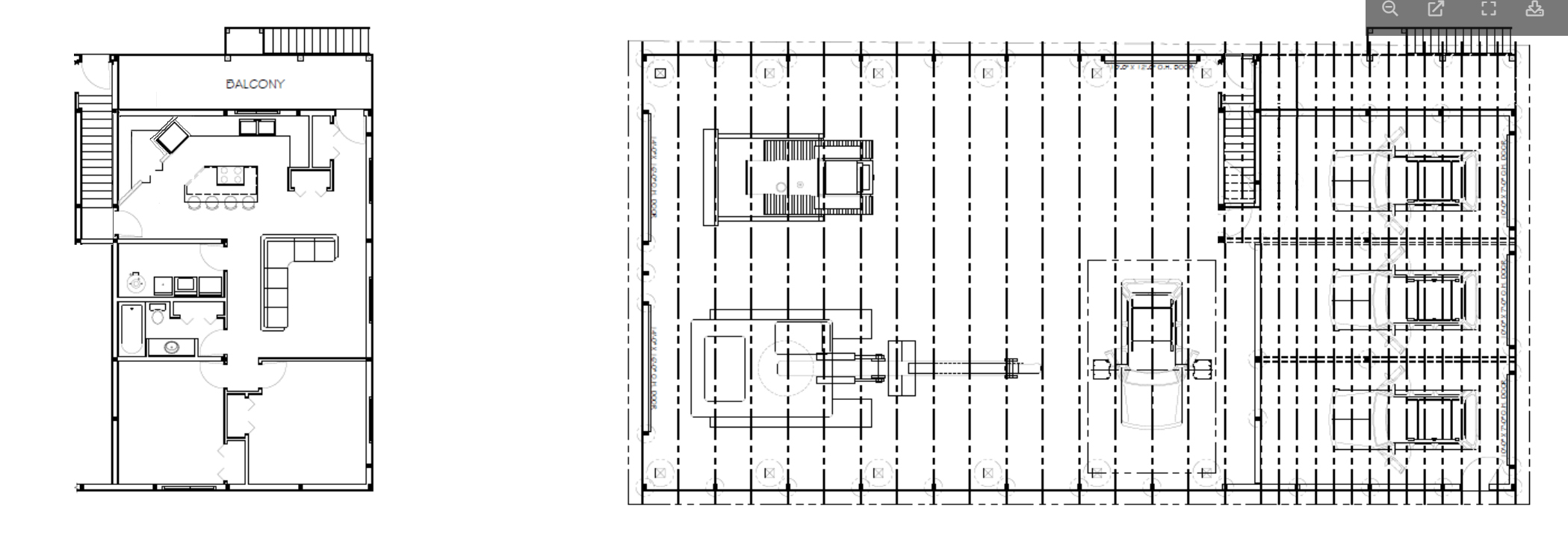

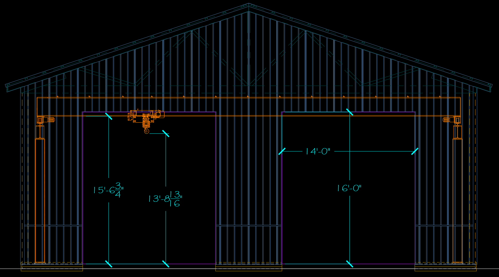

Laying in a 5 Ton Bridge Crane:
Normally the crane columns are tied into the wall columns of the building for anti-racking support. Not sure this can be done with a wood post & beam frame building? Normally these are installed in steel buildings.

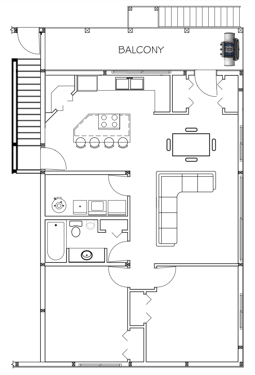

When I saw you fantastic crane I got this crazy idea while thinking of the difficulty of moving your furniture upstairs ...

That closet arrangement does look better. I was not a fan of the way I had the door to the balcony all the way in the corner.
For the stairs I didn't have a door like you show because I wanted to pull the wall back toward the north and have a removable railing for furniture moving. However a door for the stairwell might be a good idea to further isolate the shop from the living space.

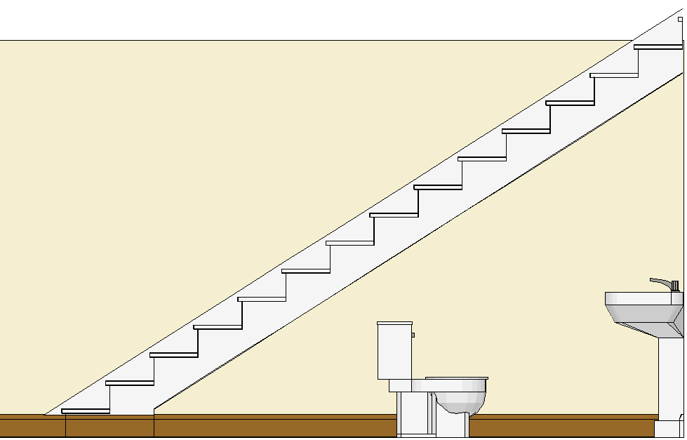

I figured if I took the stairs out of the well and put them on the east wall of the shop you'd have more room to sort things out 🙂
   / Barndominium/Shop or "real" House? #198

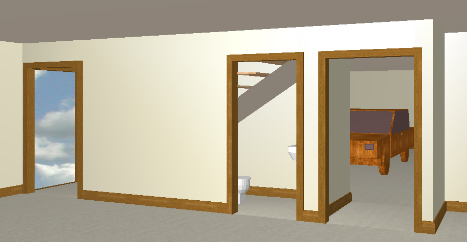

Still need to put in the shop bathroom.
A toilet and sink would fit nicely under a relocated stair case on the east* wall of the shop and tie in easily with your existing plumbing.
*I said north wall but I think it's east.

I figured if I took the stairs out of the well and put them on the east wall of the shop you'd have more room to sort things out.
Yeah, my design started out that way but I moved them in to reduce the square footage. Taxe$$$$...
