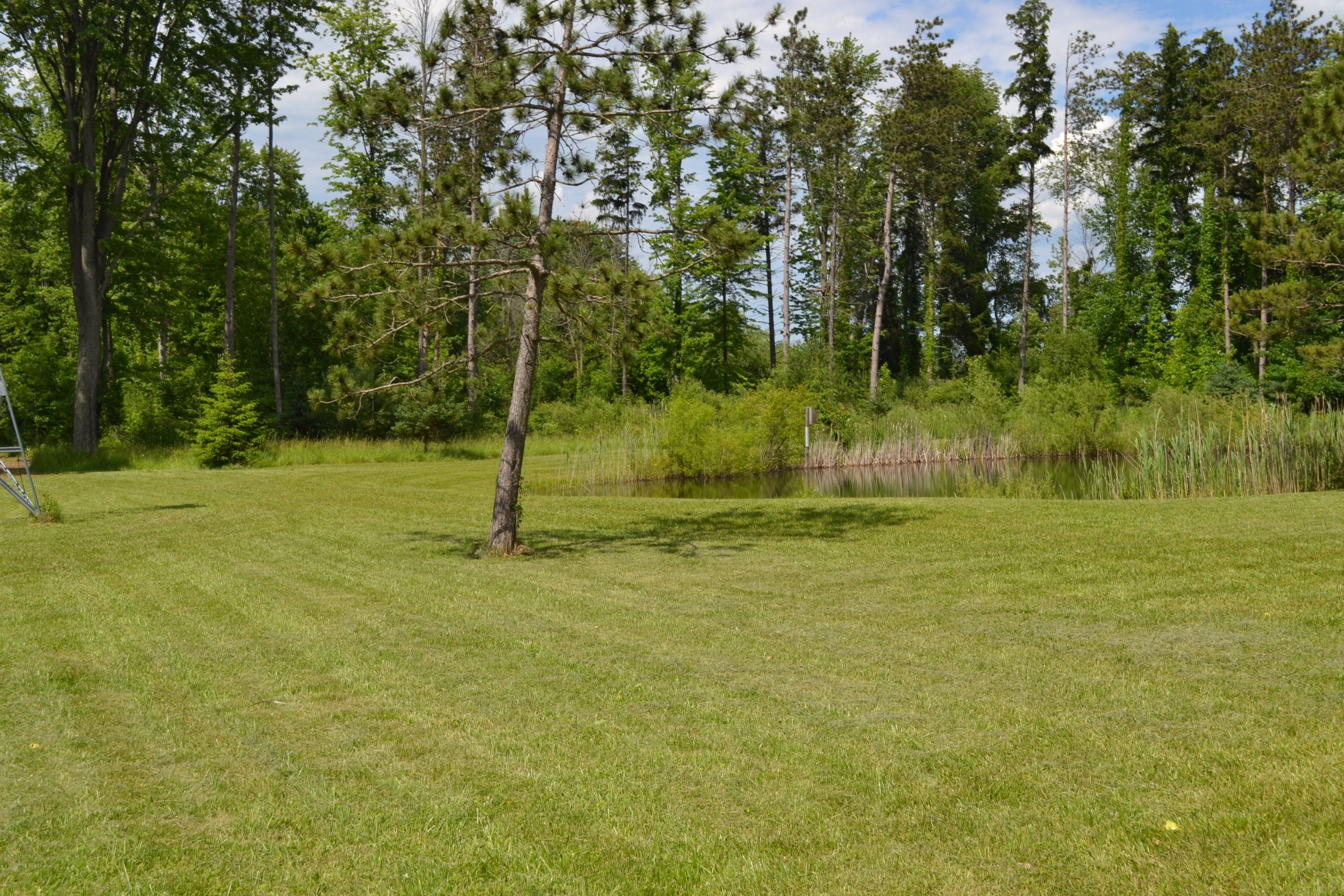

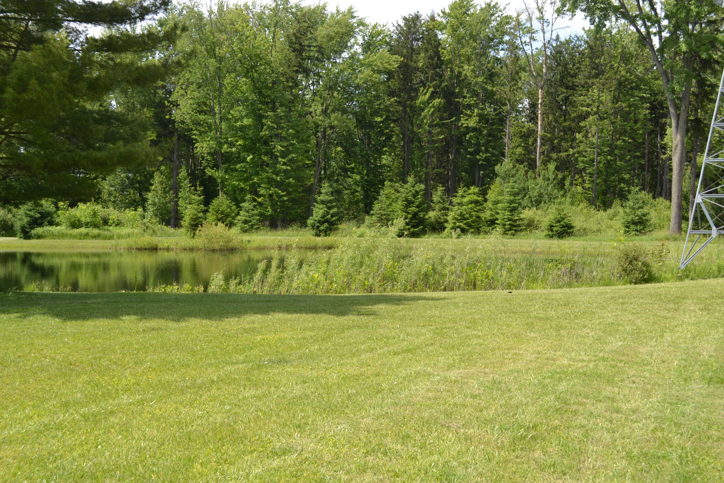

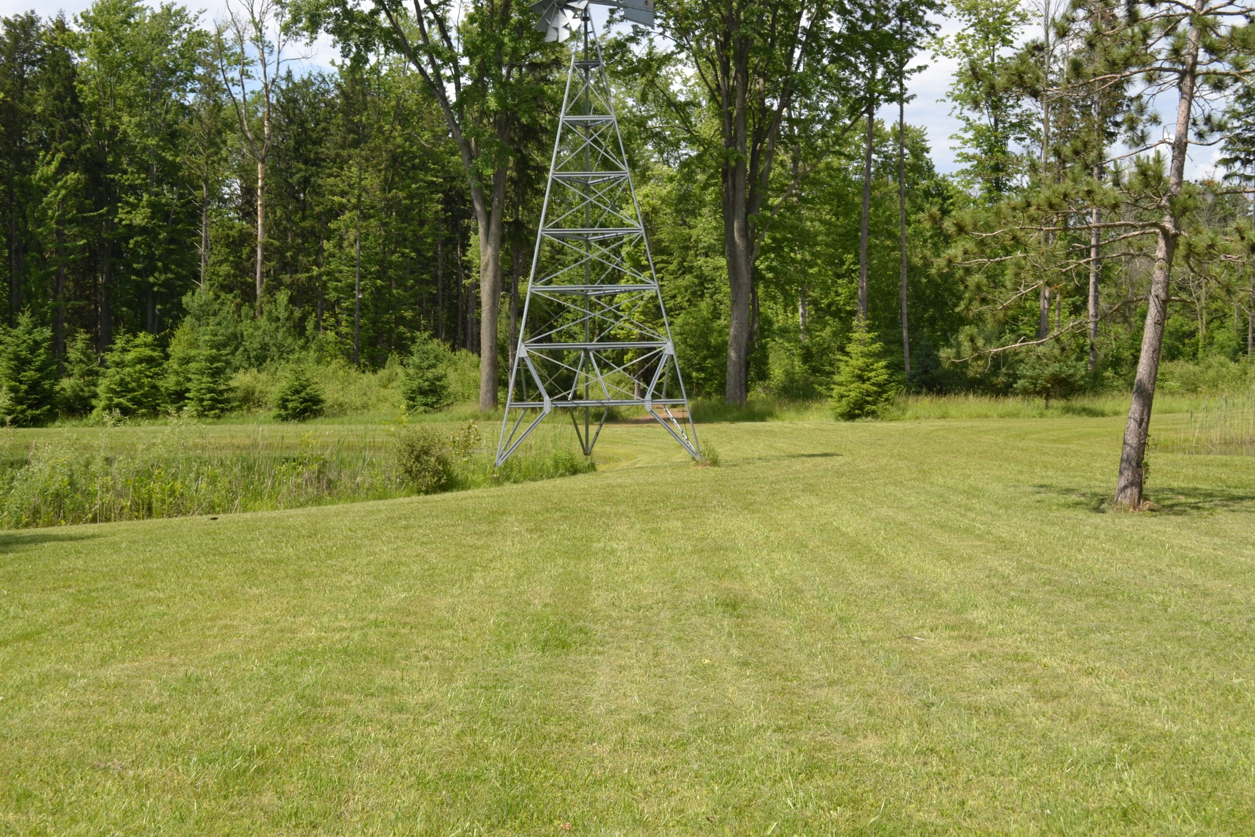

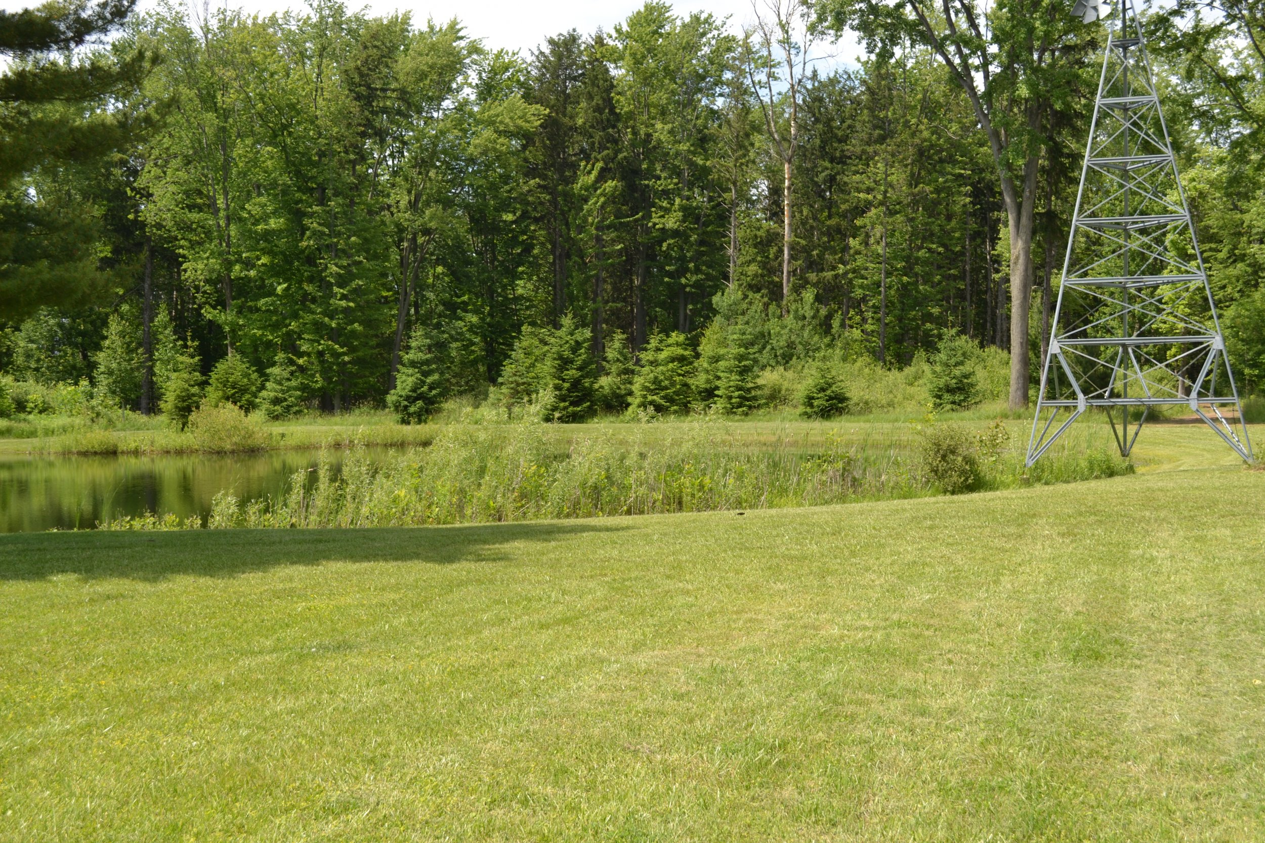

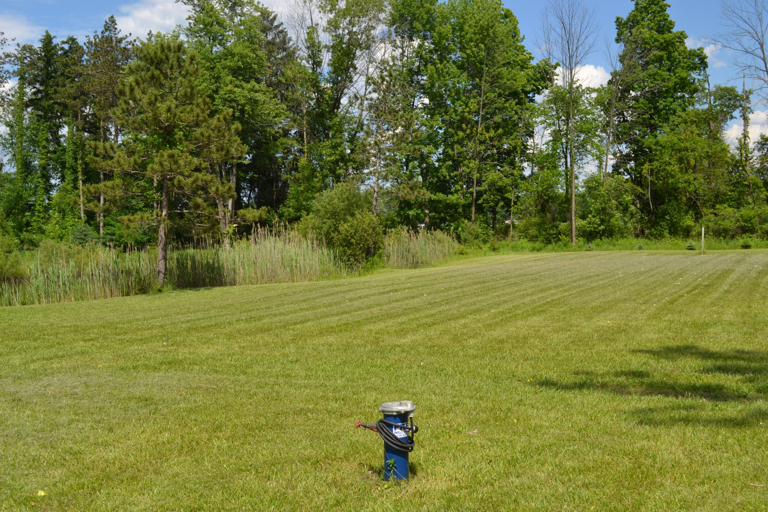

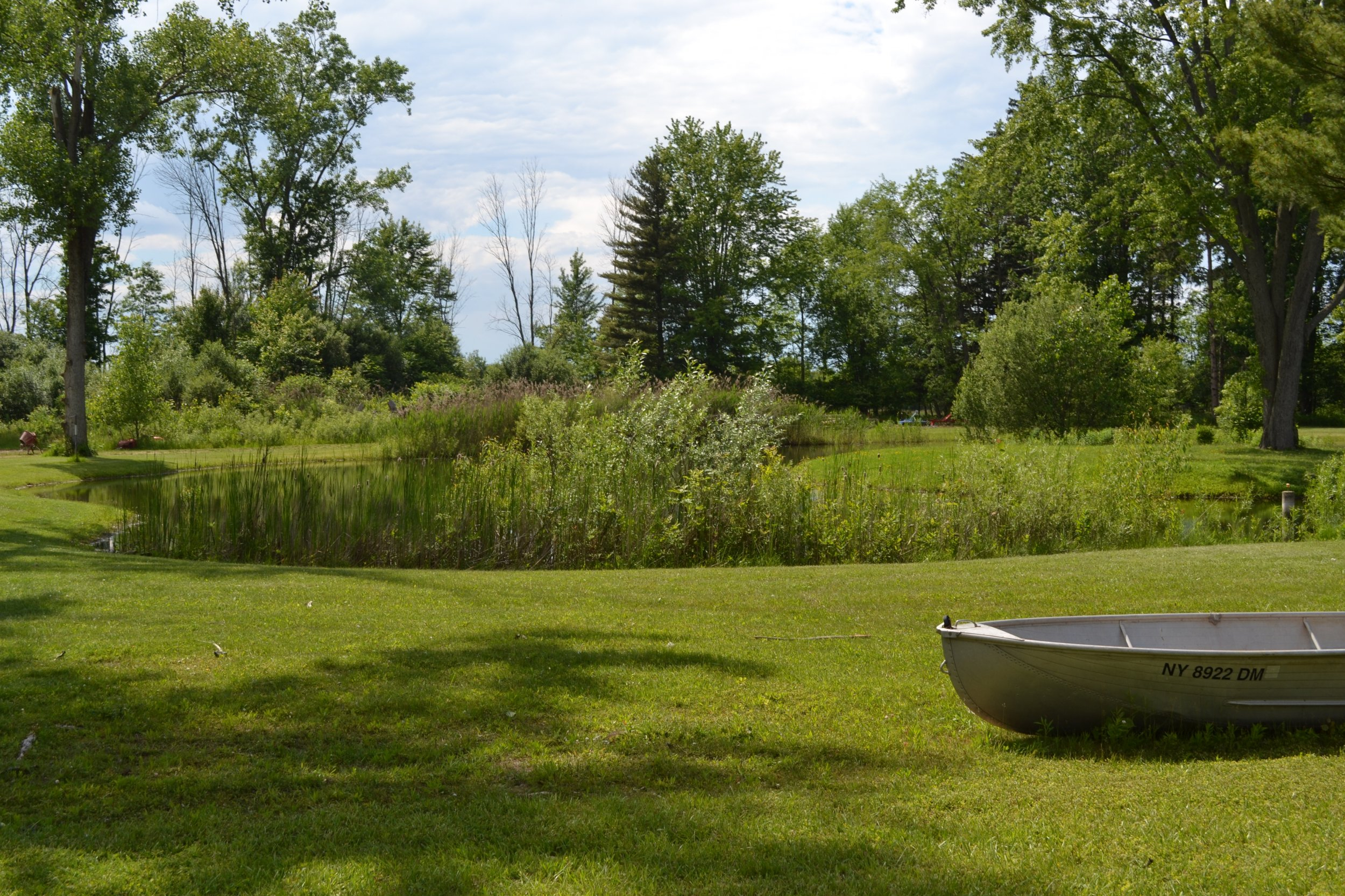

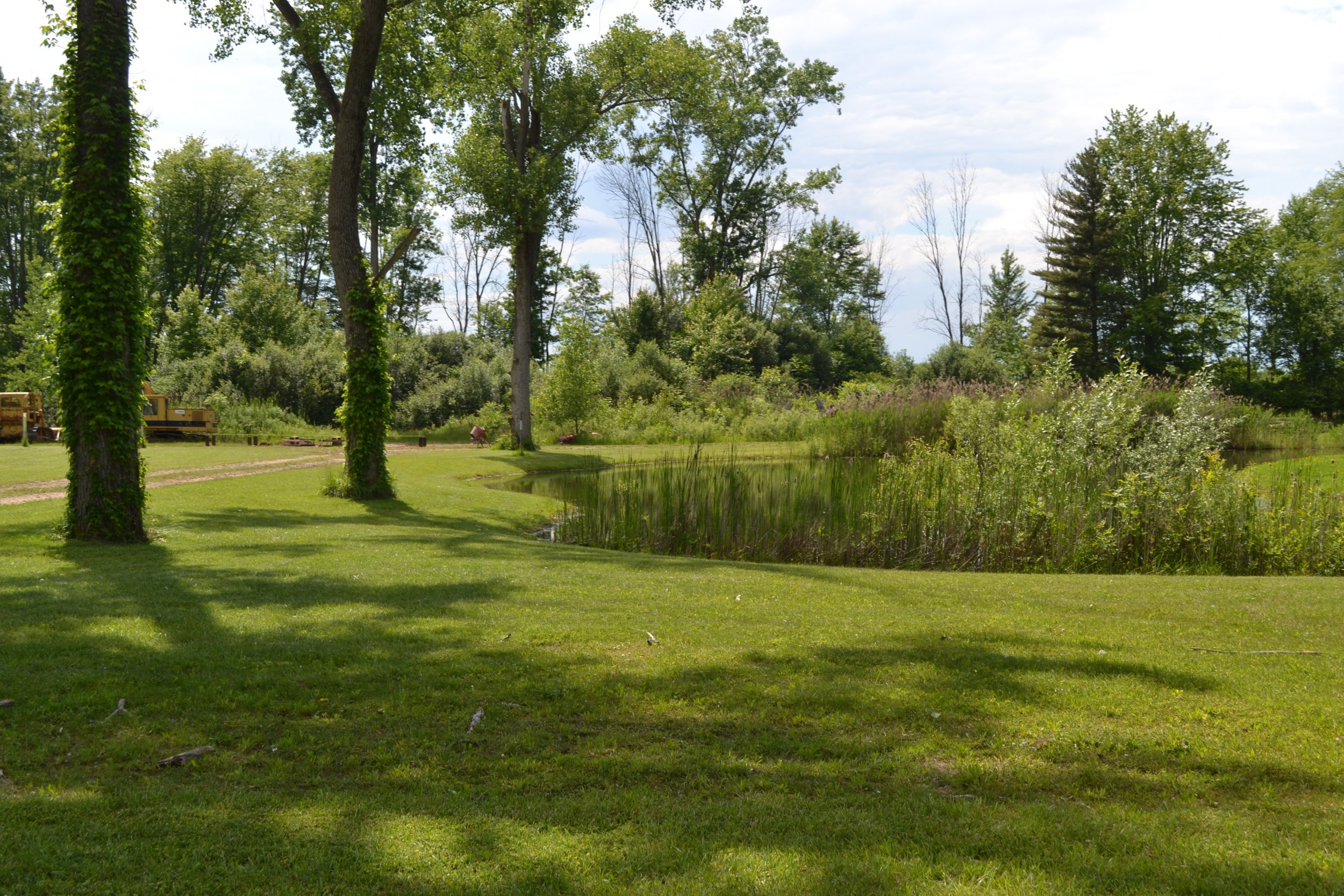

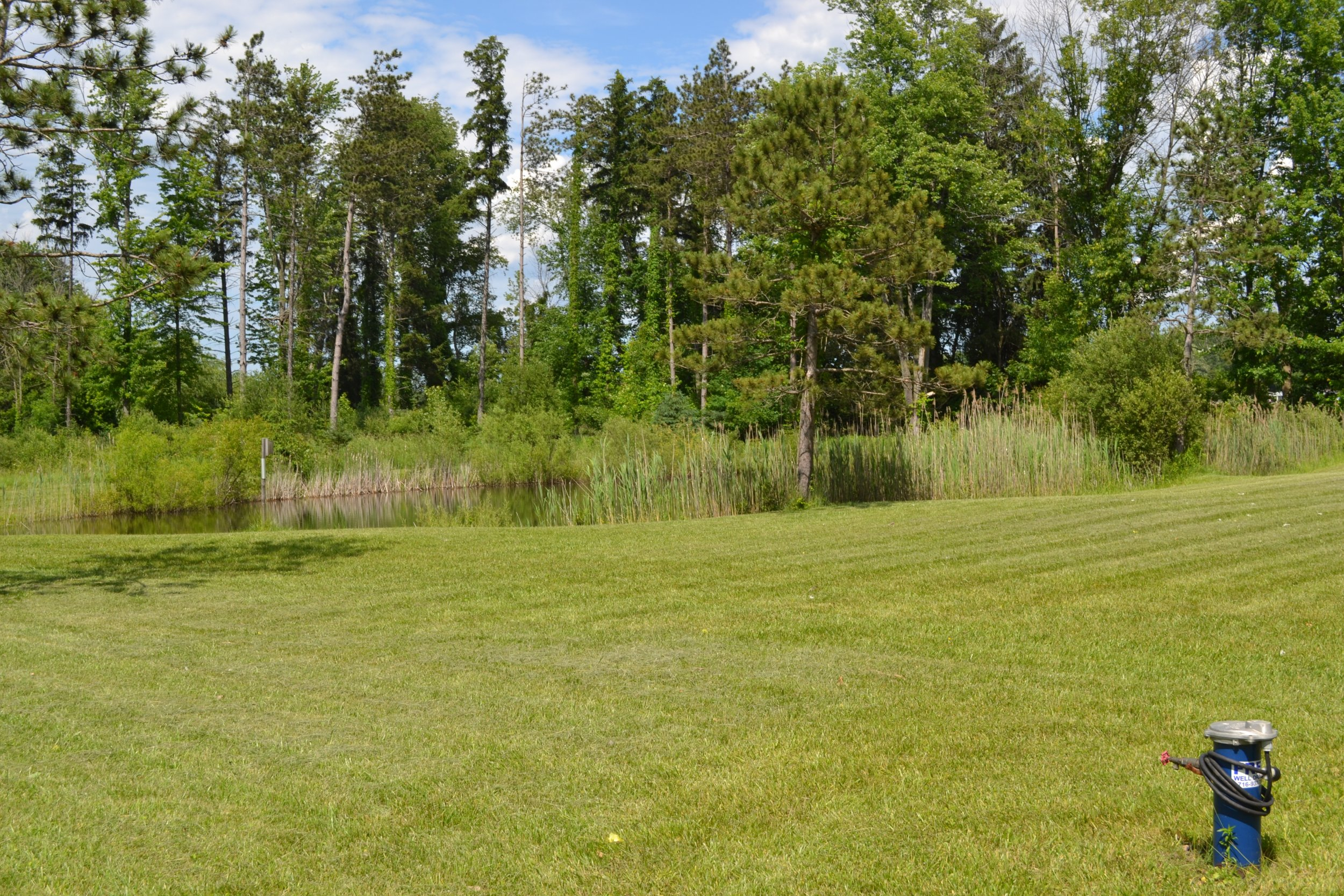

I'm over 200 feet from my 50 meter pond (think Olympic pool) and the view is just right from my balcony :)
If I recall you're up on a hill? My lot is completely flat. I have parked my 575D and raised the FEL and climbed in it at about balcony height, and the view seems ok, but it's not jaw dropping etc.
Here are some pics of what the view would look like if I were standing on a stone patio right outside of the living room of my stick frame house design.

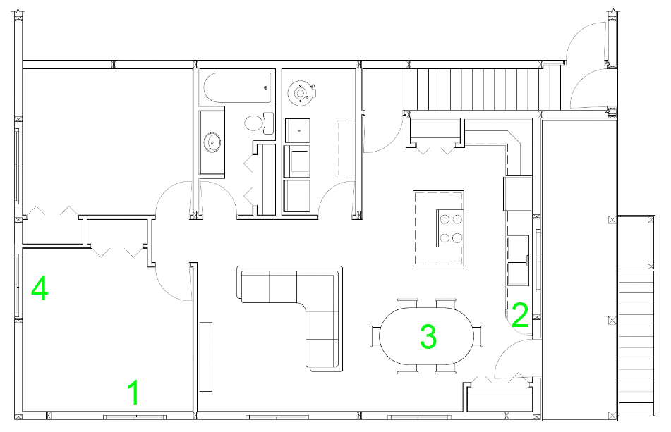

Please forgive me, I took some more liberties, LoL.
1: addressing OCD
2: easier access and reducing bruised hips
3: better fit ???
4: cross ventilation (fresh air when sleeping)
1: addressing OCD
3: better fit ???
Those are all pretty good tweaks. I guess I don't really need all that extra countertop at the entry once I took away the old pantry.
I would have to think about the second window in the bedroom, would require moving and adding another post. I don't sleep with windows open, I sleep with AC cranked.
You are quite right about the hill; totally forgot! Your balcony puts you up nine feet and mine puts me at ground level for the other side of the house but there is probably another ten feet of slope beyond the garage below over the 200 feet so I guessing I'm roughly 20 feet above the pond level.
Regardless, you still have a lovely view especially if you trim the tall grass around the edge of the your pond :)
   / Barndominium/Shop or "real" House?
#238
Most of it is, but I leave sections like that for wildlife purposes.
