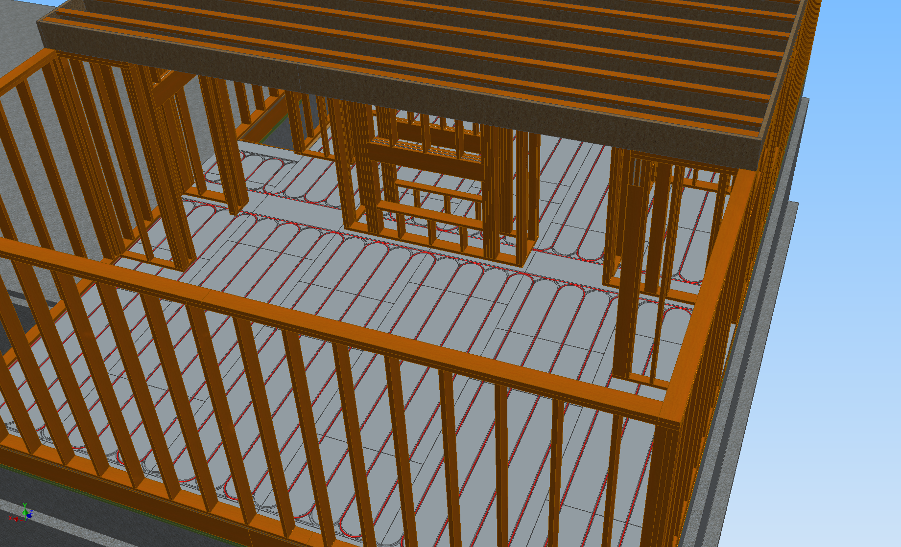

I had Warmboard in my ICF house design, it was one of the things that made the estimate explode. So now I'm thinking for the living space I would just go the more traditional route and put the tubing on the underside of the sub-floor with heat reflectors & insulation etc.
This falls under the category of You can pay me now or pay me later!
I guess I shouldn't be surprised the Warmboard is expensive but on the other hand I believe the underside of the sub-floor is the least efficient and will increase your operating cost. You are still thinking long term ???

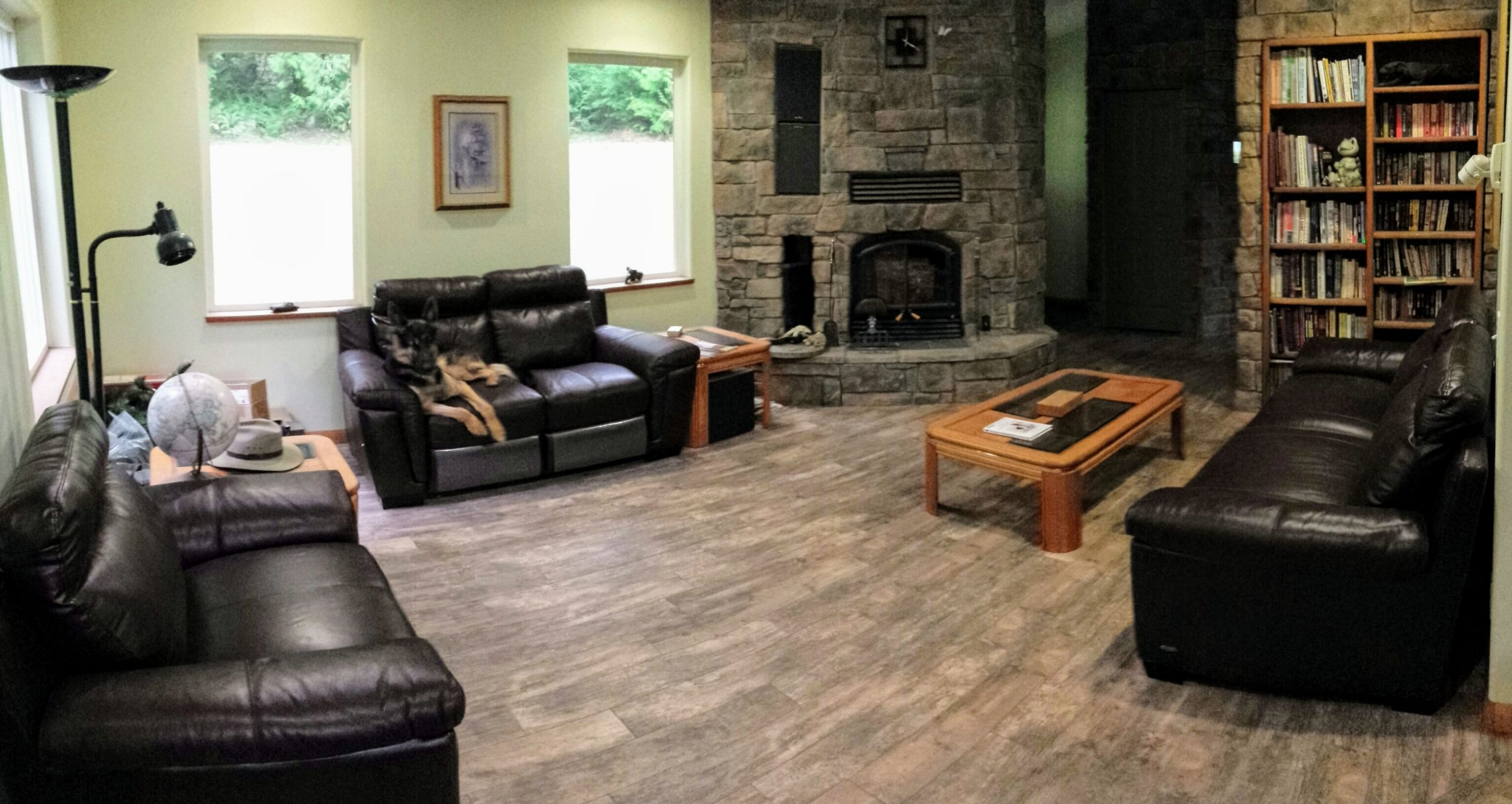

From personal experience I went with PEX and nailed clips to the sub floor to which was added 1½" of fiber filled concrete with dull red coloring. We had to add a 2x4 floorplan to the sub floor to raise the house 1½" for the concrete. 15 years later I added 1250 square feet (less walls) of ceramic tile flooring for a better finished look and $15K less in my bank account!
The beauty of Warmboard I would imagine would be easy and accurate installation plus more even and faster heat transfer. The slots for the PEX and the aluminum making it work that much better.

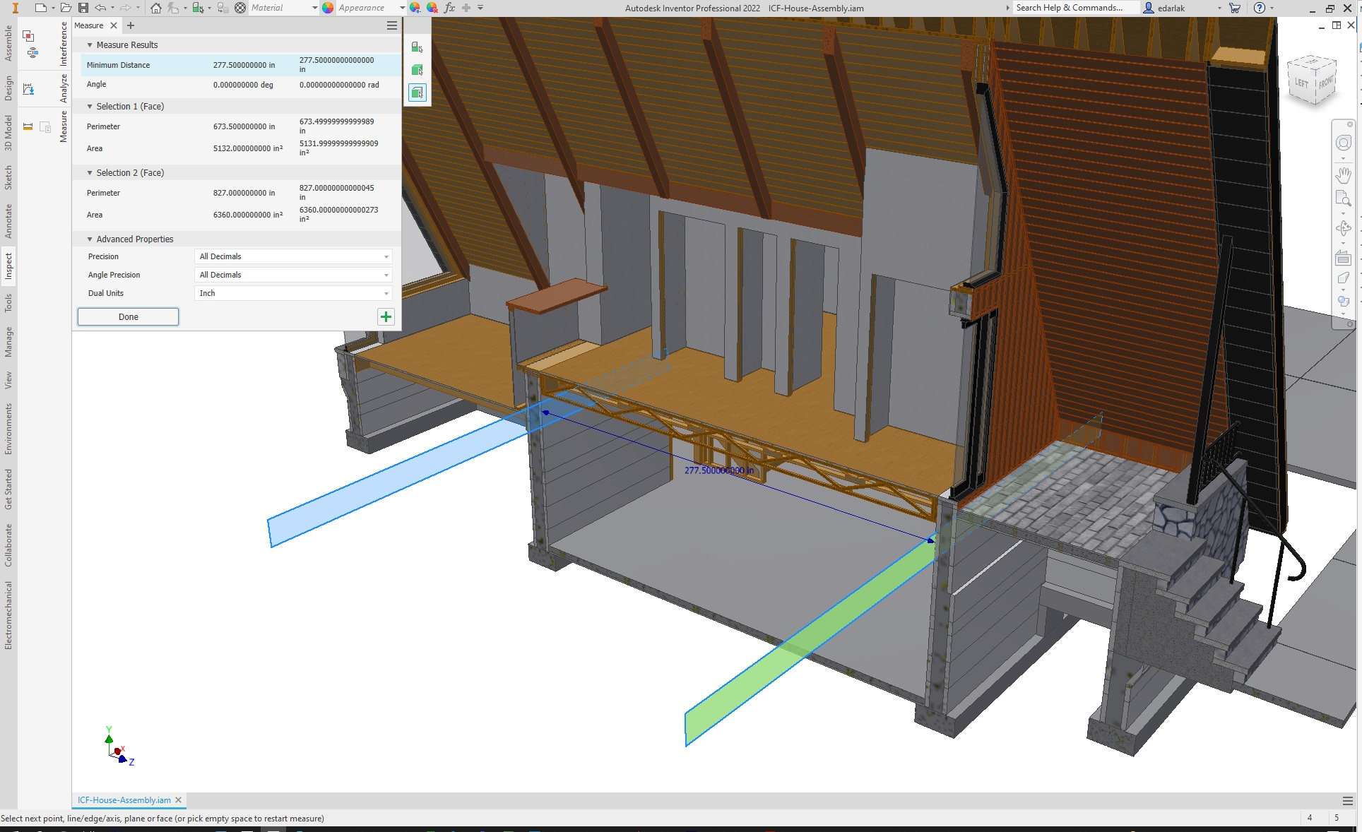

I'd never do that and all those CAD drawings and the actual product will vary.
Drawings and dreaming are nice. Reality is another animal.
