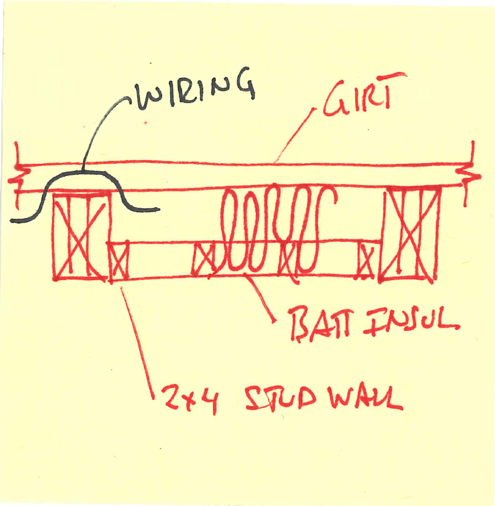

Yes. It seems like there would be more thermal bridging than with just the standard post & beam construction. But so far all the builders keep saying bookshelf is best for the living spce as it provides drywall nailiners.
I'm almost thinking to go with standard outer wall girts, then just use 2X4 stud walls between the colums in the living space flush with the inside of the posts, that way I have normal stud walls for drywall, and have a cavity of ~3-3/4" between the stud walls and the outside girts for insulation. The only thermal bridging in that scenario is at the columns where the outer girts connect.
I like that with one difference, I had a vaulted ceiling done with closed cell spray foam this summer. Amazing the difference, it is expensive but the performance of it exceeds the R value difference. Fiberglass batting is very poor in my opinion especially in windy areas. I am convinced of the benits of spray foam at this time.

I was told by an electrician that the space behind the columns on a normal pole barn above the 2x4" girts was not for running wire. Wire had to go up and down columns and around columns in attic space. Way much more wiring that way. Couldn't drill holes in columns either. Jon

Well that is something I definitely need to talk to an electrician about, cause that's a crapload more wire than I was thinking. I wonder if that is NEC code or maybe local to your municipality...
Yes, I wasn't disagreeing with the reasoning for using it, was just curious about increasing the thermal bridging by a factor of X.
