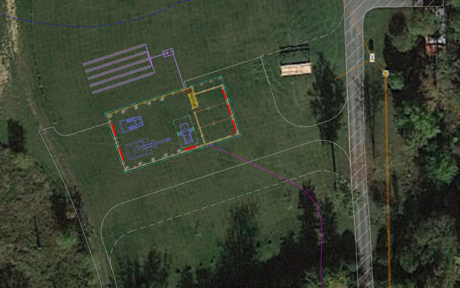

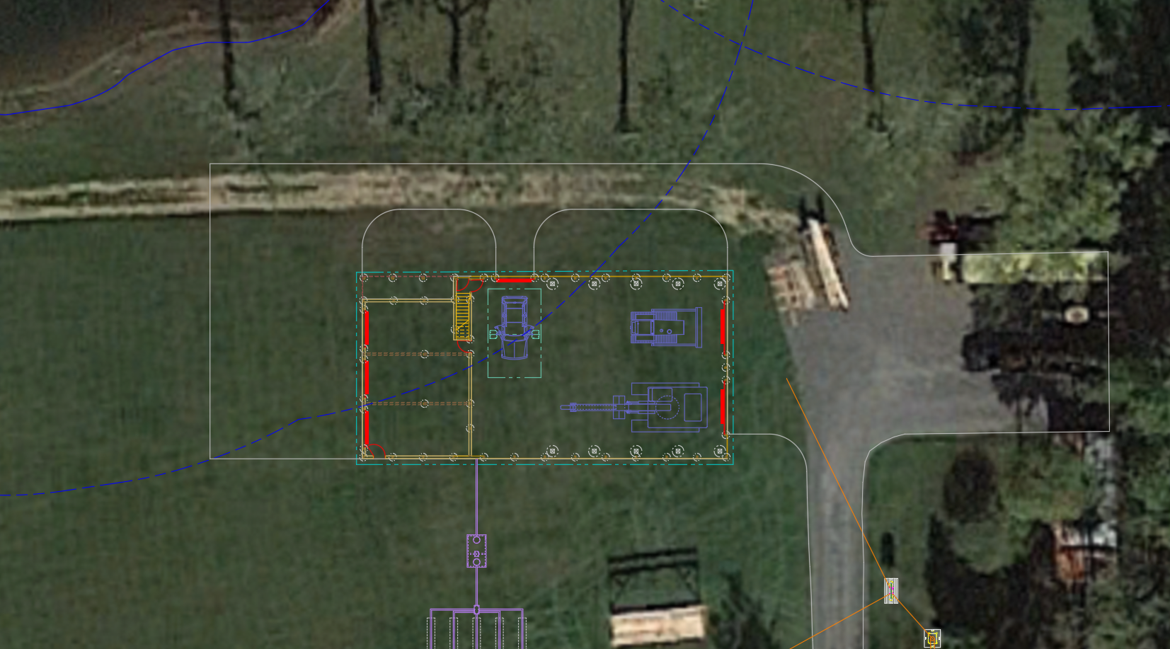

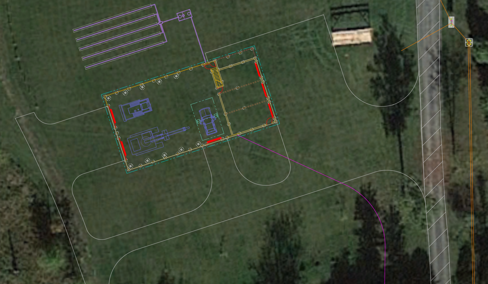

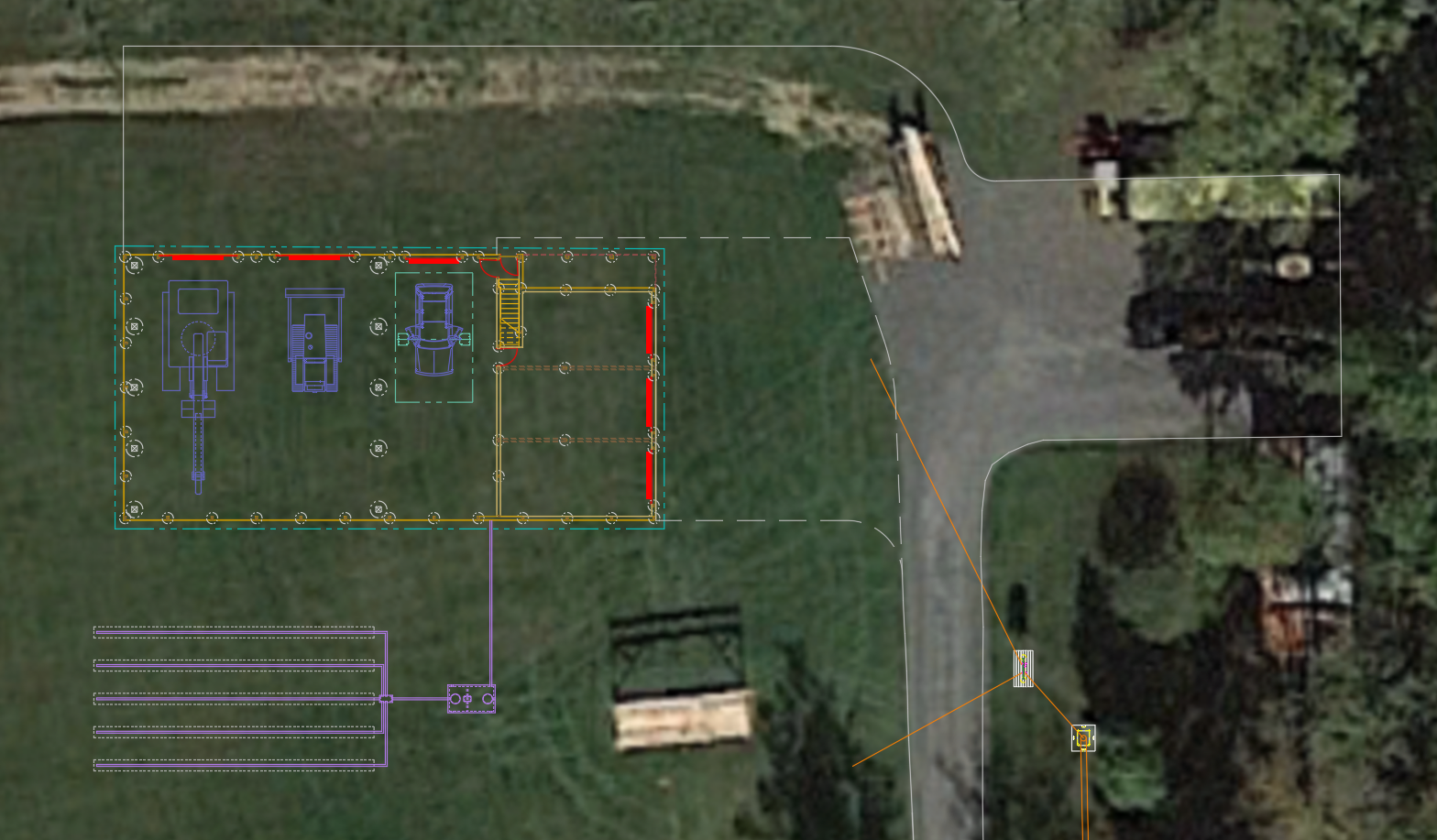

I spent the better part of 20 years looking at stock house plans. None of them seemed to work for me. I'll pick the Faux A-Frame house soon as someone gets back to me with a reasonable estimate.
As far as backing in a trailer in any of the garages. I've tried many different combinations. When I try to account for that on all garage doors, the amount of stone I would need is quite silly.
The last option is not great because the living space is now taking on the westerly winds. And the sun is setting on the living room window ruining TV watching. And to get my tracked equipment into the shop I driving over the drievway for my cars digging the stone all up with the cleats.

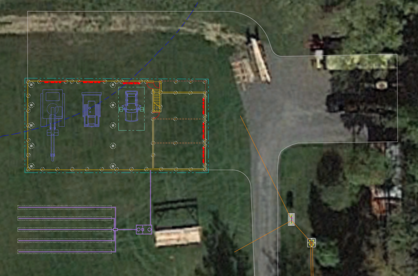

This configuration would require the least amount of new stone. No doors facing the west wind.

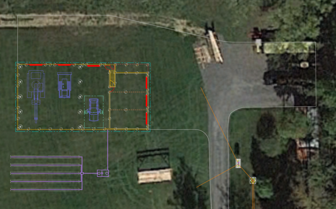

Or give myself a little more room, and only start with stone in front of the 3 car garage, add more to other doors as time goes on.
