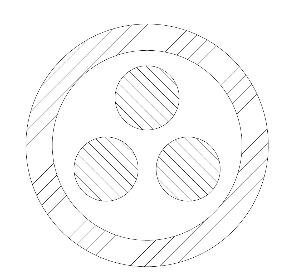

I put in a work request with my power company to have an engineer look into it. I think it will come down to the 2-1/2" SCH80 conduit I have underground.
But talking to an electrical engineer acquaintance of mine, he states from this picture:
The conductor looks like at least a #2MV90 cable. Which has a .760" O.D. Which 3 of those in my conduit would look like this:
One thing I don't know is what amperage that single conductor is carrying. However I do know it is carrying 7.2kV.

I guess what I don't understand fully is, the run between the pole mounted primary transformer and the pad mounted secondary transformer is 7200V for the existing 240V 400A service. So I would need three conductors carrying 7200V for 3PH correct? Why would the conductors get any smaller? Since there are three they can carry less amps even if I want 480/277V 400A? That would imply the 277V single phase would be max 400A/3? As you can tell I'm no electrical engineer.
I can see smaller wires carrying the 480/277V between my meter pedestal and shop, but not the feeders to the secondary.
