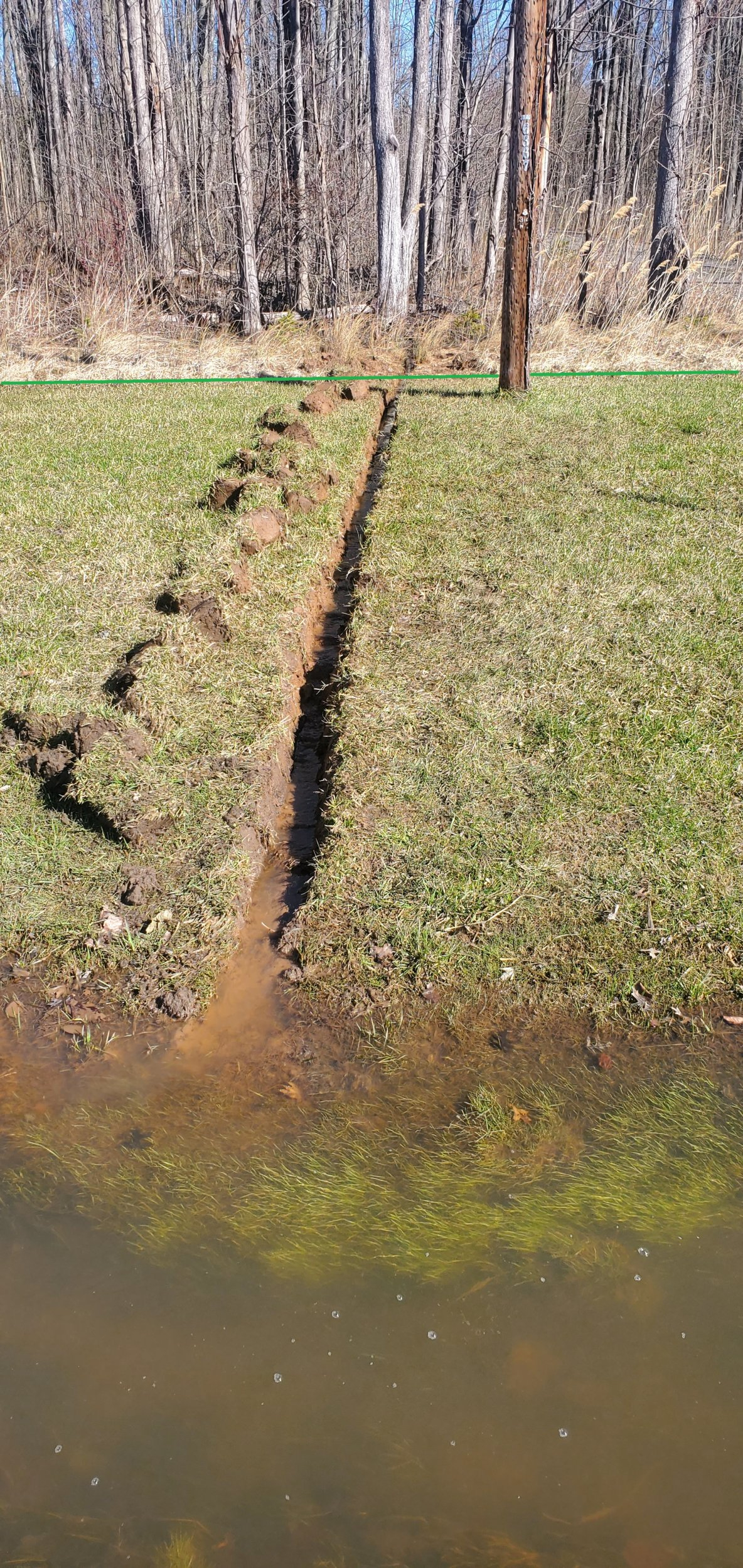

So regardless of what I build, I need to start working with a couple other utility companies, namely water and natural gas.
Both will require meter pits. For anyone with meter pits, is it best to place them in areas that are mowed on unmowed?
See pic below. I can choose fore or aft of the green line I drew in. Neither utility company seems to care. I think it might be better not to be driving over the manhole everytime I mow the lawn...
I don't think these will hold up well to being driven over: Meter Pit Enclosure
I also started to ditch for a drain tile as that area is routinely under water in the springtime, and I don't want my meter pit enclosures to always be full of water. The Highway dept has already complianed about a previous drian tile I connected to the front ditch, but the gov't can eff off tbh. I landscaped this area years ago and effectively dammed up the front of my property, so now the flow of water is more metered into the ditch as opposed to the high flow it was before due to the front of my lot being almost as low as the center of the ditch.

Why do they go in a pit?
   / Barndominium/Shop or "real" House? #365
Probably so they don't freeze.
My dad has one in a pit out by the road when I was a kid. Every month the reader had to pull the man-hole lid. Eventually, they put the meter in the house, and the display unit outside the house, so the meter reader didn't have to do the pit lid thing anymore.

I'd not want to drive over a pit lid for meters just as I don't like driving over my drywall lid. I'd think a reasonable solution would be to put it at the edge of some landscaping so it blends in and doesn't require mowing around. Maybe some string trimmer attention every once in a while at most.
If a residence is more than 200ft from the road, the water & gas services require meter pits. The pits will only be about 50ft form the road, the rest of the ~650ft run will be my responsibility if a water or gas line develops a leak etc.
   / Barndominium/Shop or "real" House? #369
If a residence is more than 200ft from the road, the water & gas services require meter pits. The pits will only be about 50ft form the road, the rest of the ~650ft run wil be my responsibility if a water or gas line develops a leak etc.
Is that just in your state?

Well every county/municipality is probably a bit different in a given state, but I think in most states there is a maximum distance where the utility company would want the meter from the road.
