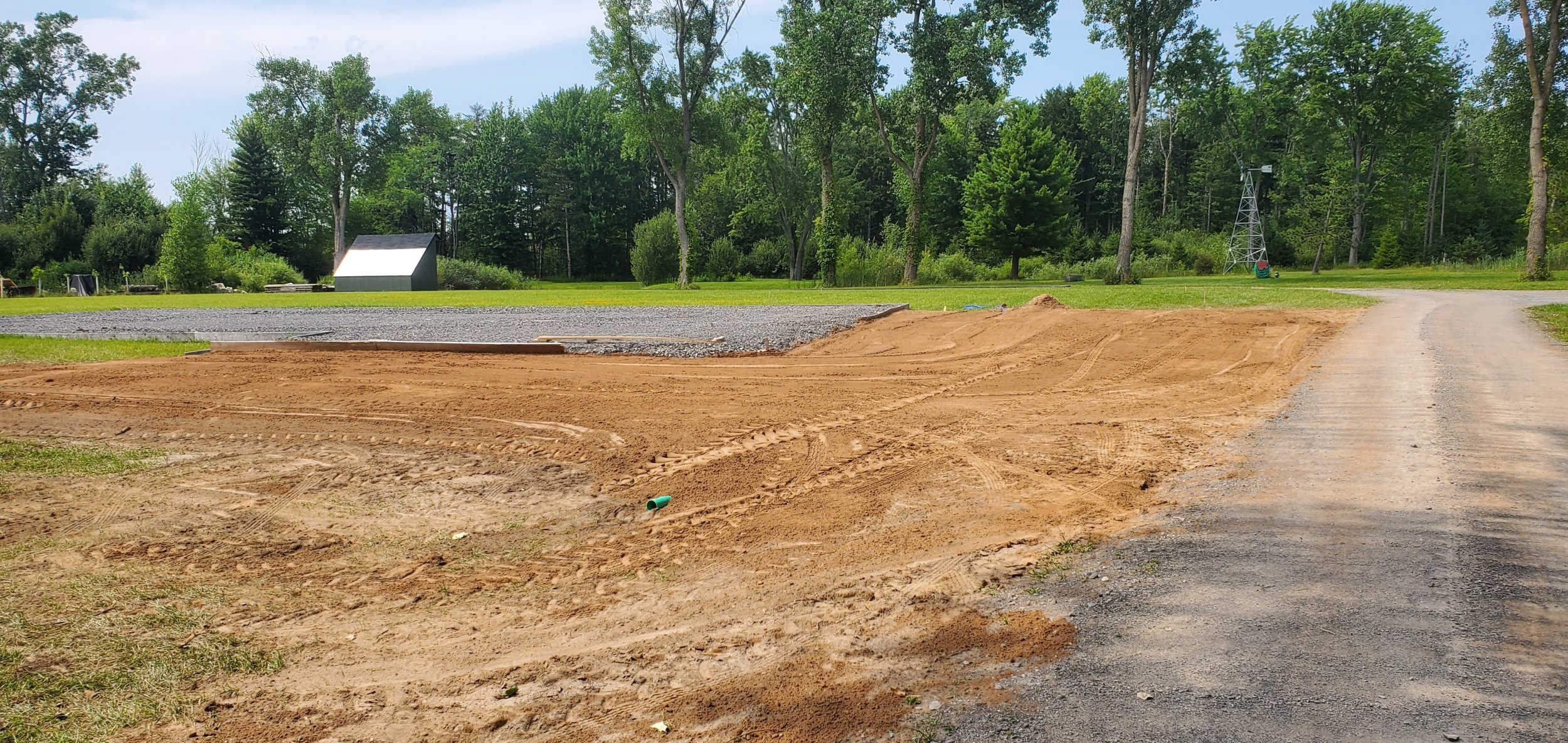

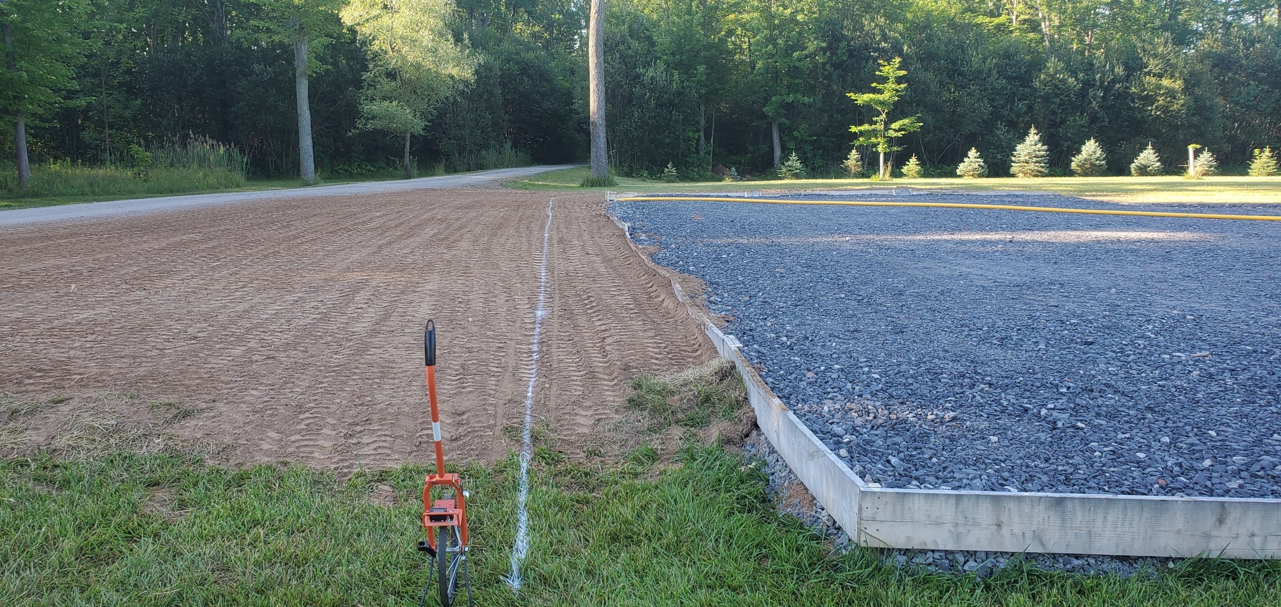

Very nicely graded and it looks really good!
The pictures are great but its hard to capture the elevation or show how and how much you have built up the site. As it looks like the piles are 4-5' high then the final grade from the drive to the berm of the building is 2-3' elevation?

About 26", then tapers off towards the driveway.
It took almost 20 tandem dump loads of dirt to bring up the approach to the level of the building pad. It will settle a bit when it gets some weather, so should be about the right height for ~6" of stone.

That sure looks nice. I really appreciate dirt work when it looks all natural and smooth!!!

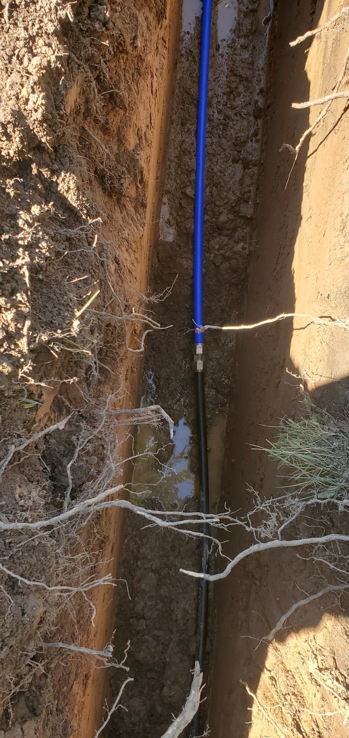

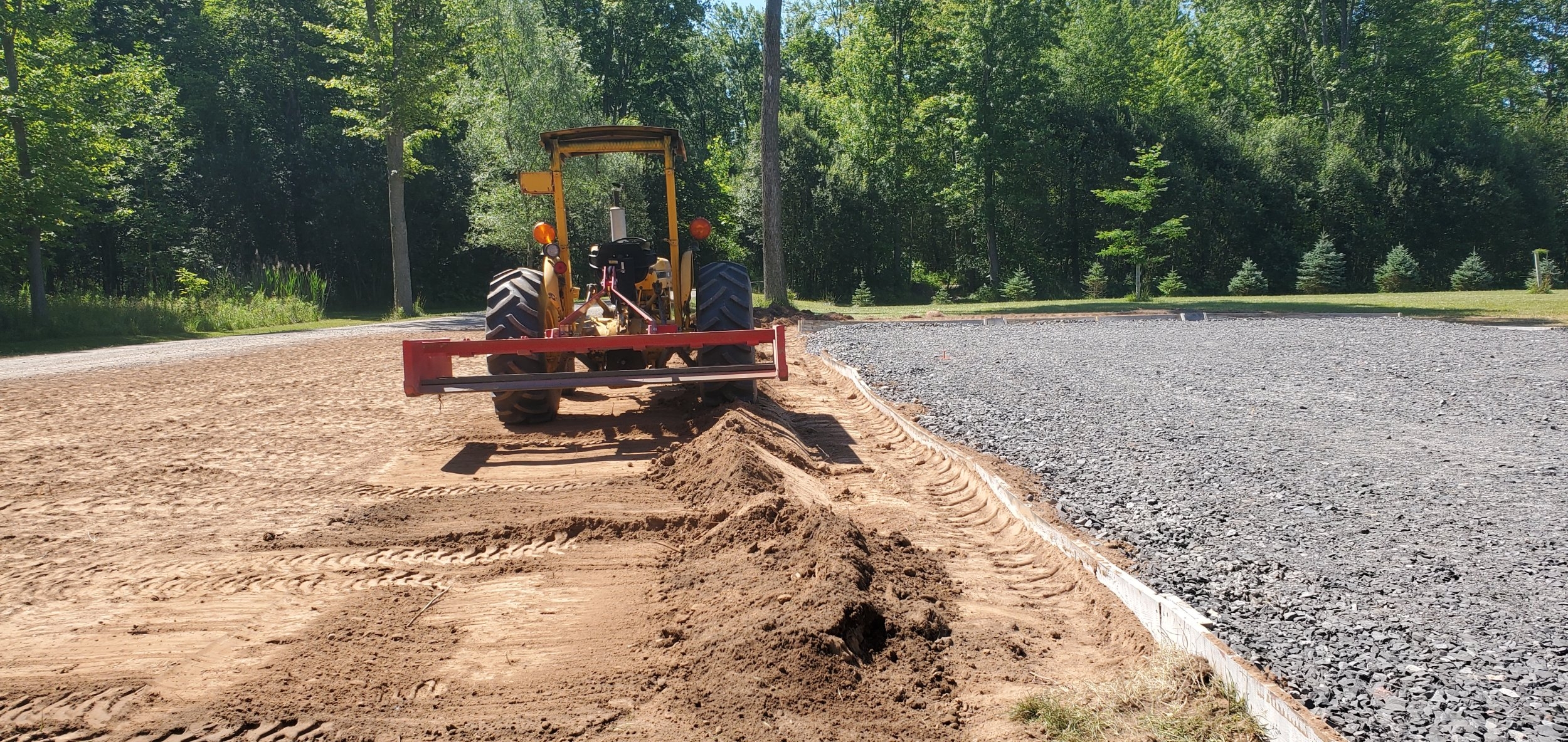

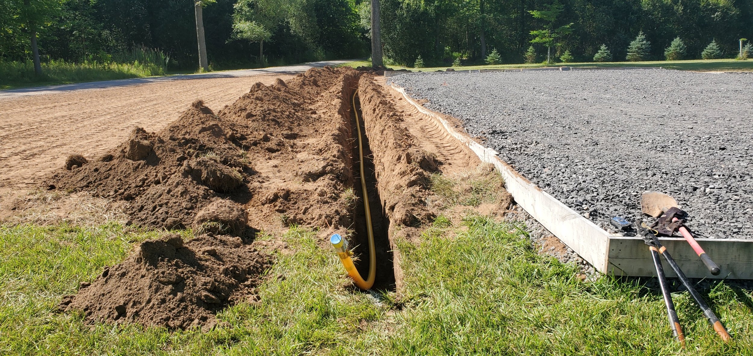

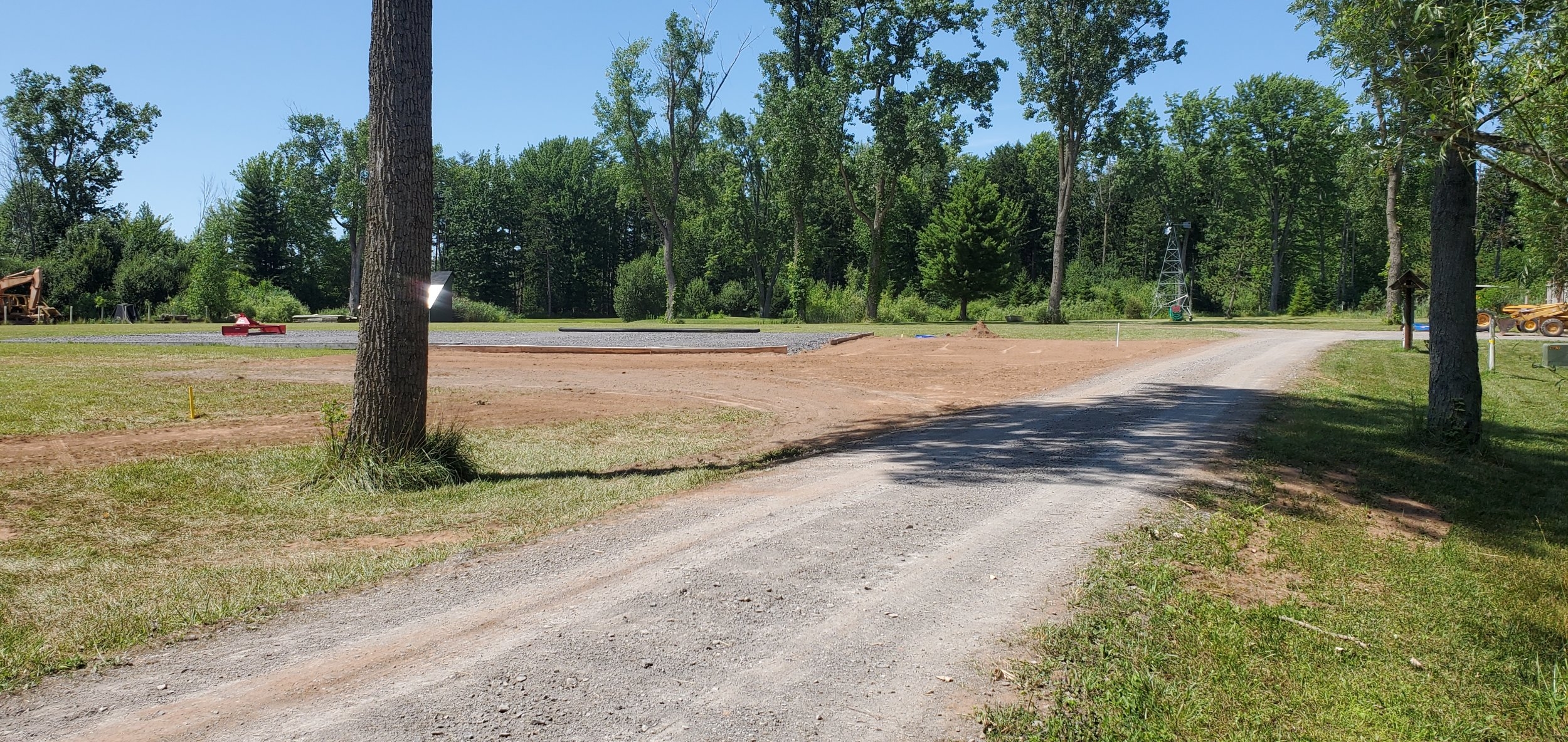

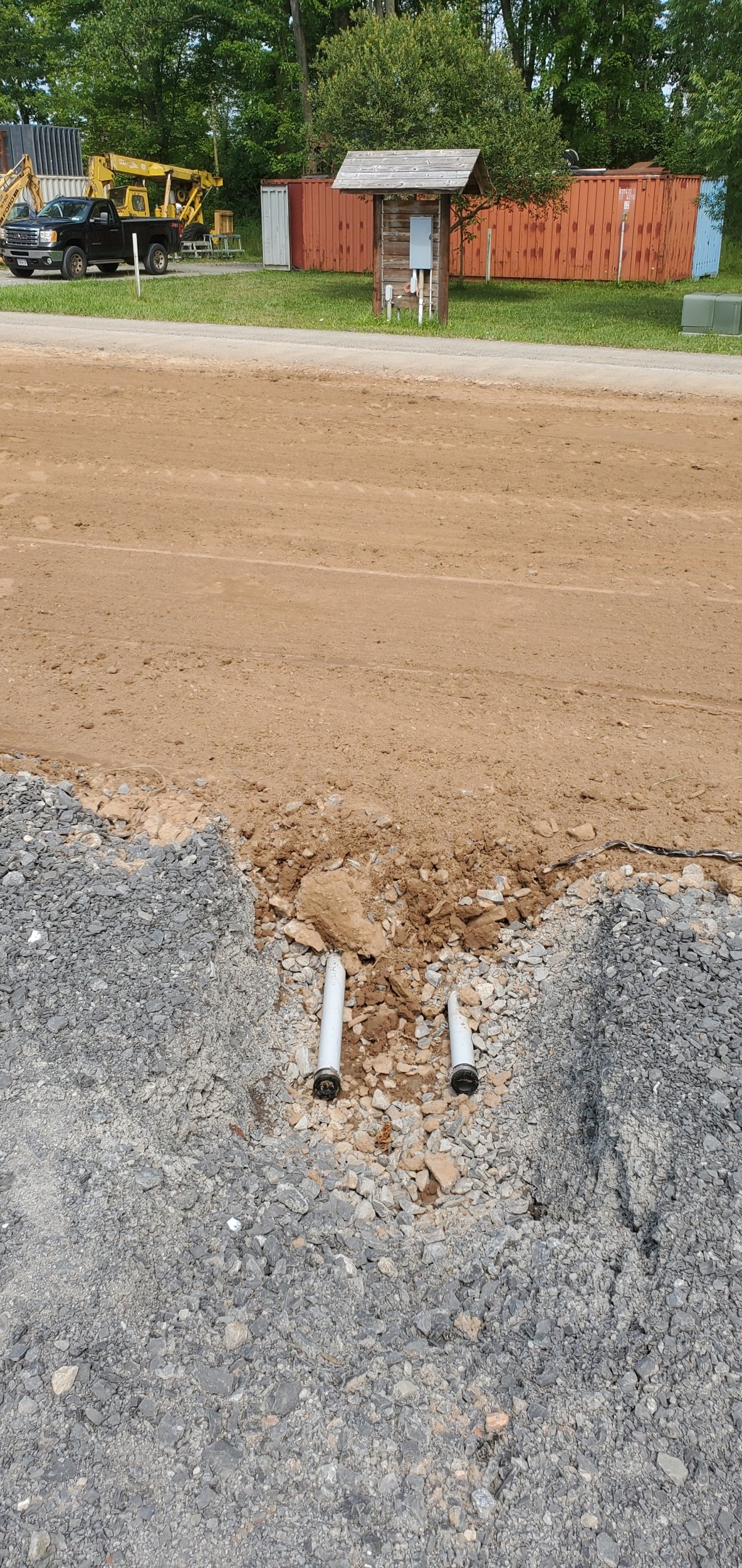

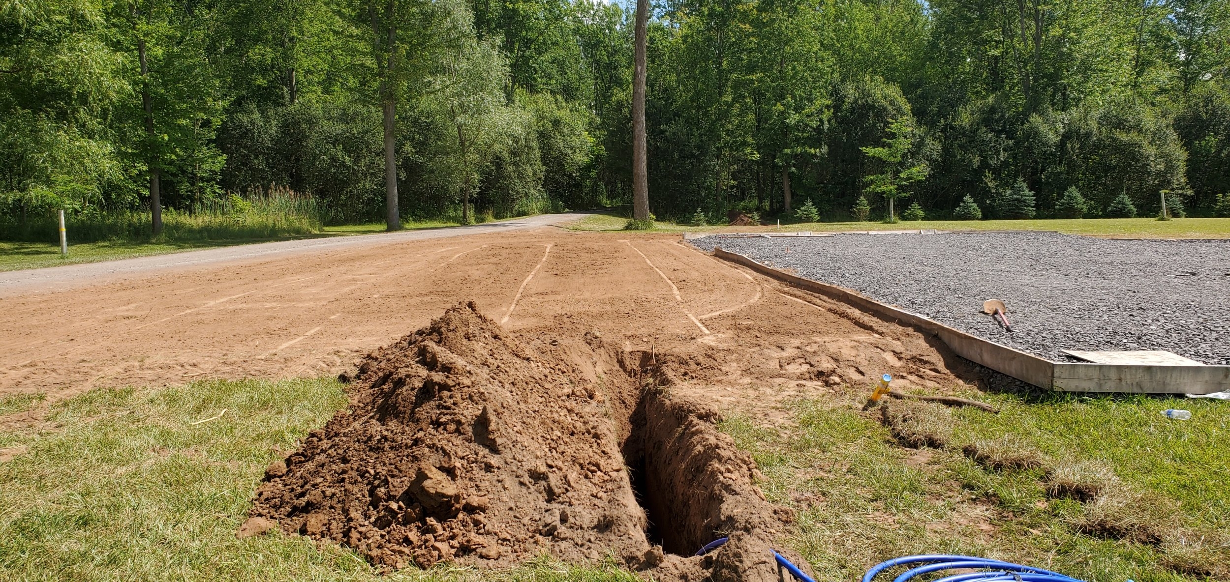

I was able to get the water line and conduit for the natural gas under the approach. Still need to do the power conduit and then a drainage line in before I can put down some geotextile and then stone.

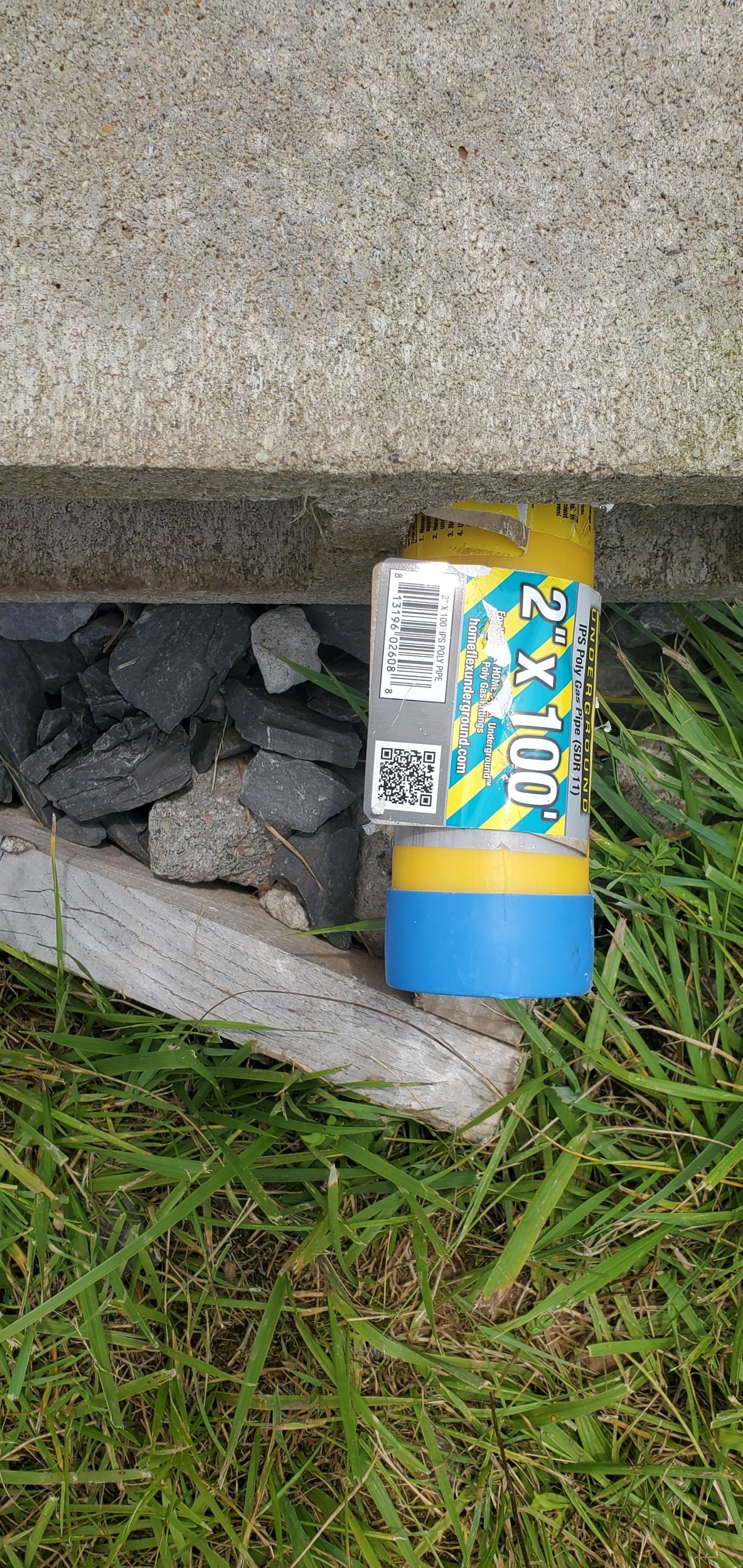

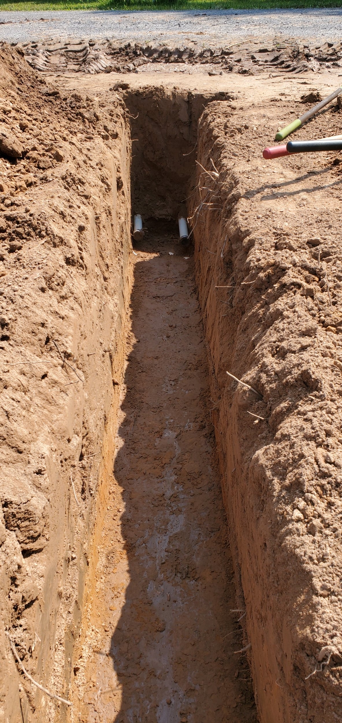

The power conduit has been under the driveway for years. I had it marked but then lost the large survey nail I used to mark it. Where I have that white PVC pipe is where I left off running the conduit. I hope I don't have to dig a giant hole to find it...

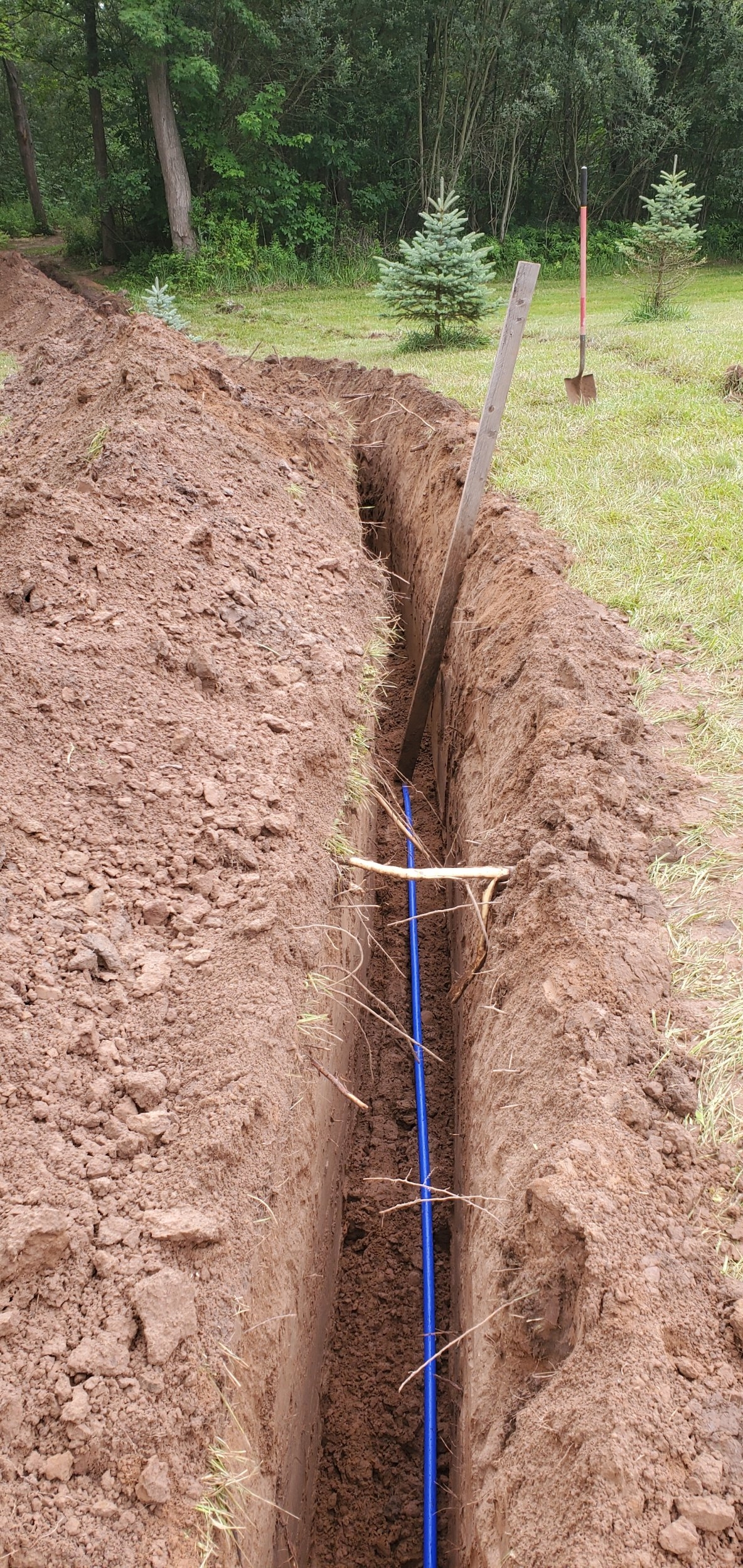

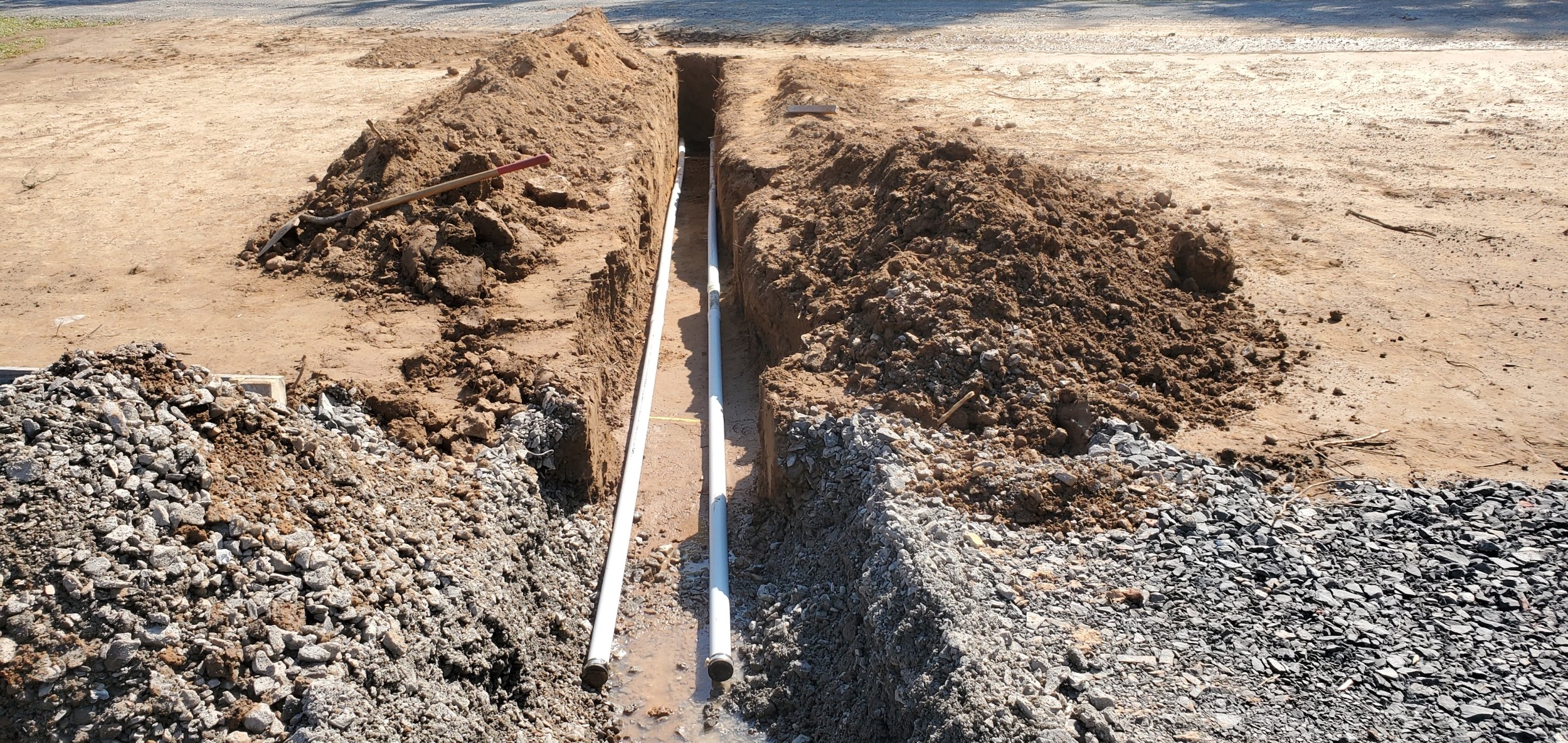

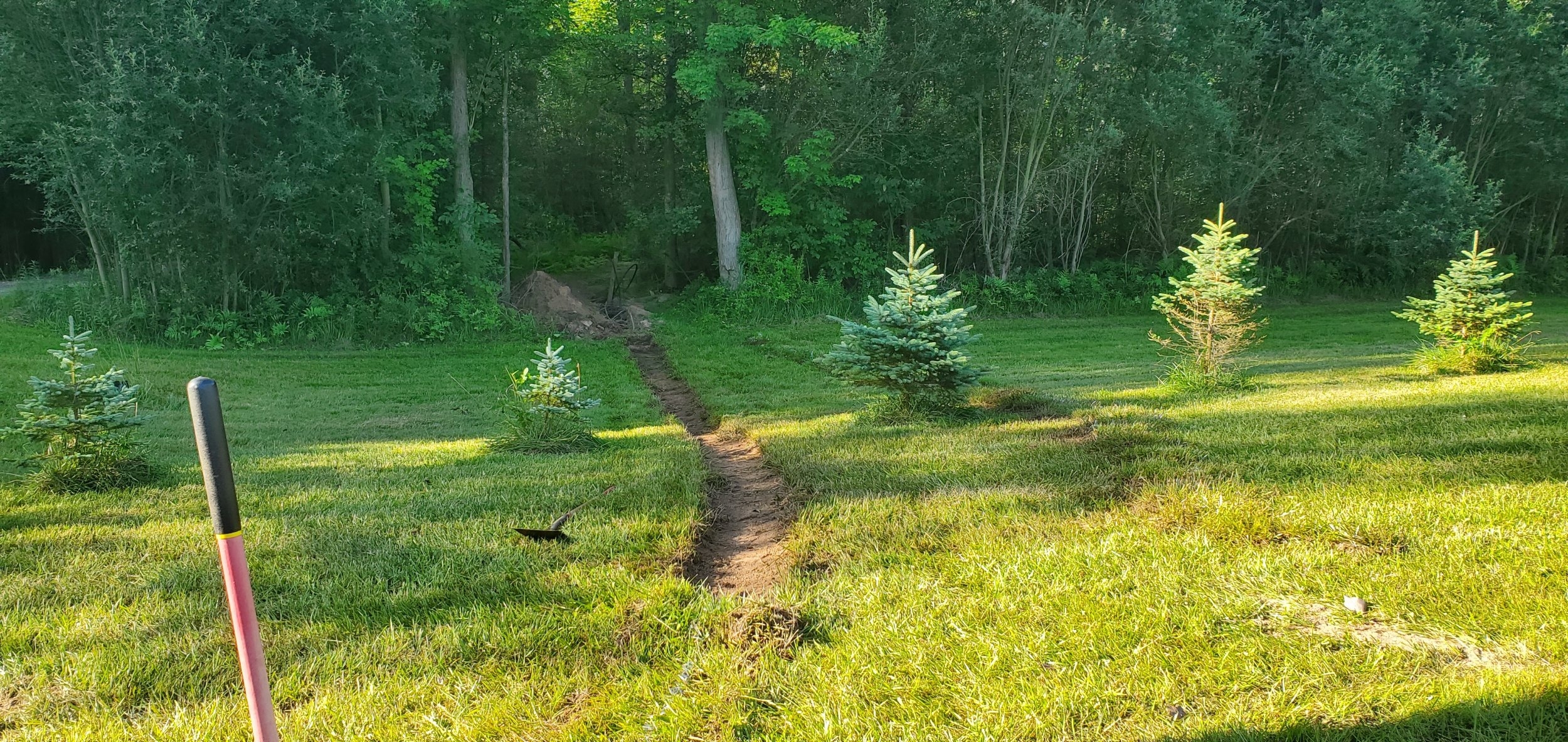

This is a picture from when I did that back in 2018. One conduit for power, another for communications.

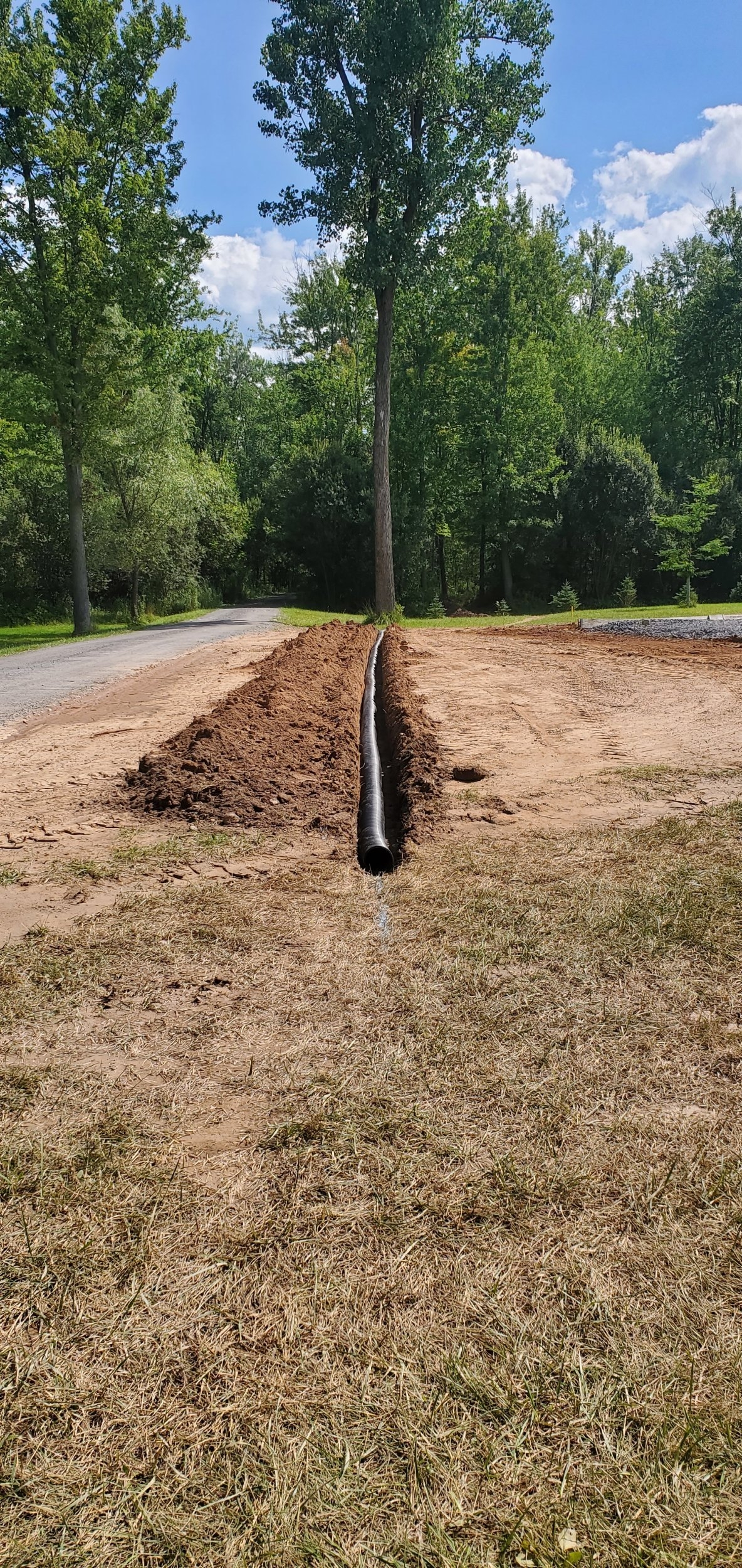

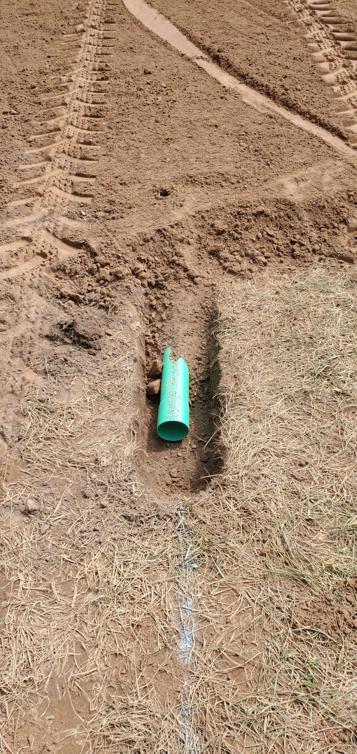

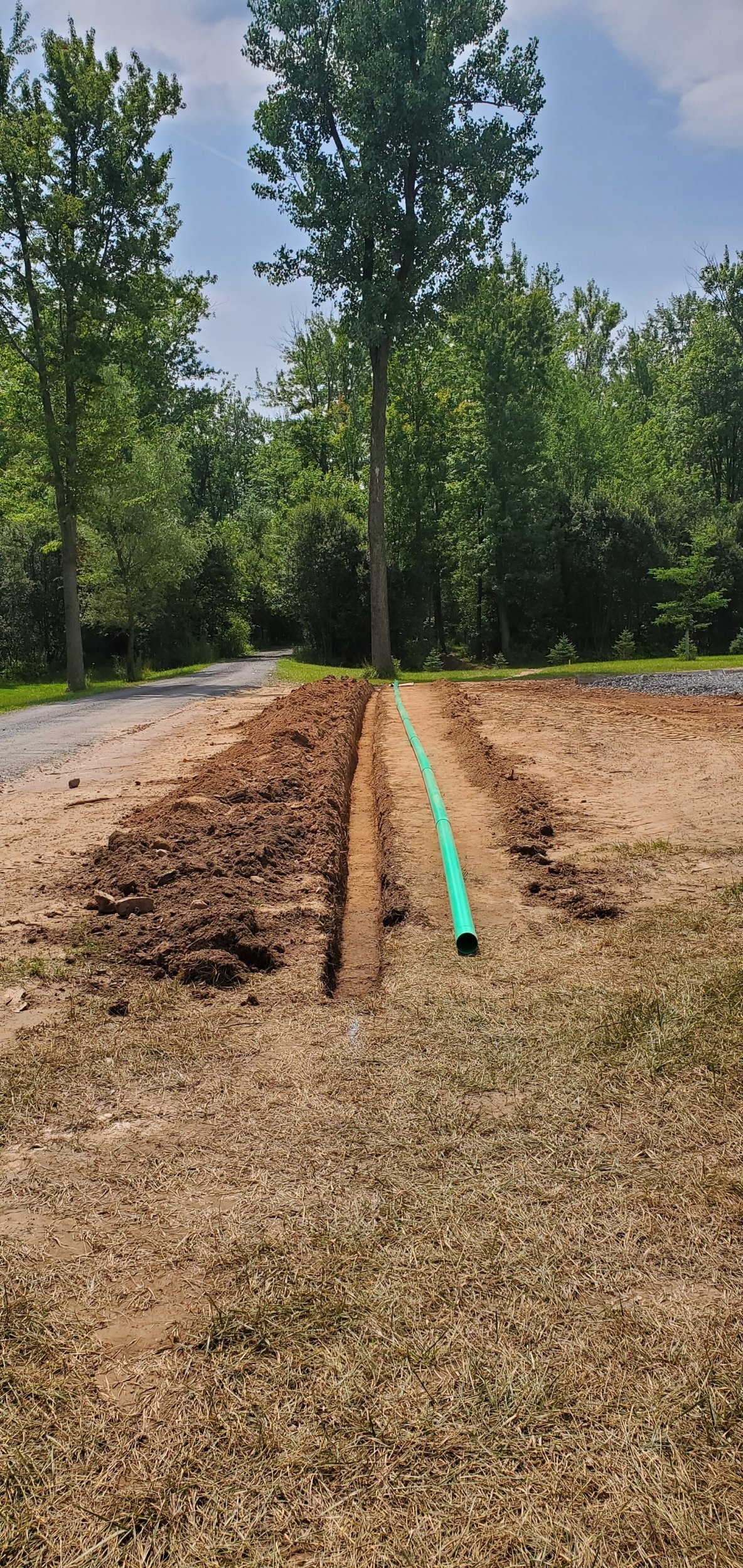

Got the power/communications conduit run, as well as the drainage.
I bought some 6" corrugated for drainage, but then thought better of it and used 4" SDR 35 for under the approach.
Pretty much ready for driveway fabric & stone.
