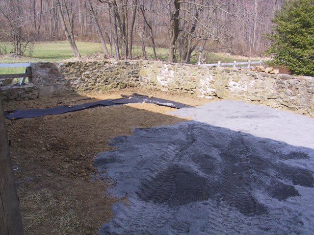

I put about 7hrs on the LK3054 today, working on puting in a drainage system for out barnyard (aka: pony mud wrestling area). I am extremely impressed it so far. This is a 28' x 36' area, extremely confined, and access is through the forebay support posts (about 9' opening). I could never have done it without the split brake peddles. I never thought I would use them much, but in the mud I could make it turn like a skid steer! I used 2nd gear low range, and ran with the hand throttle. Used the clutch with my left foot & the brakes with my right. Here is a question for the CK20HST guys: how would this work with the hydro? Can you set a low ground speed with the cruise control to free your feet for the brakes?
I find I am much better with the BH than I am with the FEL so far. Mostly that is because I'm trying it in a confined space, but I have a hard time getting a reasonably full load without pushing the dirt so far it ends up against a wall, or back in the ditch. Then I have to drag it back with the blade and try again! But I'm learning!
I took tomorrow off, so I hope to get the pipe and stone in & level it off. I'll put landscape cloth over the stone, and then put fines over it all. I couldn't be happier with this machine so far. My wife is delighted at the prospect of fixing this mess up, and so far the Kioti is putting on a good show! /forums/images/graemlins/smile.gif

Nice looking work Chris, you must have a fairly narrow bucket? Are you using slotted drainpipe? Rigid or corrugated?

RobS - I got a 12", as this is the kind of work I was planning on doing with it. I have a lot of other similar projects planned. I'm using 4" corrugated & slotted for the field, and I'll adapt it to non-slotted on the other side of the wall. I usually switch it to Sched 40 before I bring it to the surface.

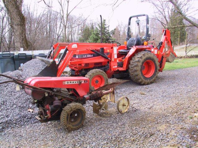

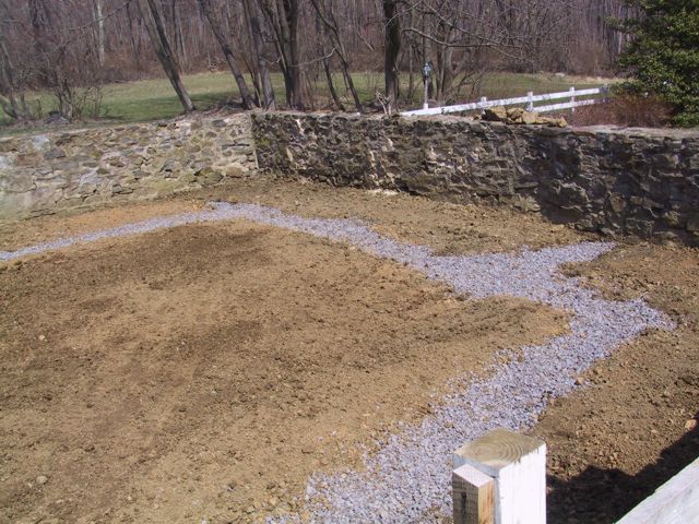

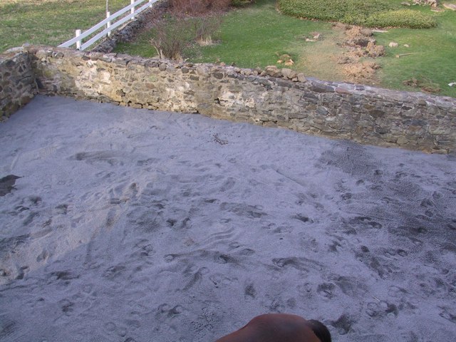

Well, I finally got to finish the barnyard area on Wednesday (nice day+vacation+tractor= /forums/images/graemlins/grin.gif). The rain had turned the piles of dirt and mud into un-rakeable clumps, and I could not get the LK back in there without tearing everything up brake-steering it, so I had to get the Gravely out and put on the rotary plow. Another excellent machine if you ever run across one! Here are some shots of the end of the project.

It rained very hard here last night, and may again today - the barnyard handled it quite well. It was dry enough this morning to walk on with regular shoes and not get them wet. Also, it appears the quick re-grading I did behind my barn may have worked well too, as previously we would take on water in the stall by that corner. So, all-in-all the Kioti scored big points with the boss on the first couple of projects /forums/images/graemlins/smile.gif
To be honest, I've wondered at times if I should have spent the money to buy it, as opposed to hiring/renting. But for me, time is a big problem, and trying to organize these projects around the weather with contractors is a real pain - enough that they probably would not get done if I did not have the tractor here and ready when the opportunity presented. A few successes really helps, and I'm very glad that I bought it now!
