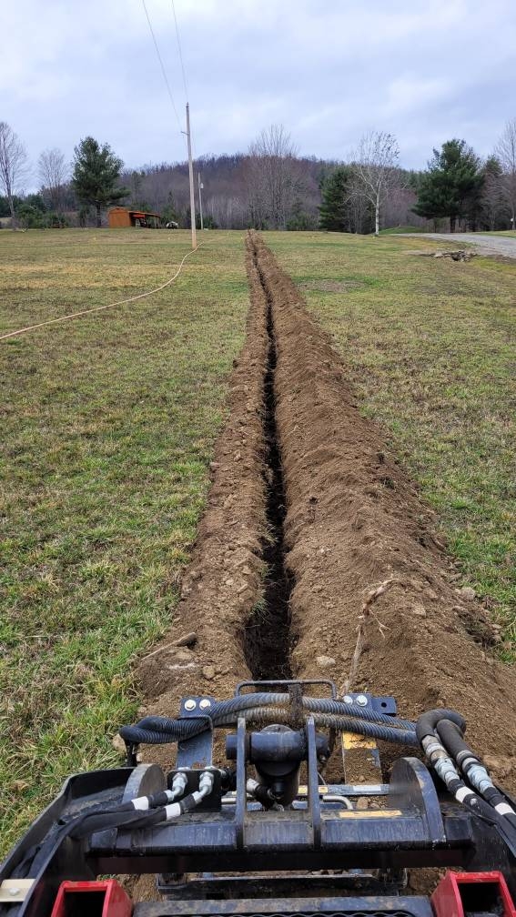

Rented trencher, over 1000 feet in clay soil. Took less than 2 hours.
Digging 2 trenches would be a day's rental. You may have mention depth required. This got down 3'...

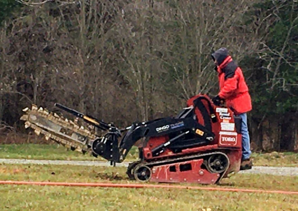

Would it be possible to simply use a 6" ditch witch trencher? It should be a lot faster than an excavator. SAND? What a pain, but you should be able to handle it. Perhaps you could make a tool to lay the sand into the ditch.
If it was me, I'd do two separate narrow trenches with the ditch digger and keep your power and telecom completely separate.
I mentioned this as a consideration in my OP. It'll be $309/day plus finding a way to transport it. Then there is New England ground filled with granite. Just when you think you are in the clear you hit a big rock(s). If the trenching was the only thing I was doing then maybe I give this a go and use the backhoe on my tractor when rocks are encountered but sometimes they are really big and 60hp tractor even struggles. Now, before anyone says anything, I've considered doing the trenching with my tractor. I thing I would be fine with it 3/4 of the way but I just can't maneuver it in the woods and on the hill to effectively, or safely, dig a trench. The CAT 36 is a bit wider than the tractor and will also struggle a bit to fit the path but with the reach it has and the blade I can probably get where I need to go. I'll find out tomorrow when it is delivered. Should be interesting. I don't have a good track record with excavators+trees.
Digging 2 trenches would be a day's rental. You may have mention depth required. This got down 3'...View attachment 4316533View attachment 4316534
That would be perfect other than what I described in the original post and the one before this. I am coming up a hill from the pole and then shooting over diagonally and up a the rest of a hill in a wooded area. I think I would probably be ok considering the tracks but I would be looking at additional dollars and if I hit those big rocks, which is almost inevitable, I'm in there with the excavator. Who knows. Maybe I will find a local place that has one that will be cheaper to rent and closer than Home Depot and try and come up with the extra $$ to get it.
