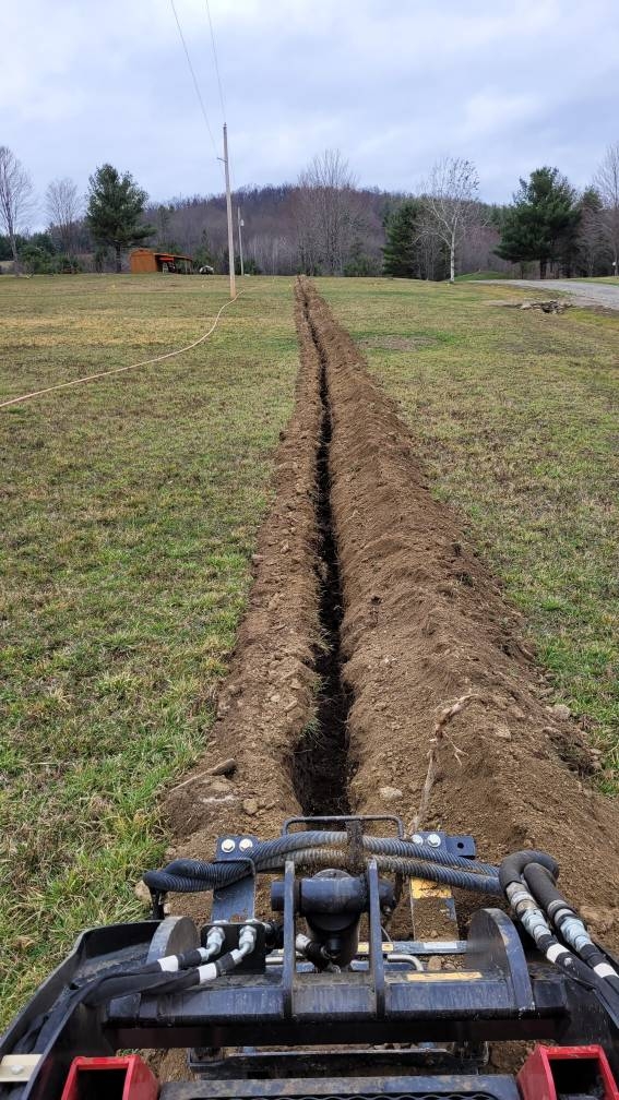

Rented trencher, over 1000 feet in clay soil. Took less than 2 hours.
Digging 2 trenches would be a day's rental. You may have mention depth required. This got down 3'...
Digging 2 trenches would be a day's rental. You may have mention depth required. This got down 3'...View attachment 4316533View attachment 4316534
That would be perfect other than what I described in the original post and the one before this. I am coming up a hill from the pole and then shooting over diagonally and up a the rest of a hill in a wooded area. I think I would probably be ok considering the tracks but I would be looking at additional dollars and if I hit those big rocks, which is almost inevitable, I'm in there with the excavator. Who knows. Maybe I will find a local place that has one that will be cheaper to rent and closer than Home Depot and try and come up with the extra $$ to get it.
