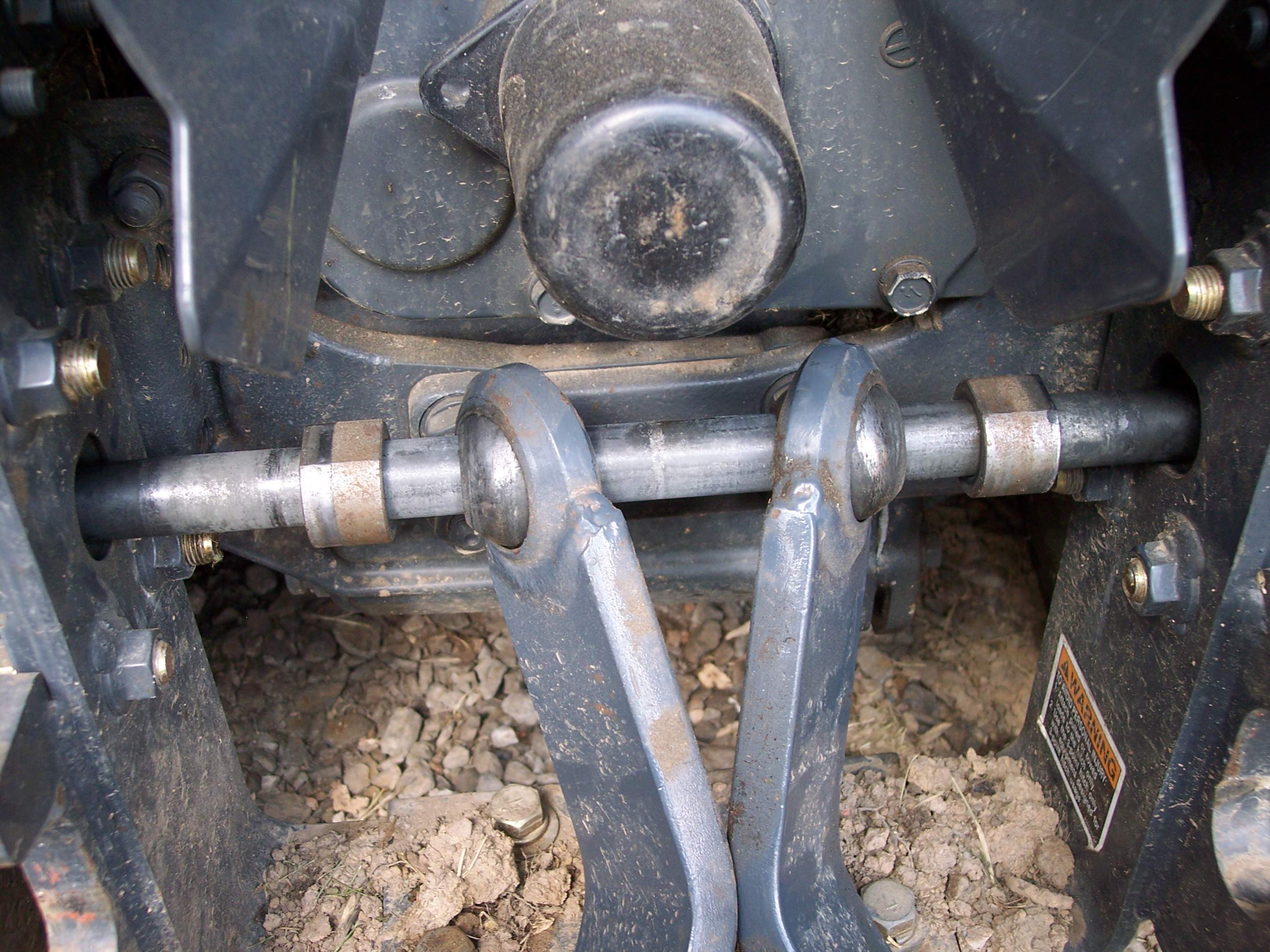

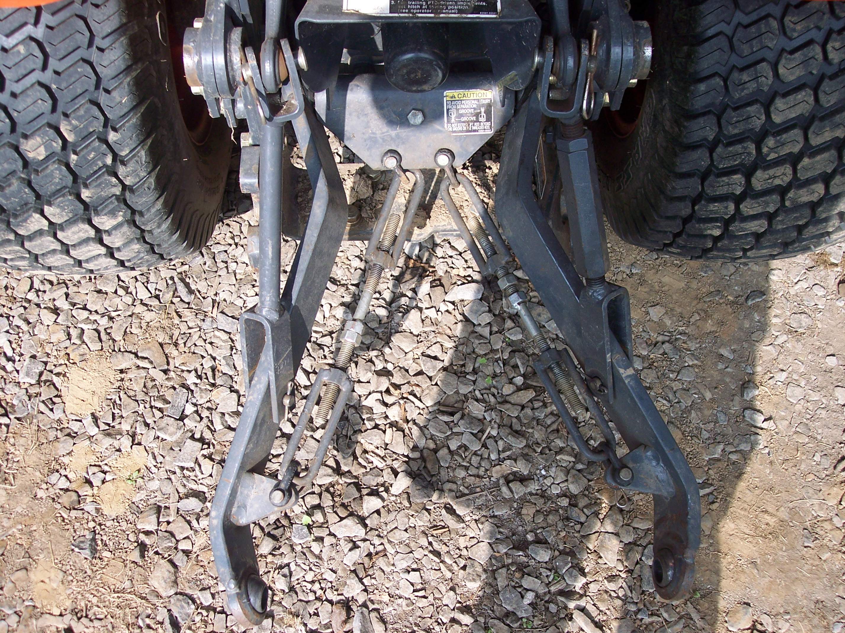

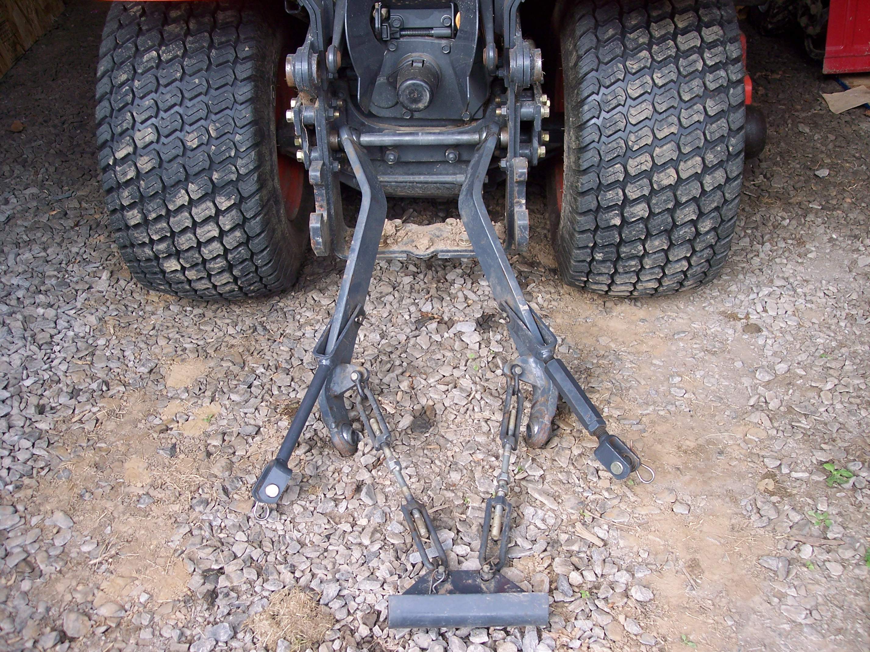

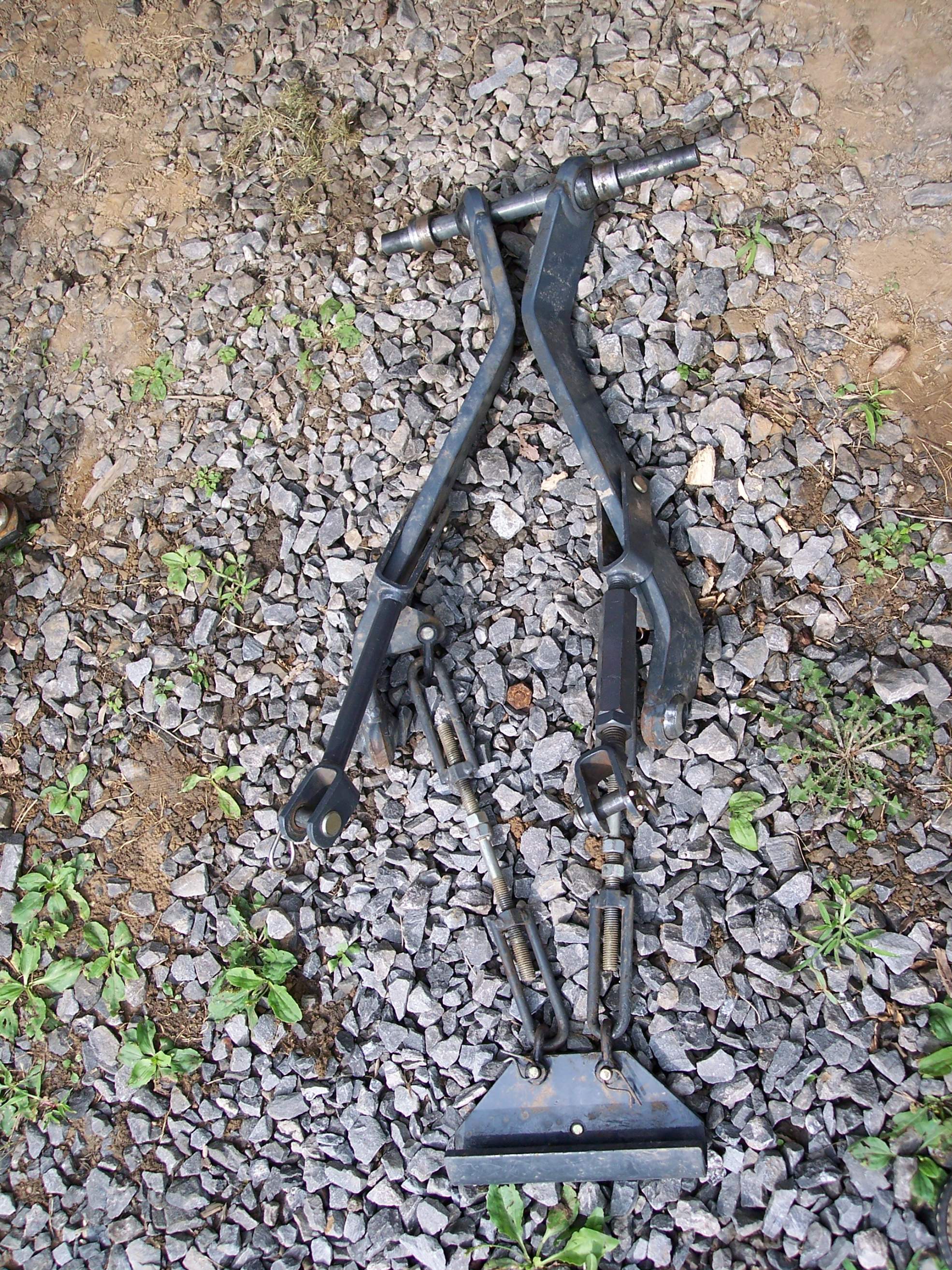

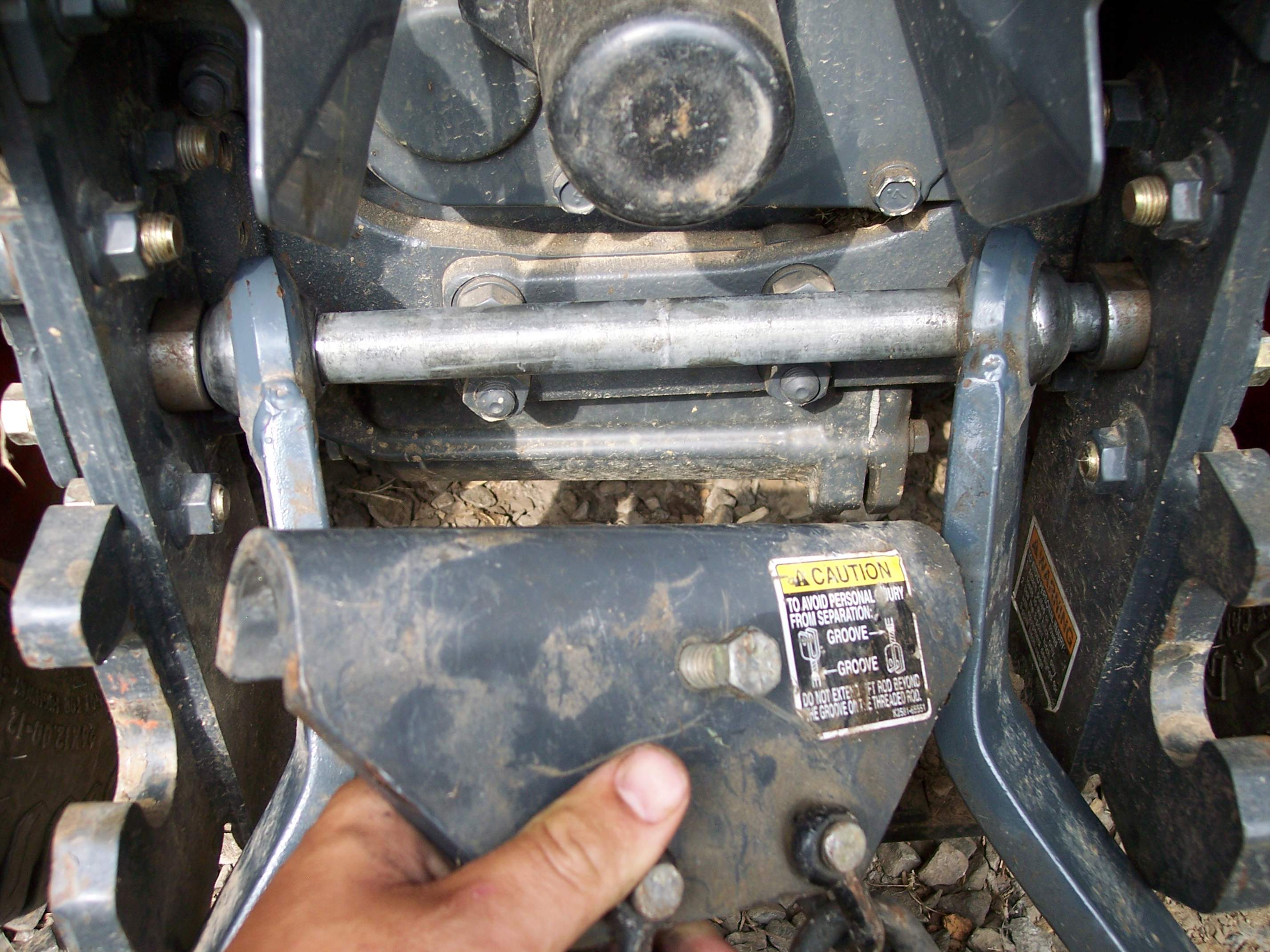

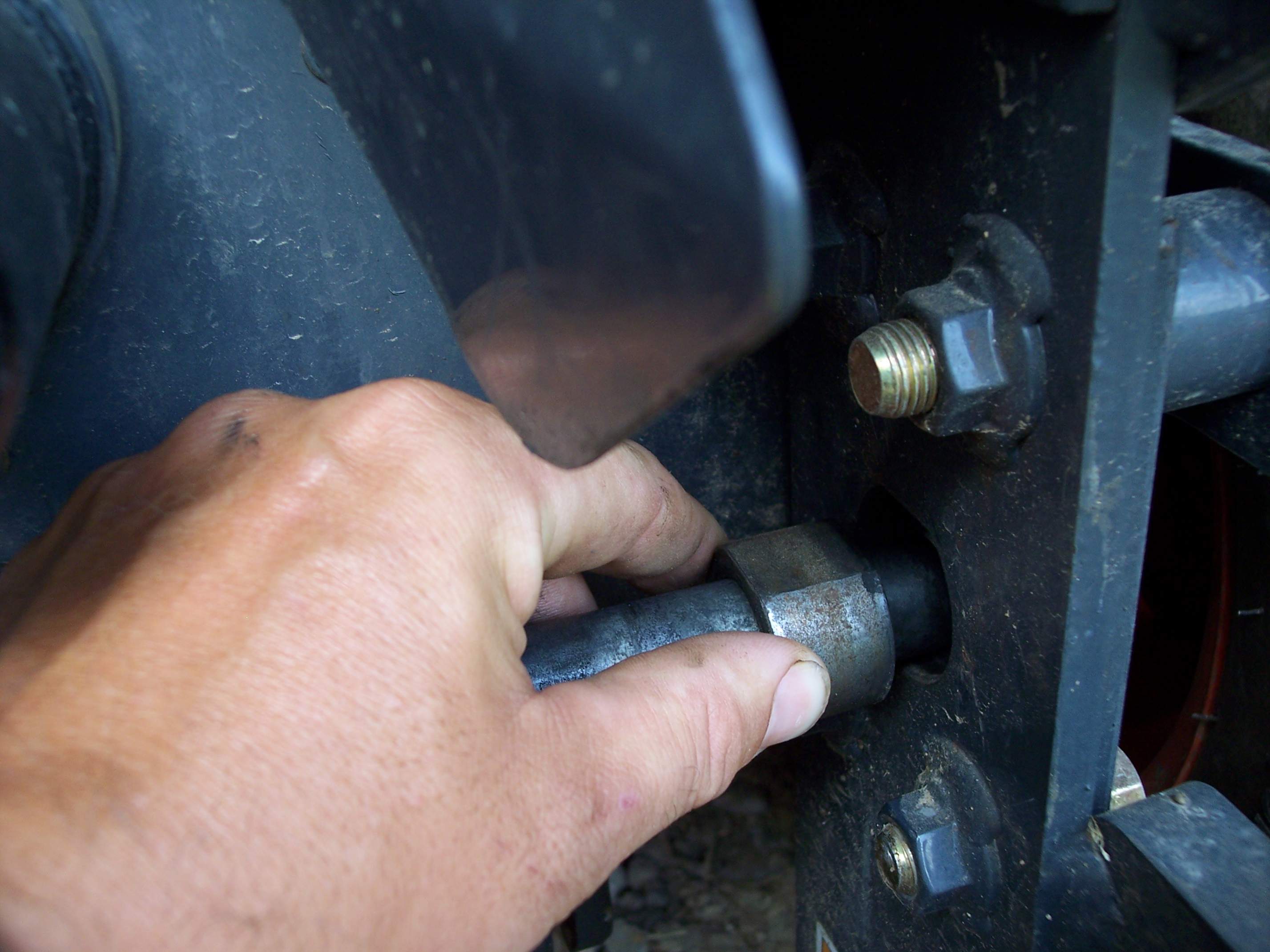

I forgot to add the 3 pt pics to help you to look at how it should look like when installed. I was fornuate enough to have my dealer help me put it together when he dropped mine off since I wanted ot test the rototiller I got the same day.
I suggest that you lay out the pieces like I did, and pull up to the tractor and install the crossbar and install the busings. then the j plate. keep in mind that I modified mine, I tapped my hole to use a regular bolt. Yours will be a bushing bolt with with no threads and its installed from underneath and held in with a small clip. Once the plate is in, then you can attach the side arms on both side and you are ready to go.
